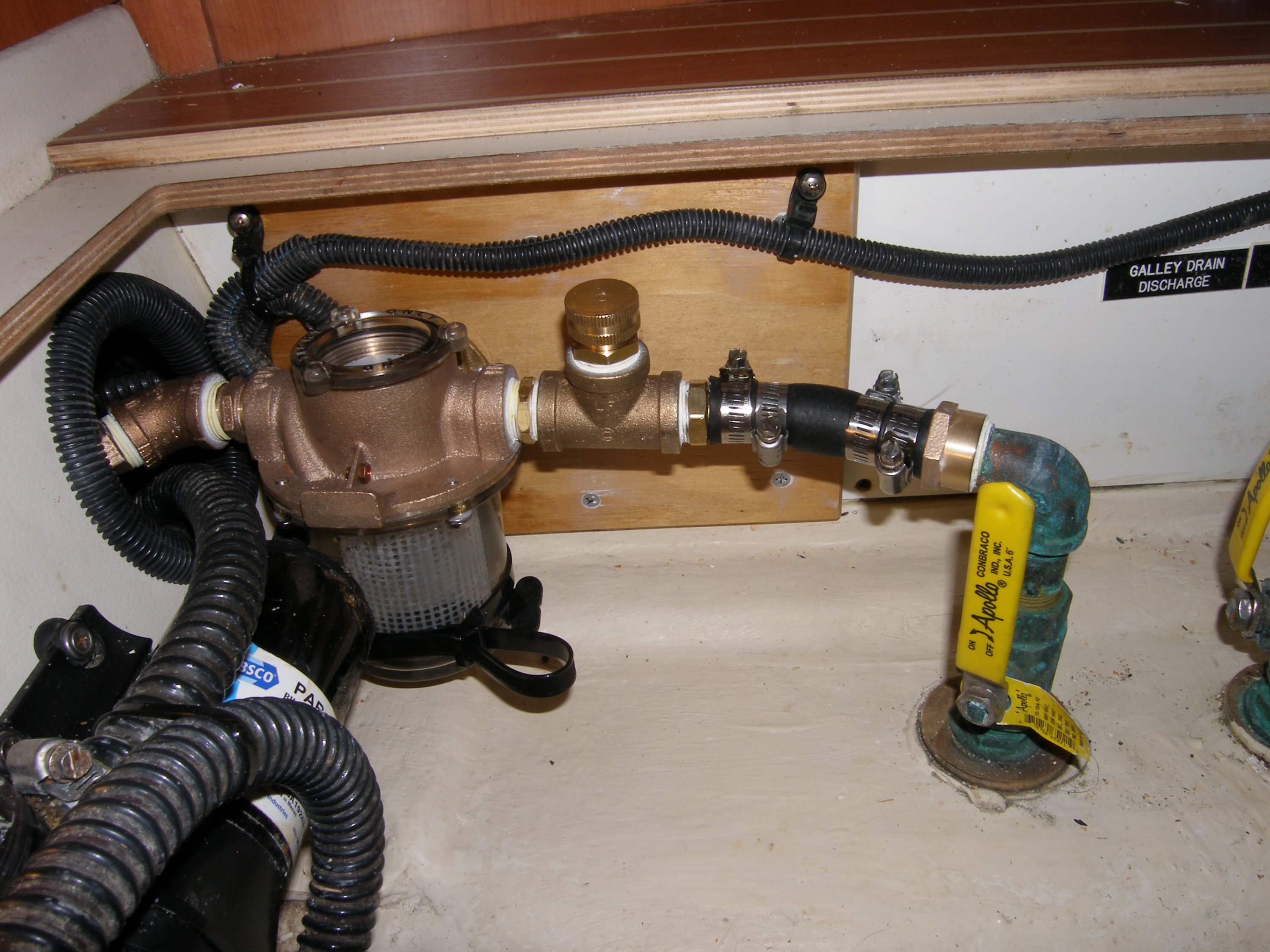

Seadaddler,
I guess the water pump mounted behind the thru hulls is for the shower sump? Did you take the original shower sump box out?
Were the backing plates difficult to remove and replace? Did you just remove the plates and clean around and leave the thru hull in place for the 4 you did not replace?

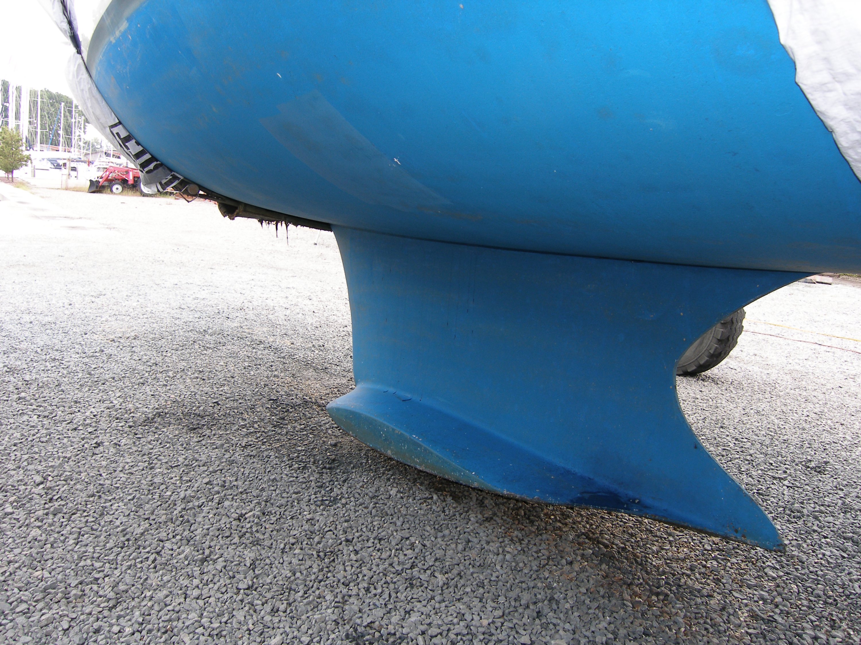

Your keel and bottom work looks very good, unfortunately I need to do the same on my 356.

I think the 36 came with the diaphragm pump you see and its connected straight to the shower pan drain...no sump, then to an overboard discharge like a bilge line. That pump can run dry for hours and still work fine. I have "testing" to prove it...ha.
Also consider upgrading the water strainers if you have them. The h36 came with plastic strainers. I only have three seacocks, sink drain, engine and AC. In addition to those three, I guess seadadler has saltwater head, generator. But I cant figure what the sixth one would be.

Sand and new bottom paint and changed 2 thru hulls and replaced all the backing plates.
I'm a little surprised my keel is slightly different than yours. I mistakenly thought major features like that didn't change within the years the model was built. Hmmm

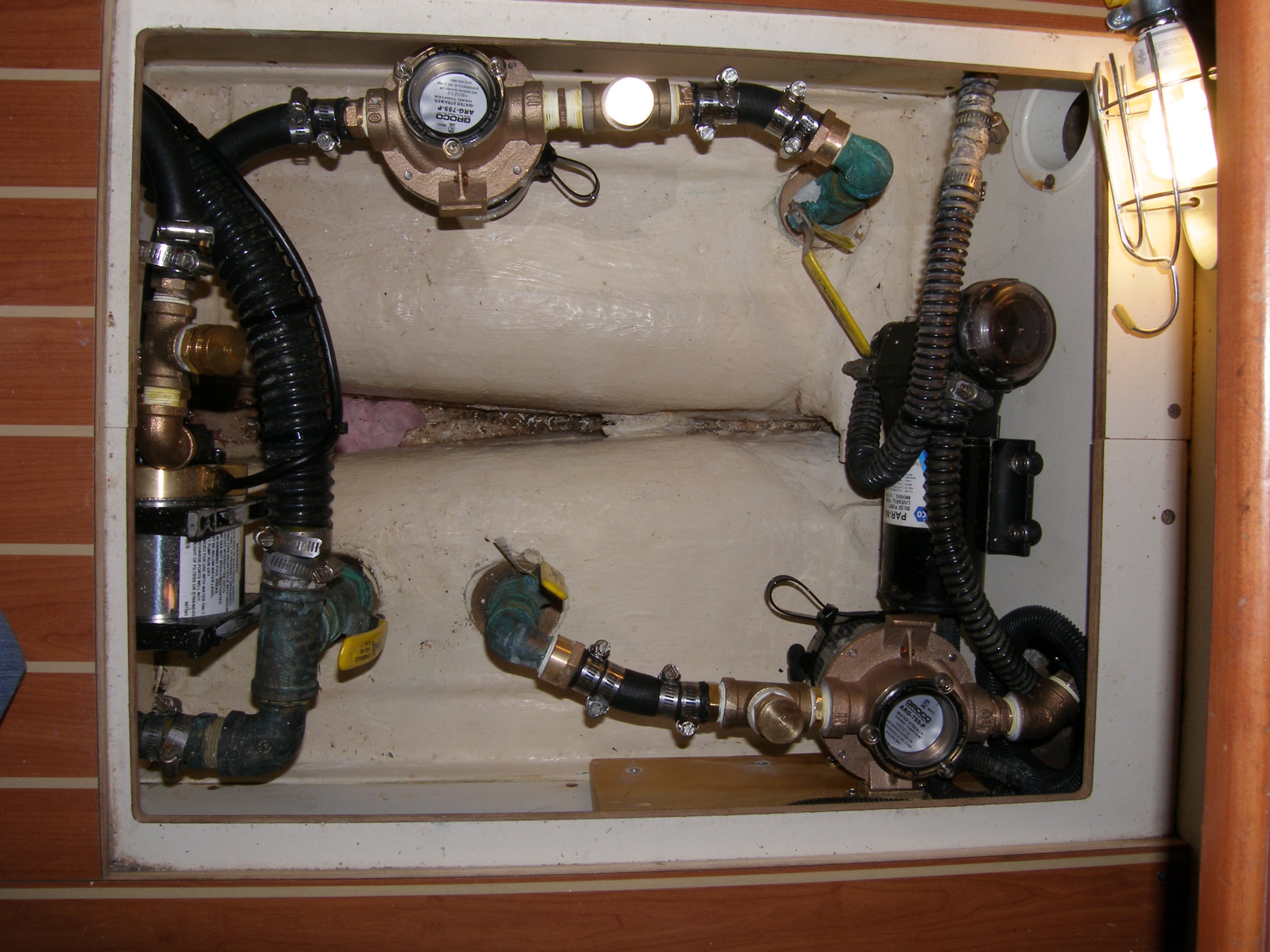

Nick,
I have a total of 8 thru hulls with 6 right in front of the companion way steps. On port side the generator, head pickup and head sink discharge. On starboard the engine, A/C pickup and galley discharge. The sump box has the shower discharge and I want to plumb the A/C drip pan to it. In the bow is a wash down raw water pickup and in the stern the macerator discharge.
The 3 strainers could be beefier, but they do the job. Past year had eel grass clog up engine and generator strainers so I check them often.

No sump box was used in 2007 on my H-36 and most of the thru hulls were not needed to reseal but some when removing nut did move but if you have some one outside use tool to hold the bottom part from moving but mine all needed the use tool to hold from turning and one even needed to be cut out and replaced,they will want to turn if you try removing the nut off and replace backing plates and the plates remove very easy.
