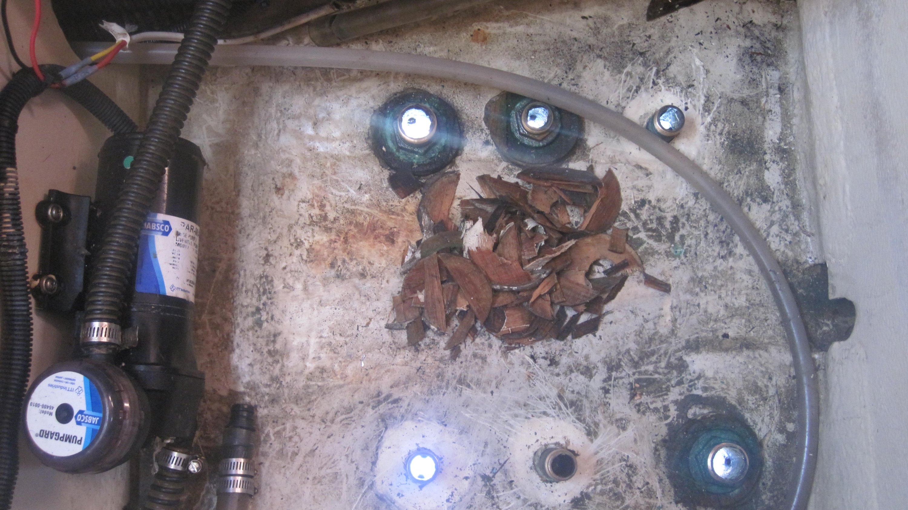

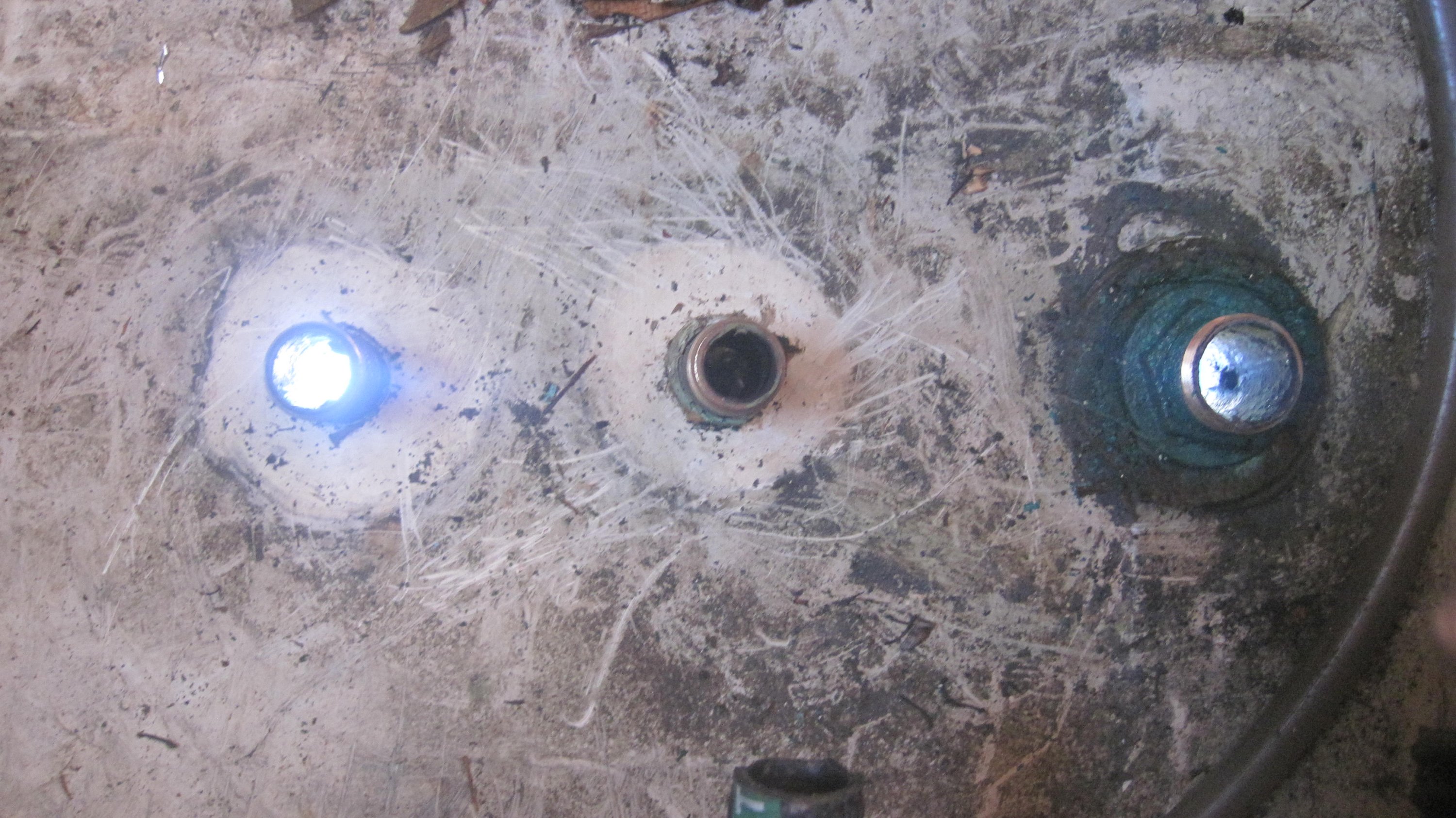

Marine plywood sealed with fibgerglass expoxy and the thru hull nut holds them in place
