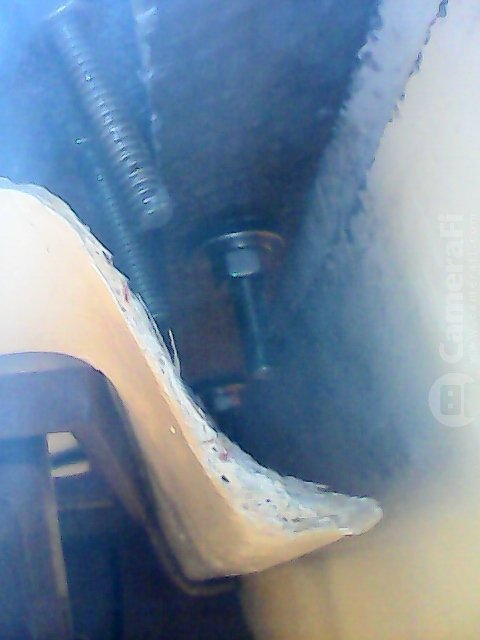

Tightened all the toe rail bolts I could reasonably get at. and still have several drips. There are still quite a few that I can't get at Unless. I cut away a portion of the cabin headliner where it turns down to form a valance over the bolts. The plan is to make the cut on the horizontal about 1 1/2" before it turns down to form the valance. I figure this should give me relatively easy access to all of the bolts. Only question now, is this portion of the headliner a structural element, or is it mostly cosmetic, will removing this valance seriously compromise the integrity of the headliner
Jan 24, 2009
451
1981 Cherubini Hunter 27 Shipwright Harbor Marina, MD
Here's a side view from my borescope of the lip on the headliner in the galley area, these were the ones I really had trouble reaching. If I remember correctly, I carefully cut off the foot of the "L" or"J" that gets in the way with an oscillating saw to give me more room to reach them. I think I did it at a slight upward angle to help hide it. The PO installed a paper towel holder there, which helps hide it (it was removed for the side view photo & to do the work). Sorry, I don't have an "after" photo.
