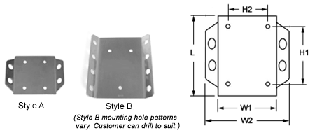

It is really one a rocket science project. You will need to bring the lines down to the bottom of the mast. Install some blocks to turn the line direction towards the cockpit. Often folks install a Halyard Organizer Plate at the base of their mast. Something like this.
It allows them to attache a turning block to take the line from the mast and turn it towards the cockpit.

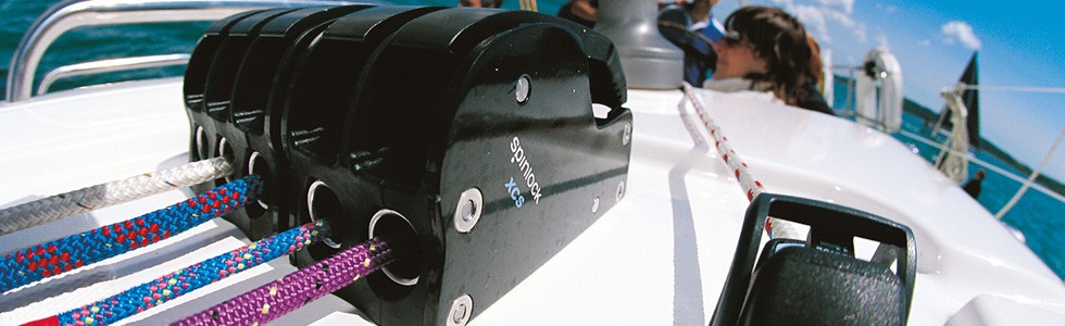

You can then run the lines through a clutch to hold the line in place.

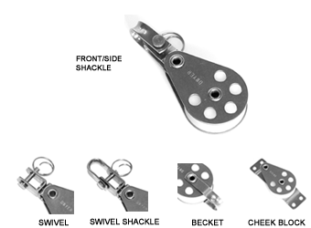

(a) base plate and mast blocks
(b) stand up swivel block
(c) halyard lift block
HINT.... choice 3 is the least expensive.

If you use a stopper, the device to the right of the cam cleat in Joe's post, you don't need a self tailing winch. In fact when you have one winch servicing several lines the best practice is to keep the winch free of lines and available for use.
Be careful to lay out the runs to make sure that they run fair and that lines don't chafe on any block cheeks. This can be multiple dimensional and sometimes shims are necessary under some of the hardware. The run from a stopper with multiple lines to a winch aft of the stopper can only run fair for one line. The others will be slightly out of alignment. Make them occasional use lines if possible or use a bollard to turn them. The closer the winch is to the stopper the more of a problem this can be.
