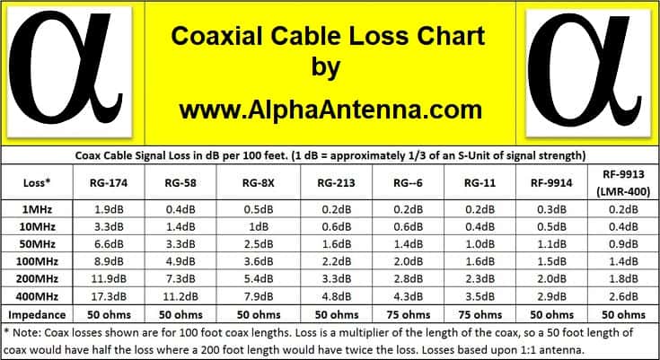

A coupler in your coax (RG213?) represent about a 1db loss. That's not much considering 100ft of RG213 losses 2.6 db. If you have the cheaper RG58, you've already got 7db loss in 100ft. Your coax is the big db loss, not a coupler at the mast base. Line of sight and corrosion at the antenna connector is usually the LIMFAC for a sailboat's antenna system.

As I recall the VHF cable is something like RG213, I remember it was about the size of my thumb and very stiff and the losses were way down compared to anything else and price was inversely proportional. It took a while to get it right because I can’t deal with heights, so doing the top end was task for someone else and I literally had to train the tech, show him on SWR Meter show him water ingress etc. The cell phone was the same deal and getting those connectors given there size is smaller than the cable, yep that to was a challenge, but it gave me 80k coverage on cell tower, and there is cisco wifi aerial(s) up on the spreaders. The radar is old, so might in fact dump it for a new Ethernet version if I’m forced to take the mast down. Most riggers don’t have a clue about the rig either, which is frustrating, it took nearly 3 years to get it anywhere near right. Even when the boat was delivered new it was wrong and riggers want to run when you tell them , it has prebend and furling main and no backstay, most didn’t know what a lose gauge was, then comes the mandrel for the in mast furller….. ah it just goes on. Actually this is not just about cost saving, because potentially it will be the same, but its about doing the whole job right and once. I used a Filipino in Philippines to do the diagonals. I explained do exactly what I say, take the measurements pictures I ask for and you will be paid 1 month salary for what should take 1 day. It took two days, but he did exactly that. Prebend, rake and tension was great and that’s two people one whom follows instructions and one whom thinks he knows but proves my measurement (me). I real professional should have no drama.

If your focus is low loss coax - strongest signal output, LMR400 cable should be considered.
Ah yes seeing your cable chart John has reminded me the VHF one was LMR400, can remember what the cell one was

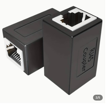

I don't know which radar you're referring to but the Raymarine RD148D on my 2007 41AC uses ordinary Cat-5 Ethernet cable plus power/ground. The radar was put in by a previous owner and the installation has a terminal block for the power/ground below the mast base (above the forward cabin ceiling) and there is also an RJ-45 coupler (similar to the one in the attached photo) for the Ethernet. If installed correctly such a coupler does not interfere with the Ethernet traffic in any way.

Yea I was in IT, so what you're talking about is an Ethernet/digital radar, these can be joined because the signal is basically a digital or a computer network signal. It use between 4 and 6 wires and they can be cut and joined many ways. The connector you show if its not gold leafs, and some arent, then it will fail and be hard to find. If its gold leaf, it should last fine. That Radar you have would not have been standard. My hunter is 2008 so it has an analog RD424 which uses a cable like this Raymarine/Raytheon ANALOG RADAR CABLE - 14METERS f/M92652 92652-S RD424 - Max Marine Electronics If you zoom in on the picture your will see an eight-way connector in addition to the other 4 bigger wires. So total of 12. That in itself is not a problem,. However one of those thin wires you see which are about the size of a match is a coaxle analog data signal carries two wires one center core in a shield. So these wires are about 1/2 the size of a match including the covering. That signal is much lower than your Ethernet digital Data signal, which is why they shield it. These cables are made up to about 25m, no one will be cutting these and joining them. The cable would need to be diconnected from the radar, whihc of course can be done, along with the cell phone aerail at the top of the mast. The VHF one can be cut and have connectors, but thats not ideal either. Lights are already on a terminal block so no problem there. Windex is not but it could be. Now of course my doubled ended main sheet needs to be removed, my endless !! furling line needs to be cut, then respliced, topping lift, vang. halyards, HF aerial, mainsail, jib, etc etc. Yea quite honestly that is madness unless you know you have Maijor issues on the mast somewhere. Excluding a large swell from some big cruiser, or gails, I would almost bet that you could take of any one piece of wire (excluding the forestay) and the mast would stay standing. Even if you took a capshroud off, the D1 (half way down) would hold it up. Clearly you would not rely in that but masts tend to break around the first cross tree or above and boom goseneck. I have yet to find one example of a mast coming down as a result of doing it in place, one at a time. I'm sure its probably happened because their supporting lines came lose or they took them all off at once and tried to support it with lines.
