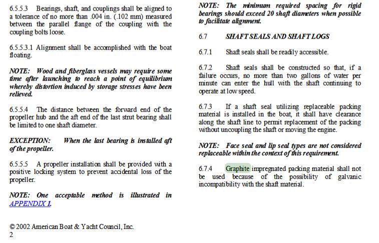

I would have to agree with Charles here in that without knowing the composition of the bronze shaft, you are opening yourself up to a world of galvanic corrosion. As stated in the ABYC P6.7.4 ........................
This is intended to cover the most corrosion prone materials. Once you get into the hi-chrome SS's such as Aquamet, graphite is not a worry. I would recommend teflon impregnated flax and remove any worry about galvanic corrosion.
