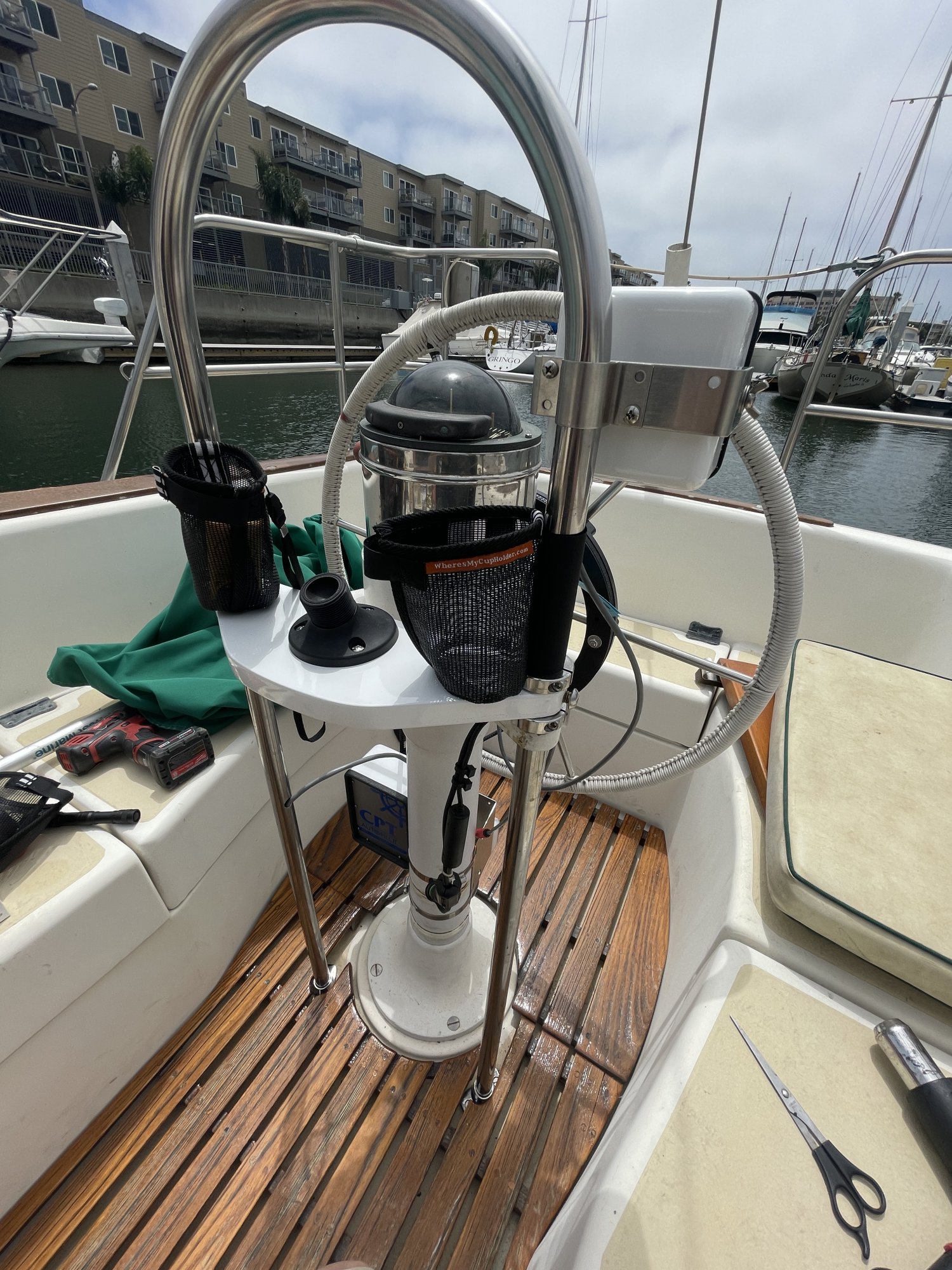

Ha! sorry. I dont like to resurrect old posts but somehow came across this one from last year. I had just finished wiring mine so caught my attention.
I guess it depends on the setup and how well its done. Yeah i can imagine on some boats its a pain but on a standard pedestal its a very neat and organized setup. Here is a pic of mine (back view). The drive unit is tucked off down on the bottom of the pedestal and sits within the confines of the wheel and the binnacle support bar. Wiring still looks a little messy in the pic. I have since tidied that up. I did some sea trials on tuesday and it was never in the way. It doesnt stick out at all and sits resonably high off the floor so it doesnt get kicked. The control head is also pretty small. It looks big in the picture but clamps neatly off to the side of the binnacle support bar. I only had to drill two holes in the stainless support bar to run the wires down through the cockpit floor.

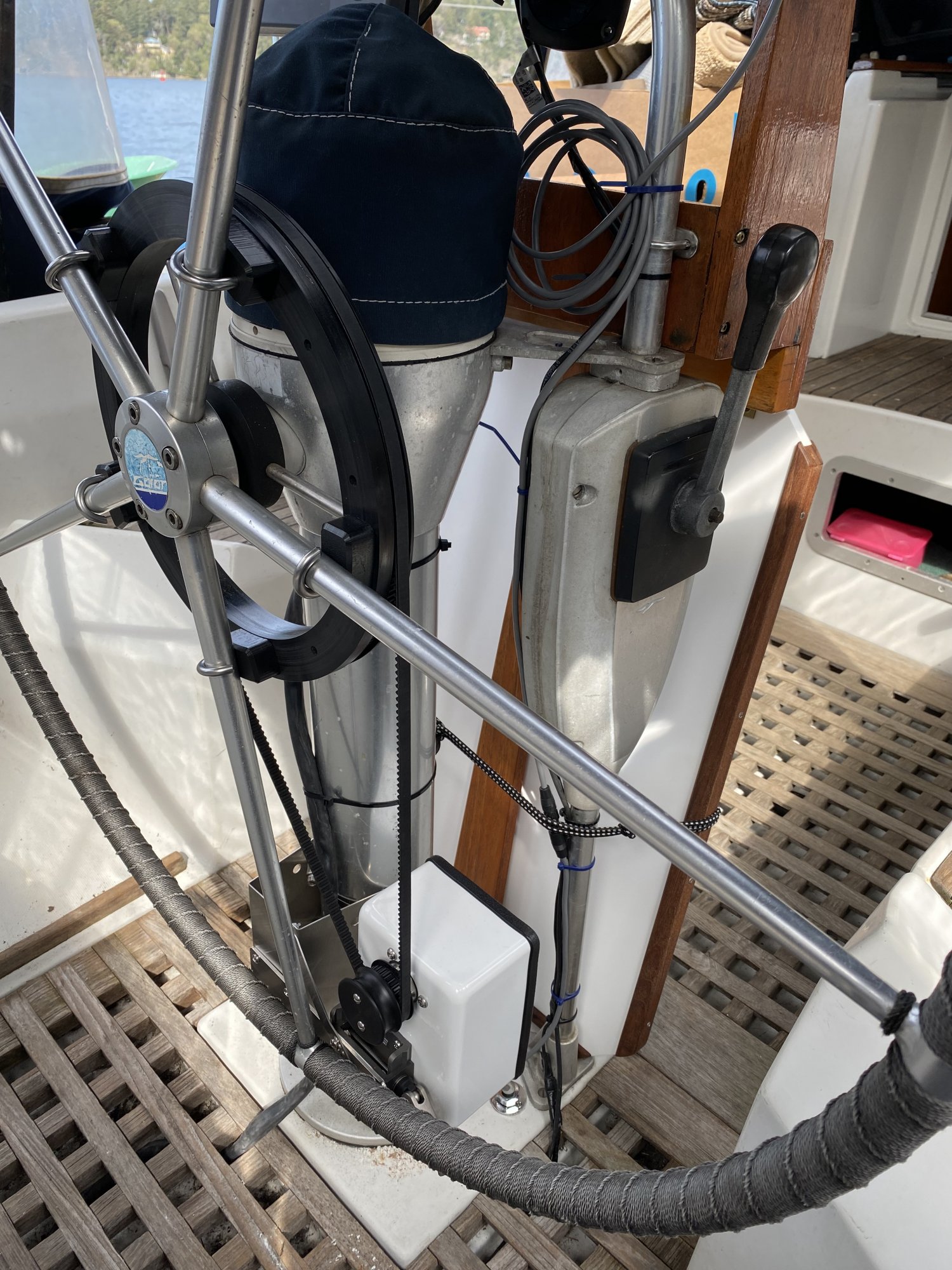

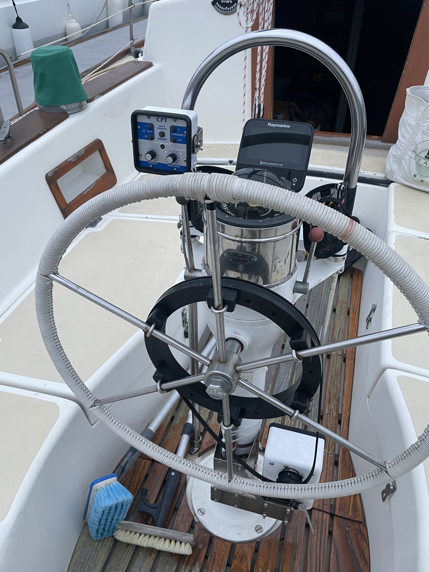

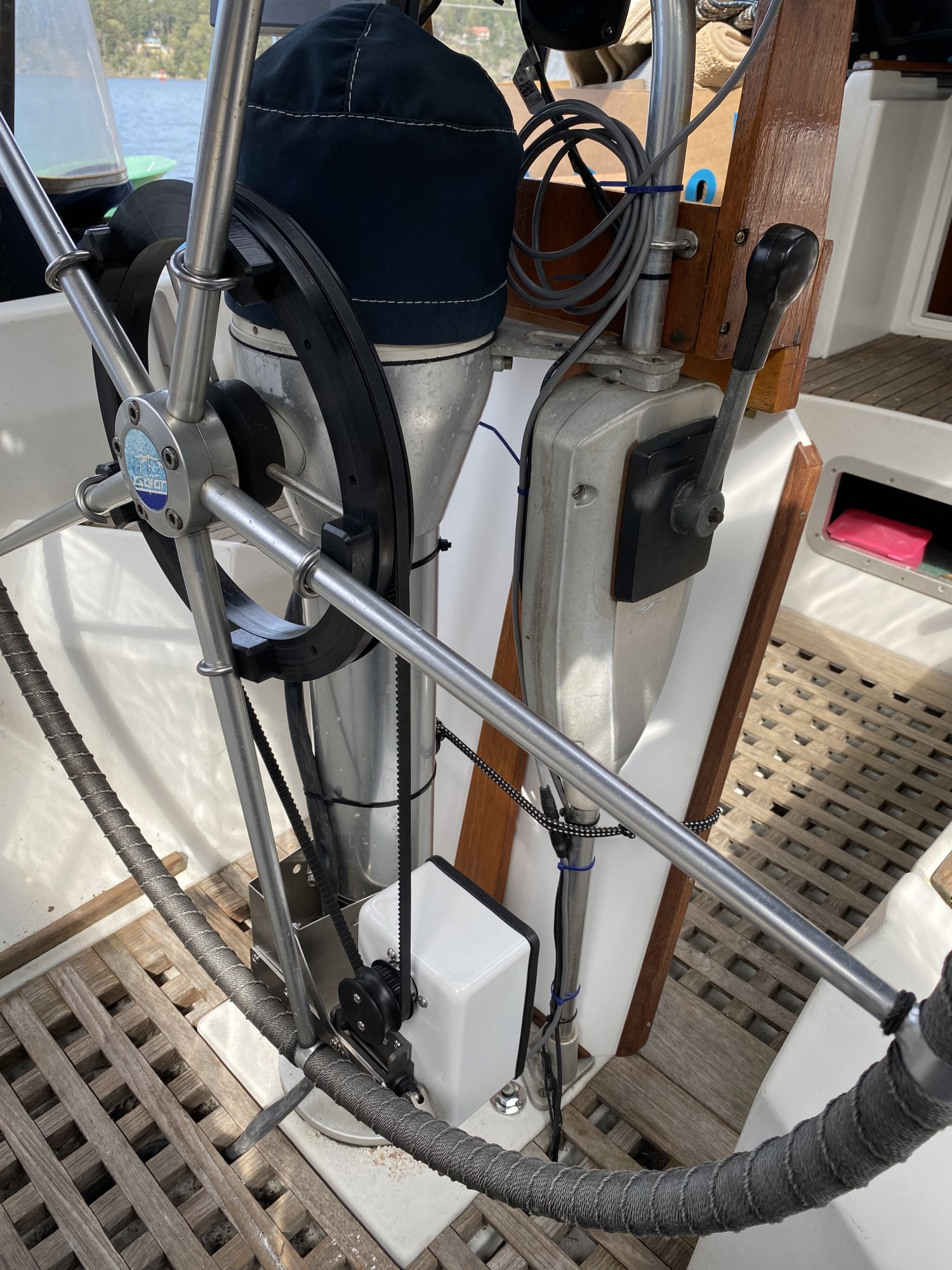

Your installation is very similar to mine, however I have a 42 inch wheel and a binical hung table so it would be almost impossible to stick anything into the belt by accident.View attachment 227452 Great addition to any boat.
Oh nice. Yup pretty much exact same setup. My wheel is pretty small. I forget, maybe 32" so easy to get around the pedestal without bumping the control head. IMG_2652[1].JPG I kind of like the old school look of the CPT :p. Got some fair weather this weekend so will be nice to get final sea trials done and get it dialed in so i can go out in the bay by myself when no one is around to go sailing.

How easy / hard is it to remove the wheel when you need some room in the cockpit for guests while in a slip or at anchor?
Thanks
Nov 6, 2020
552
Mariner 36 California
Thanks
Very simple. The CPT drive unit has a quick release lever. You can see in the pic i have my belt loose. All you would have to do is release the tension on the belt with the quick release, remove the steering wheel nut and slide it off as usual. The drive wheel for the CPT mounts to the wheel spokes only so does not interrfere and the belt just pops off once the tension is released.
