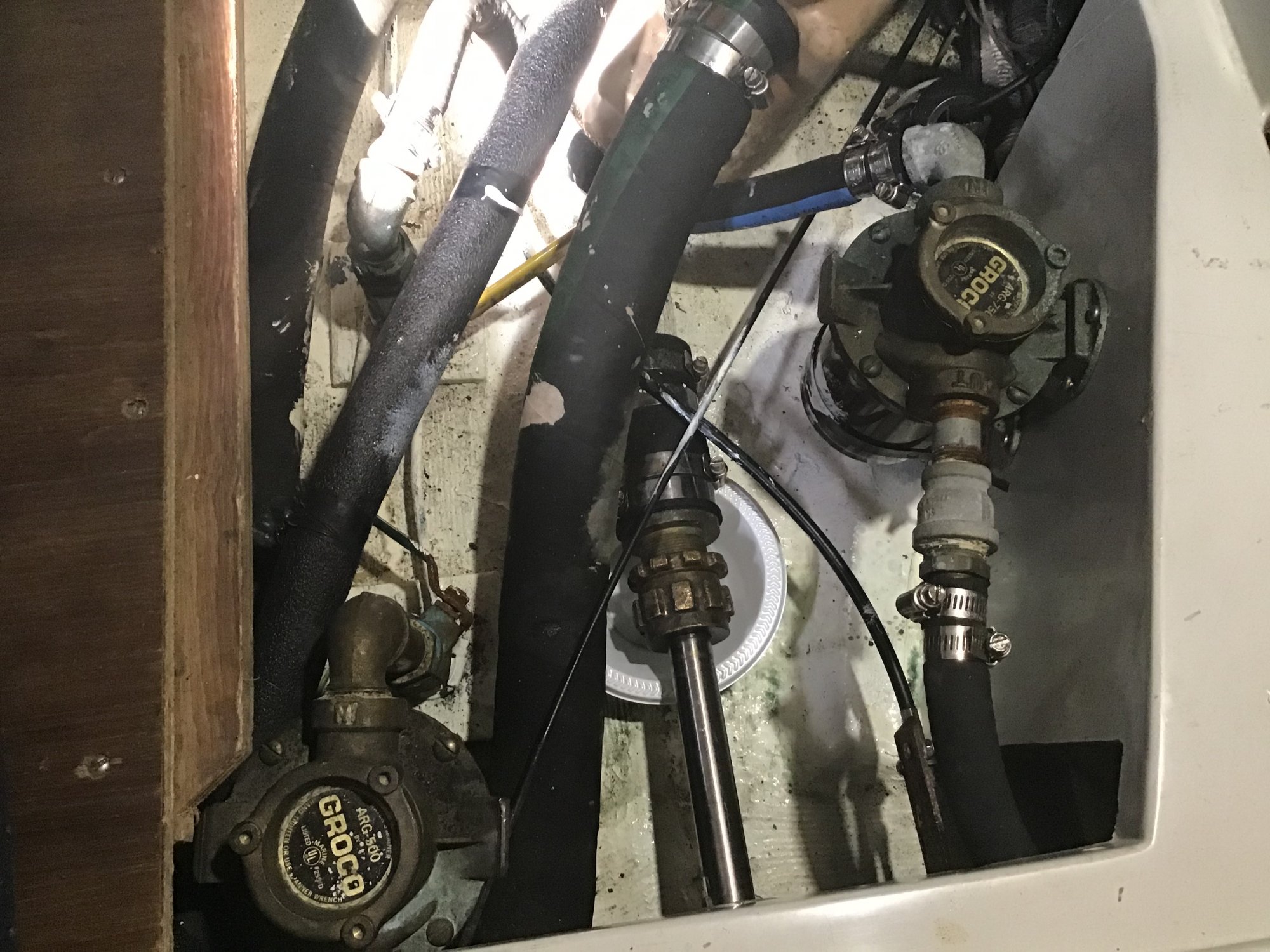

My 1988 O’Day 322 has a Groco strainer between the thru-hull and the water pump. Located near the stern tube.

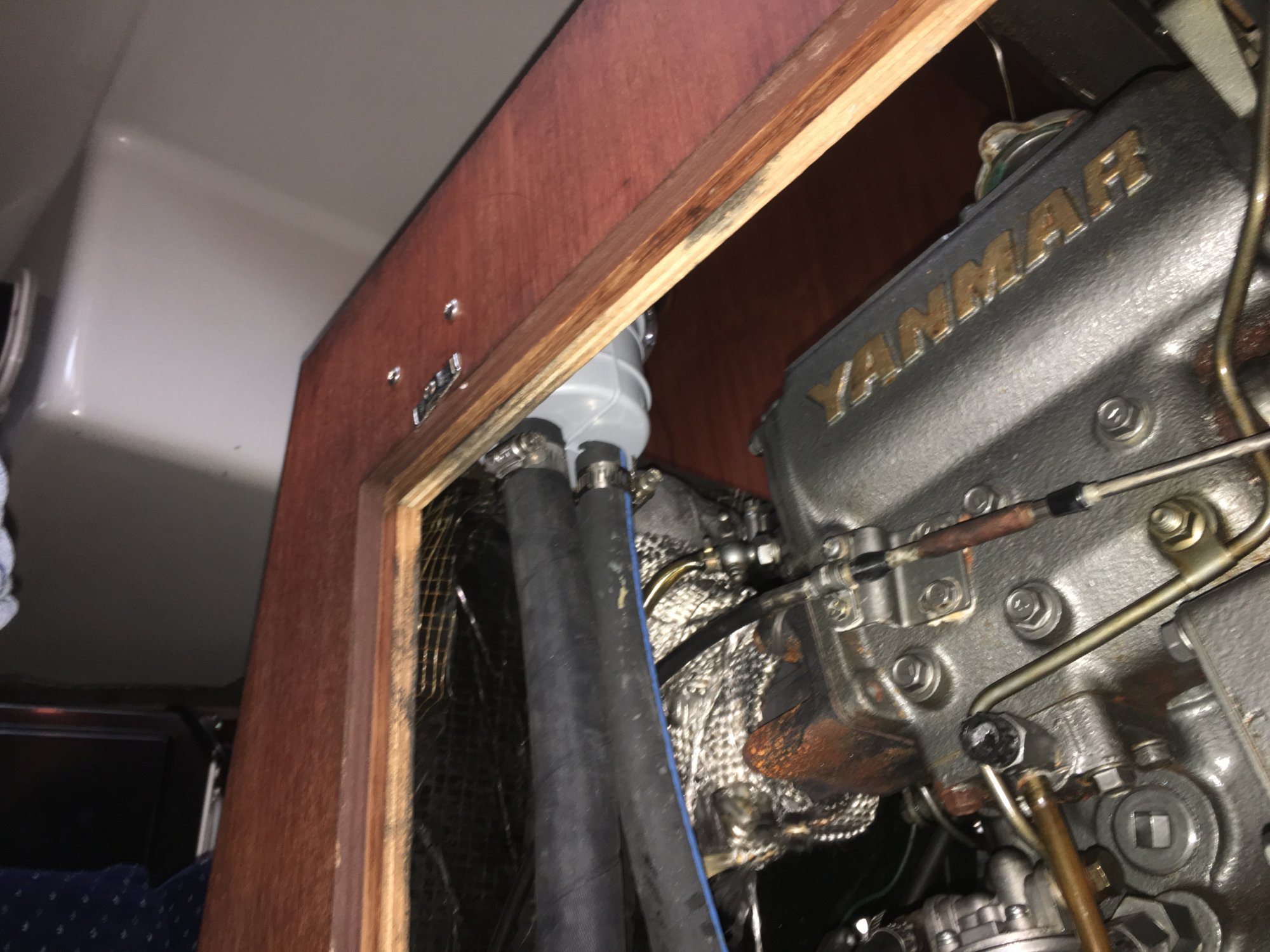

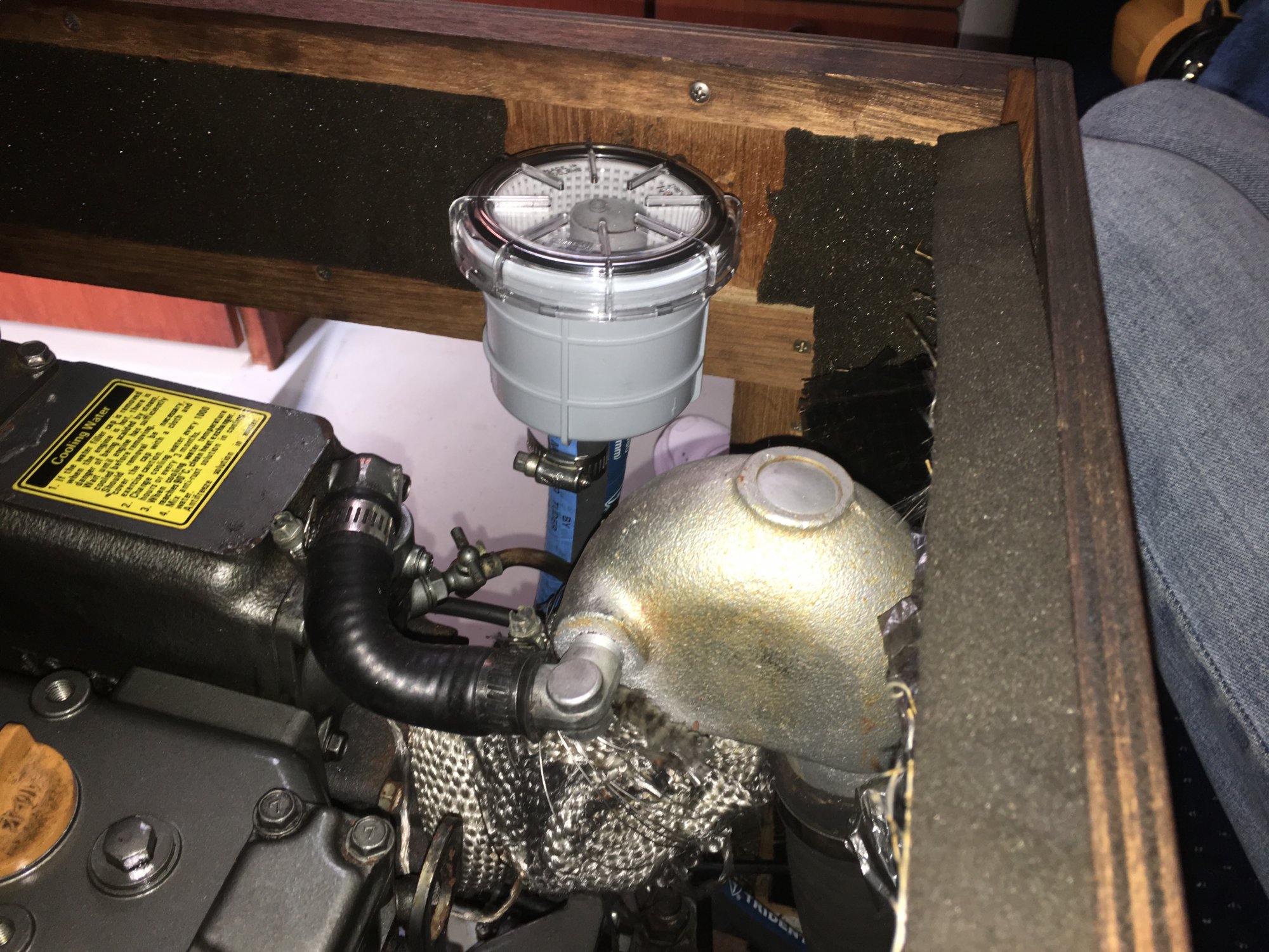

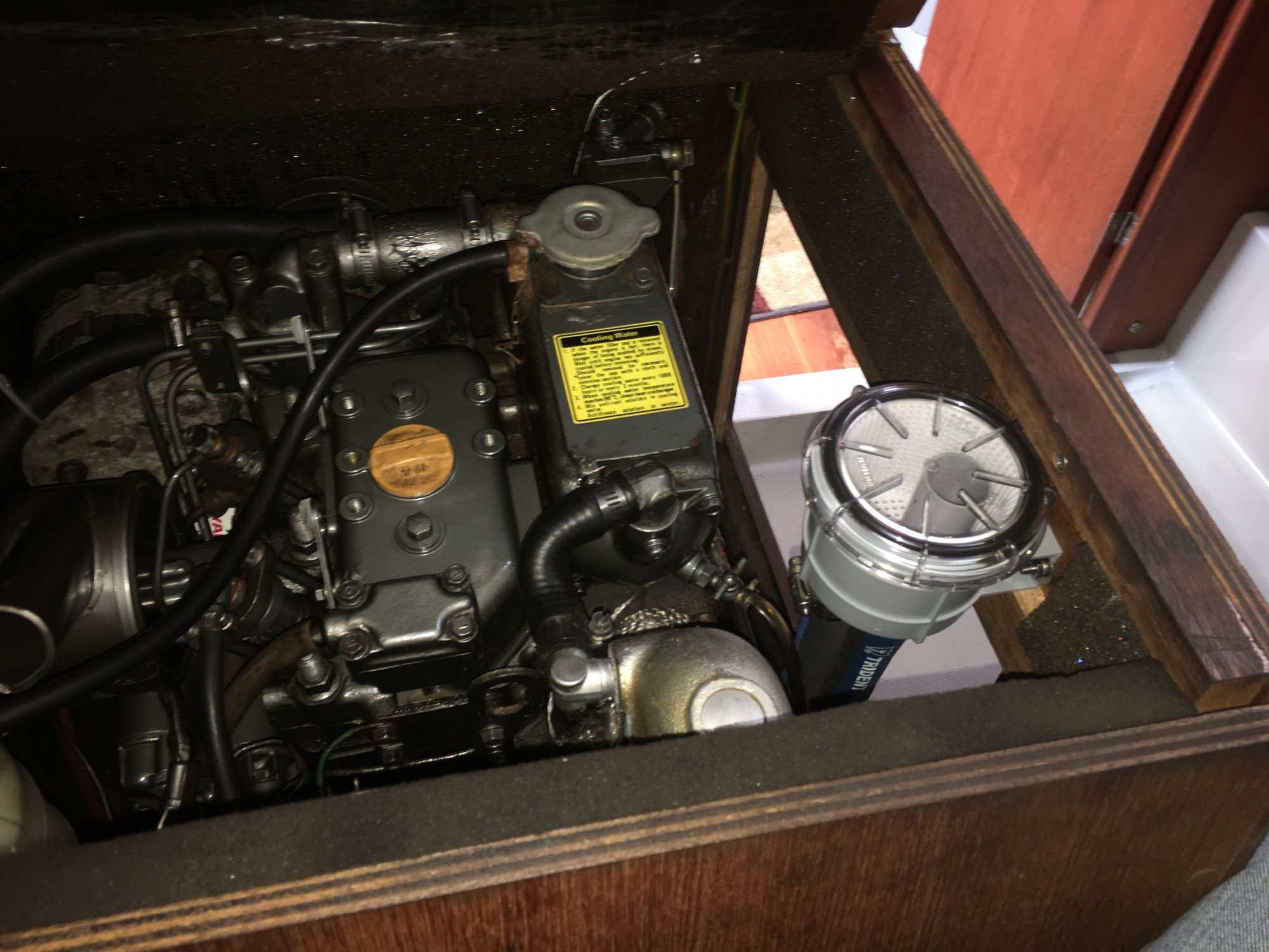

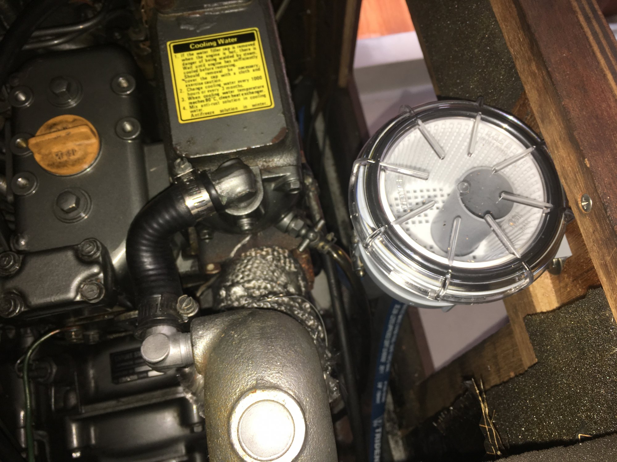

Your boat likely does not have one. My O'Day 322 went 30 years without one, apparently.
I liked the Vetus strainer some of the new boats I deliver have installed, so I installed one for my own boat a year or two ago. Very easy to check and clean out. See pictures.

AndreNJ11, thank you for those very clear pictures. You are an inspiration to keep the engine clean in my 302.

Oday 322 East Chicago, IN
The Groco on the right is for the head, and the one on the lower left is for the engine strainer…
