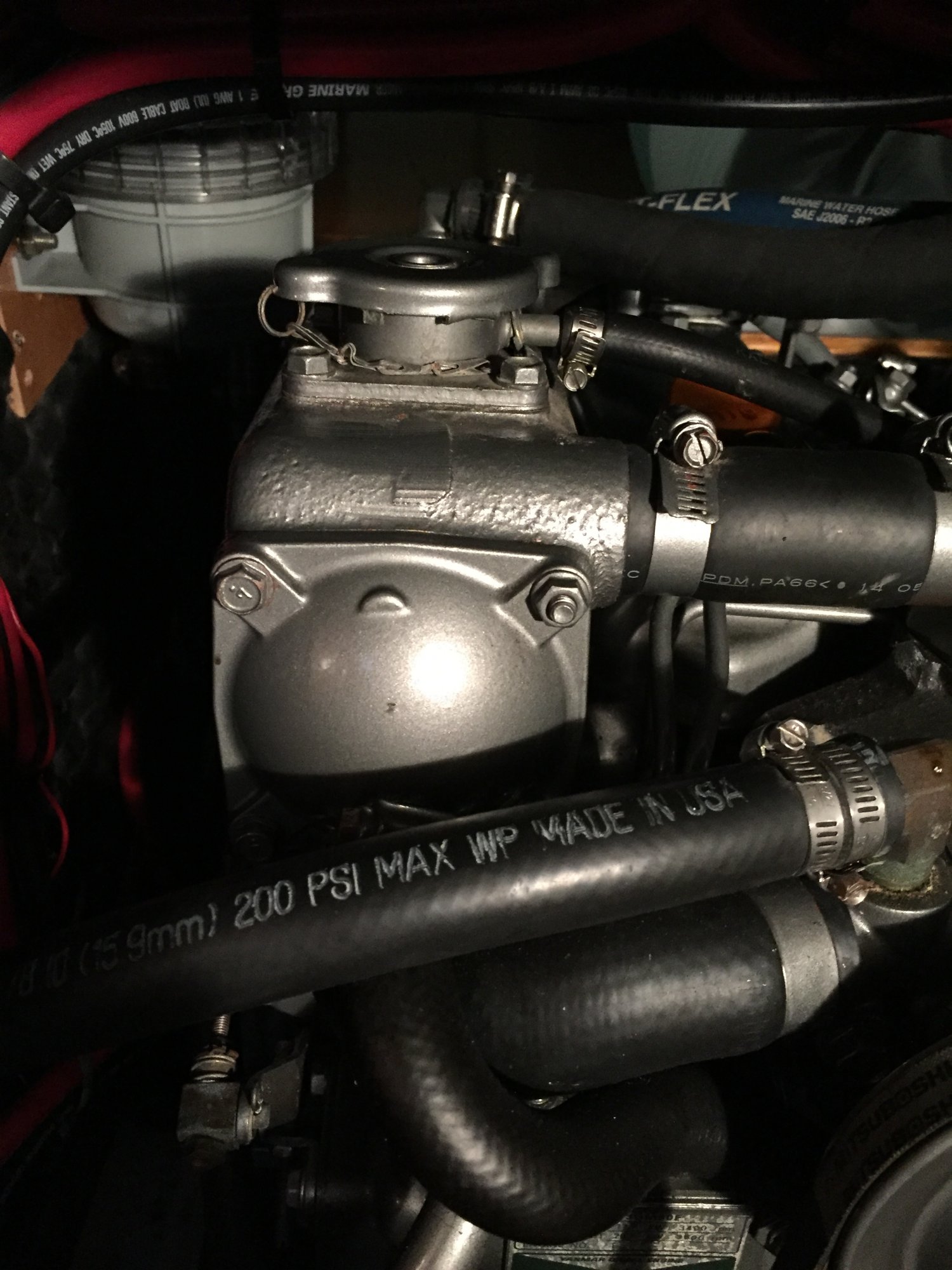

I was warned by an experienced marine diesel mechanic that plastic strainers inside the engine compartment are risky because they get brittle with age and the engine heat greatly accelerates that process.
Getting it outside the engine compartment, away from engine heat and above static waterline is a good compromise. I actually considered that option with a plastic strainer, but inside the engine compartment provided the best access in my boat, so I went with bronze.

I would think that the water flowing through the strainer with the engine running would keep a plastic strainer cool enough to prevent damage.

Our 2003 Beneteau 331 had a Vetus strainer. The housing is rated for any normal temperatures in the engine compartment. The attached picture shows the location of the strainer in the Yanmar 3GM30F engine compartment. This picture was taken in 2019 at 1500 hrs. Strainer was like new. When we purchased our Hunter the plastic Sherwood filter was mounted in the bilge with a nipple directly to the thru hull. For me it was a priority to change it. I installed a Vetus FTR330 same set up as the Beneteau. No need for a loop as it is mounted slightly above the waterline. Makes it very easy (and dry to clean the strainer).
Make sure to use hoses rated for under the waterline and saltwater. Double marine grade SST hose clamps on the connections.
One caution with the Vetus. It has a large cap so you can get lots of torque on it. Be careful not to get it too tight or it will be very difficult to get off, with a risk of damage.
A bronze Groco would have been a good option as well but the inlet and outlet connections would require more fittings for my installation. I try to keep fittings to a minimum as each one is a potential leak point.

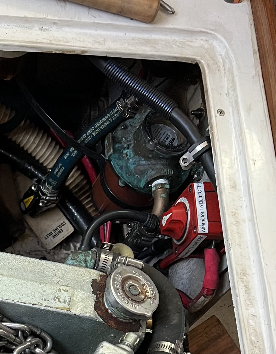

@Project_Mayhem Here is a photo showing where it is mounted on my boat. As @Hayden Watson mentioned, the water line is a few inches below the seat. As chance would have it, it's just at the in and out ports of the strainer.
I have my Vetus strainer mounted to port of the alternator and accessible from the hatch over the macerators thru-hull on my C30 Mk2.
That happens to be where I mounted the fuel filter.
