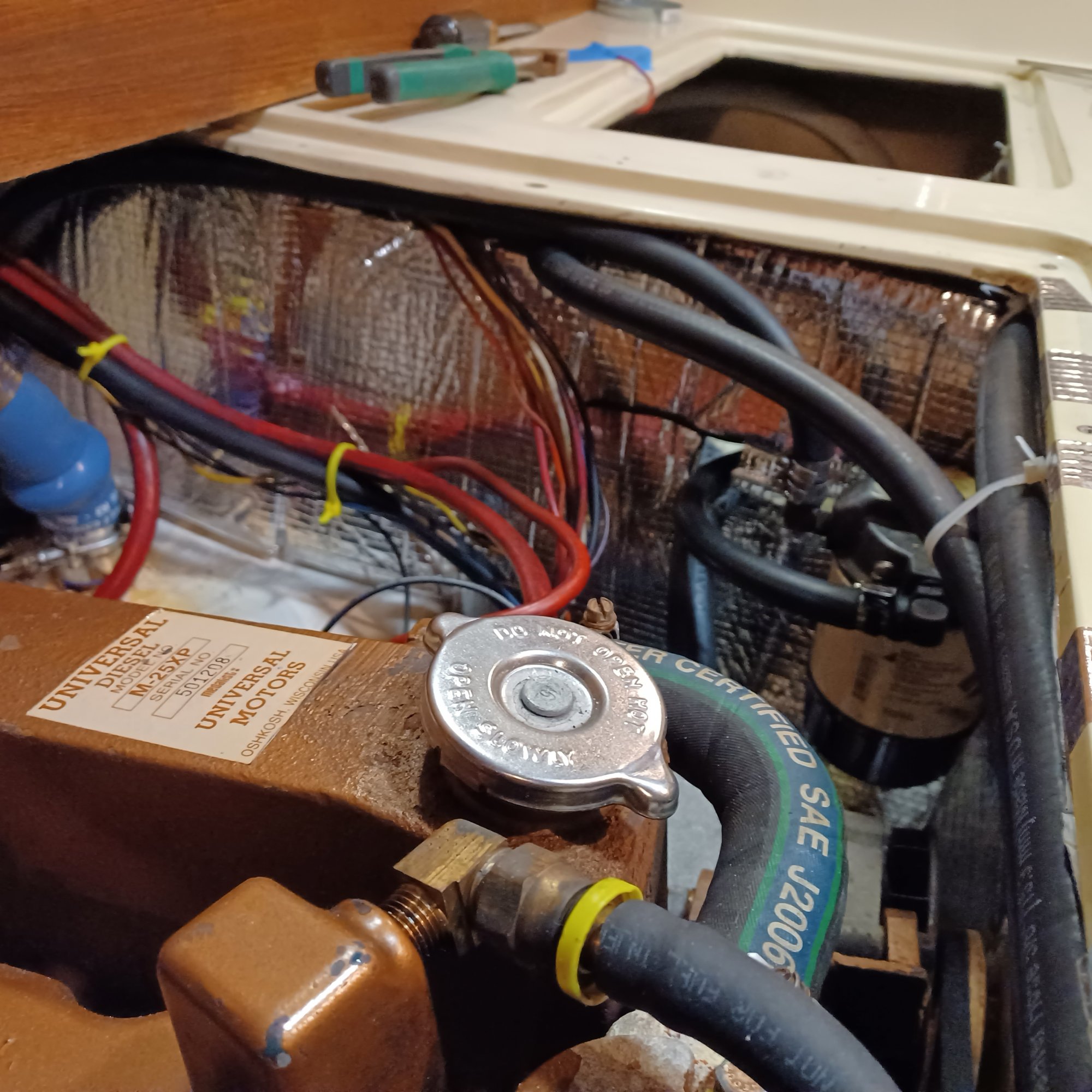

@Project_Mayhem Here is a photo showing where it is mounted on my boat. As @Hayden Watson mentioned, the water line is a few inches below the seat. As chance would have it, it's just at the in and out ports of the strainer.
That happens to be where I mounted the fuel filter.
Mine is just outboard of the fuel pump.
Originally, my fuel pump was where your strainer is, but I moved the pump closer to the engine and used the screw holes for the pump to mount the strainer. My thinking was that I would need to access the top of the strainer to clean it out and the small hatch is far easier to open than the top of the engine cover. The Racor is inside my sound insulation, the fuel pump is on the other side of it and the strainer is just beyond that.

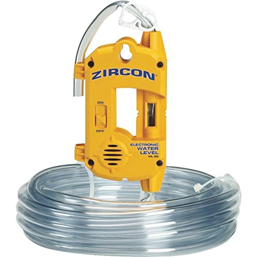

If I wanted to be sure about the height of the water in the boat, I would use a water level.
This is what a professional one looks like.
But you could accomplish the same results using a length of clear hose filled with water. Fille the hose full and cap the end so water does not escape. Position someone outside the boat with the hose end above the level of the water line (or bottom paint line).
Inside with the opening above the level of the water you cna move the hose about. The level of the water in the hose will reflect the level of the water marking the boat's water level from outside.
Old school but effective. Thank you Archimedes.
