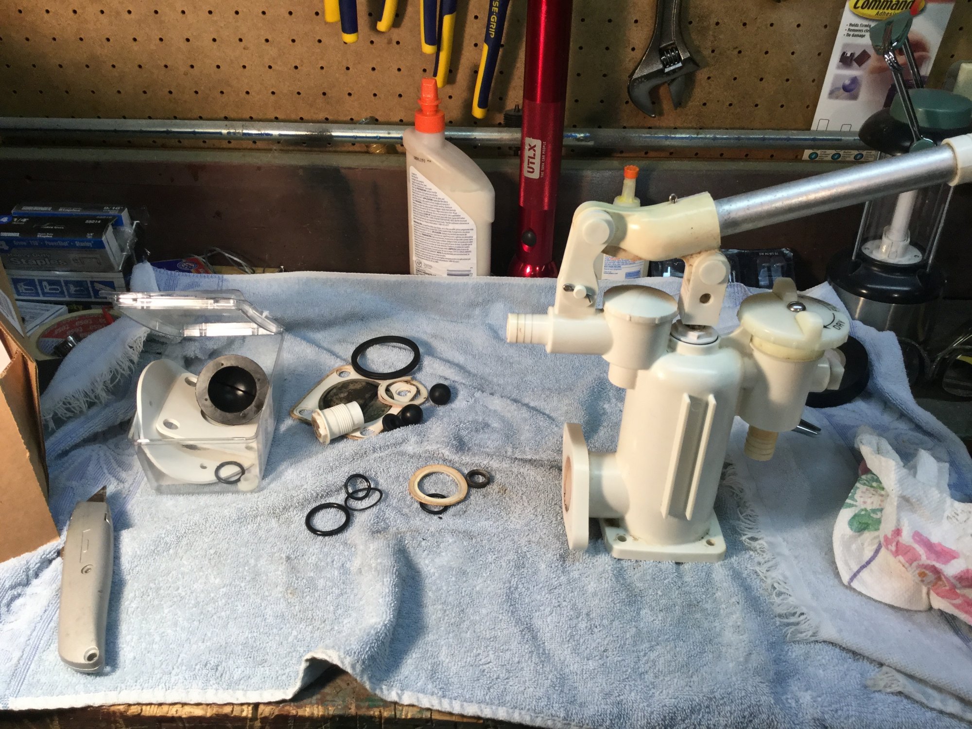

PHII Compact, manual pump:
After 10 years of above average usage since new, me on the boat about 3-4 days a week, in almost exclusively #1 mode (have shoreside head), I had to replace:
Pump housing. Cracked and leaking.
Complete base, broken off at one mount, and cracked further in which also was leaking.
Piston, multiple cracks and looking to fail.
Pump housing vent.
Joker valve of course.
Flapper valve, totally toast. I used a maint kit so replaced lots of other bits but only the joker and flapper really needed it.
Pump handle. The sleeve insert failed and allowed handle detachment while pumping.
Seat and lid. Both deteriorated and loosing paint. I painted sections of them last year but not that good. Also plastic hinge broke.
Total parts about $400. Did the work myself. New head is $550, so didn’t save much.
It all cleaned up to new condition, and working great. The bowl is porcelain so muriatic acid makes it look new.
Not impressed with longevity. Lots of cracking going on.

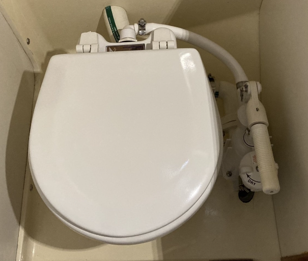

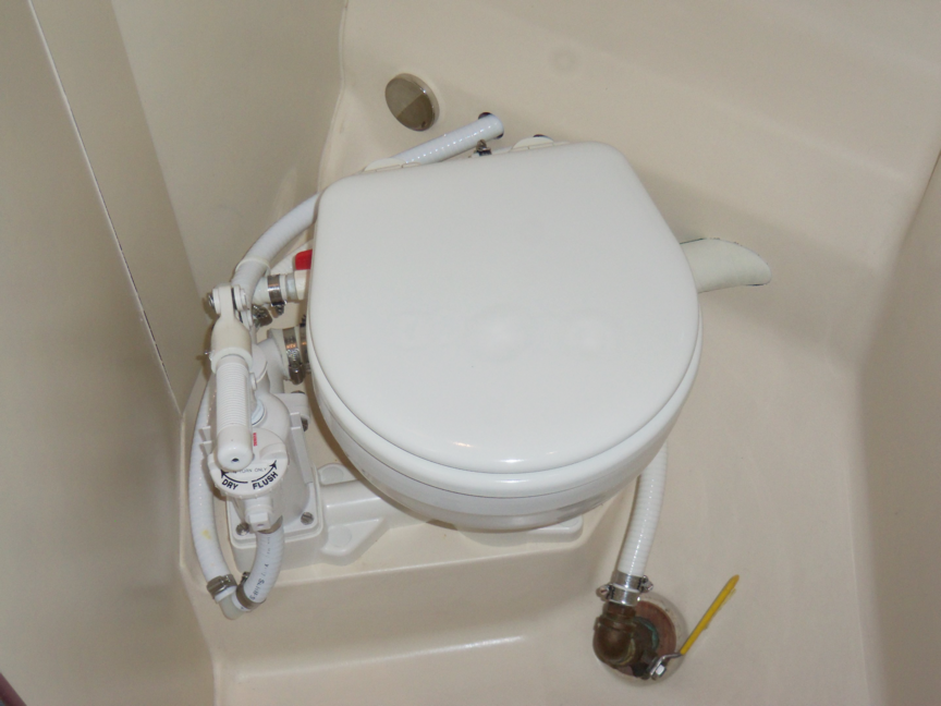

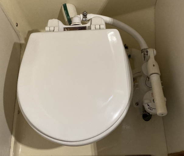

There's your problem right there :
Your pump is mounted on the RH side, rather than the LH side like mine :
Just plain bad Juju :laugh: .

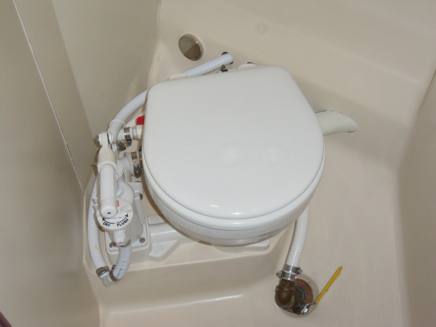

The only argument I can offer to counter the theory of a water mineral buildup is that my joker valve spends the vast majority of its time in fresh water due to the flushing arrangement which you introduced me to numerous years ago. That's the one where fresh water is introduced to the head pump (from the sink) and from there to the bowl and down the discharge line to the holding tank as shown below :

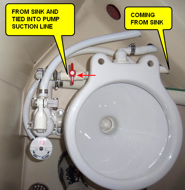

And I know how much you dislike my installation ( I do apologize) because you think it looks as if it was taken from a petroleum refinery. Perhaps, but it serves the purpose well.
Our Vancouver, B.C. water is surface water and is noted for its low total dissolved solids and its low pH of an annual average of 6.5 so that is likely why the sea mineral salts are dissolved when sitting for long periods in our tap water.

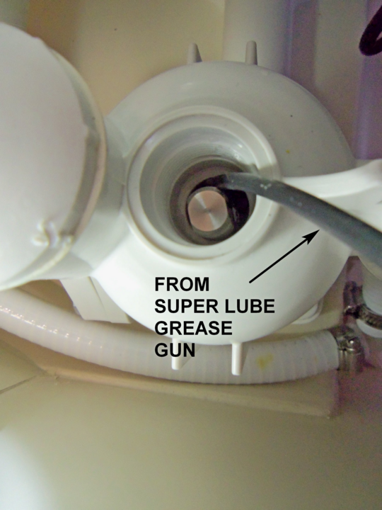

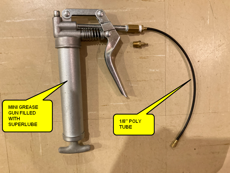

And .......................... if you don't like digging in the bottom of the pump because you DO know what's been in there, you can build a little grease gun like this :
................................. remove the piston rod gland and go in through the top of the cylinder. Press the1/8" poly tube up against the cylinder walls and supply a tbsp. or two of grease to the walls.
