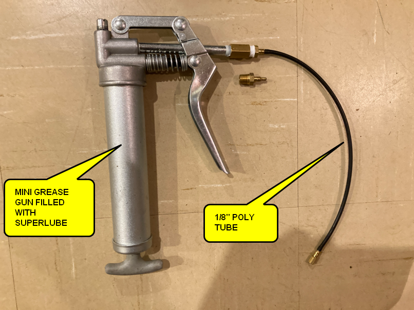

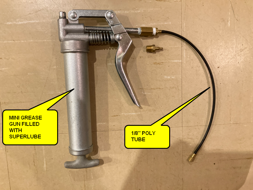

And .......................... if you don't like digging in the bottom of the pump because you DO know what's been in there, you can build a little grease gun like this :

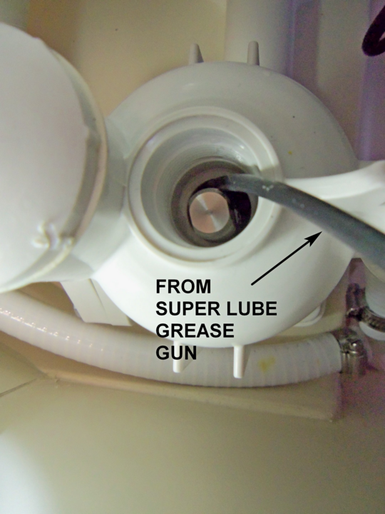

................................. remove the piston rod gland and go in through the top of the cylinder. Press the1/8" poly tube up against the cylinder walls and supply a tbsp. or two of grease to the walls.

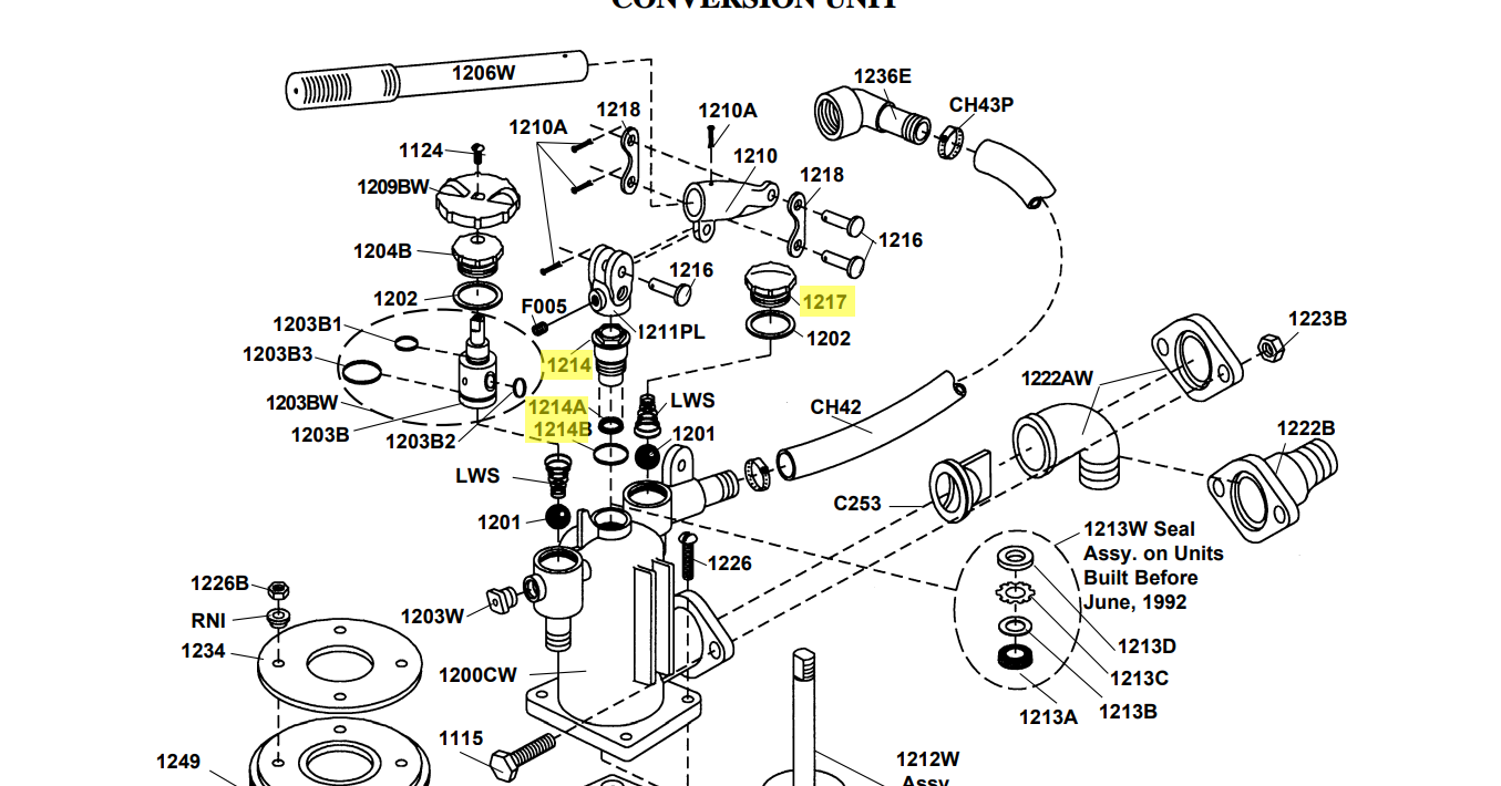

Can you get the the piston rod gland up without removing the discharge valve cap (#1217)? On mine that cap is in the way of lifting out the gland nut. It looks on the picture that your cap is still on.
Thanks.
Jan 4, 2006
7,839

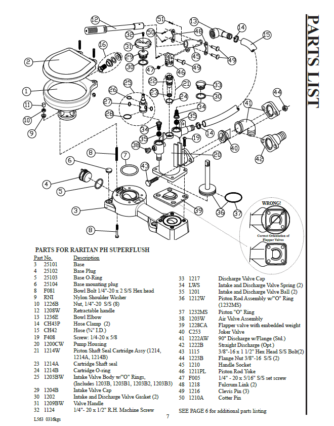

Hmmmmmmmmmmm. I don't remember having any problem lifting the gland nut straight up and out, but I DO remember having one hell of a job unscrewing the the gland nut #1214. For that part, I bastardized an old 7/8" combination wrench and ground the circumference of the box end of the wrench so that it was slim enough to fit in between the #1217 housing and the gland nut. In addition, I also ground down the flat, outer, lower face of the box end so that it gripped the head of the gland #1214 firmly rather than slipping on the beveled edge which leads into the box end. You'll see this problem edge when you look at the 7/8" box end.
I also found some instructions which I had made up for one of the crew for when she was working on the maintenance. You'll have to use my drawing from the attached manual with entirely different numbers to follow the instructions.

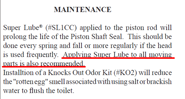

That is the one problem that would have made me think twice about purchasing the Raritan head. The process of lubricating the piston ring is a supremely major detractor for this appliance. Your manual may be different from mine but the one that came with my Raritan PH Superflush will not even touch the subject of lubricating the piston ring as it's such a problem.
And yet ALL manual head pumps must be lubed on a regular basis, even my old Jabsco which served me well, but just liked to leak.
Using the small grease pump for lubricating the piston ring is now so simple my mind had almost completely purged itself of the trauma of that early attempt to lubricate from the bottom :eek:.
