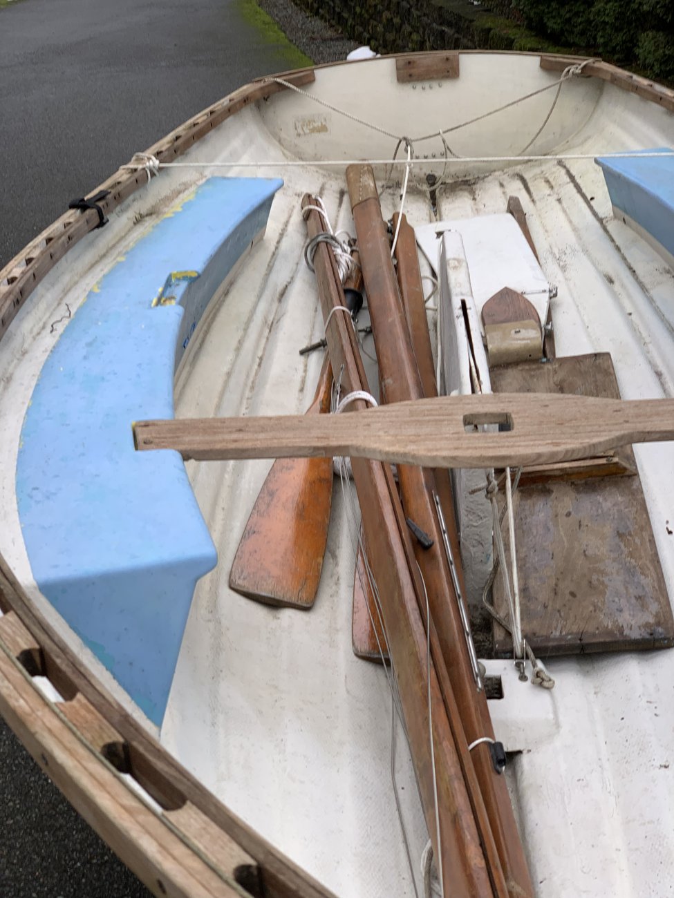

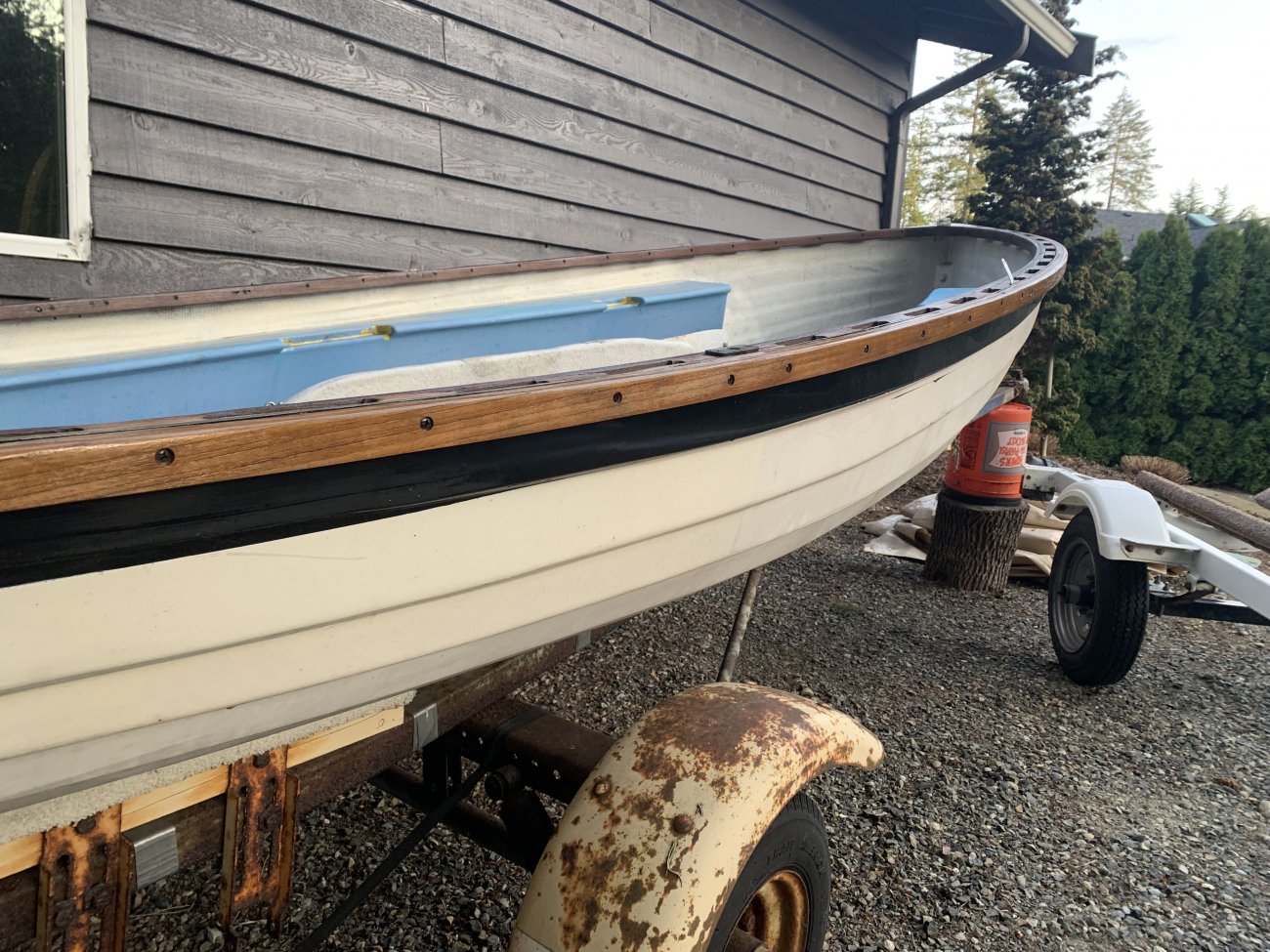

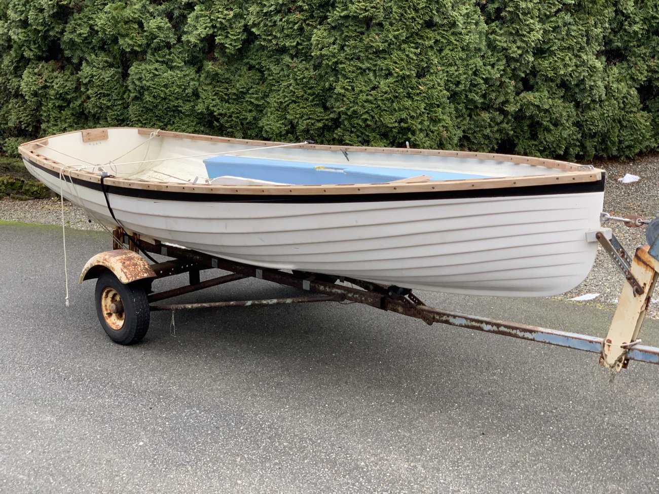

just thought I’d post photos of resurrecting a $200 Ranger 12.

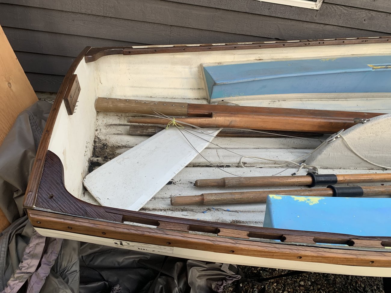

I got the boat here after responding to a general question. The boat was in fair shape after being owned by two consecutive non sailing “restorers”. No varnish existed on the hull the spars and oars still have serviceable cetol on them. It came complete with trailer (no title) sails, and looks like all the parts except some screws and clevis pins. I haven’t put up the two piece mast or sails yet.
Here is a shot of the boat as I pulled into my driveway

Tires are good when I get the boat off the trailer to polish hull and paint the CB, I’ll check the bearings

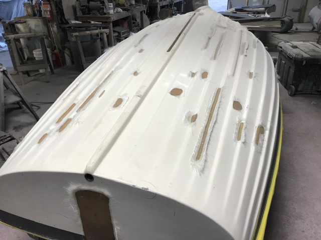

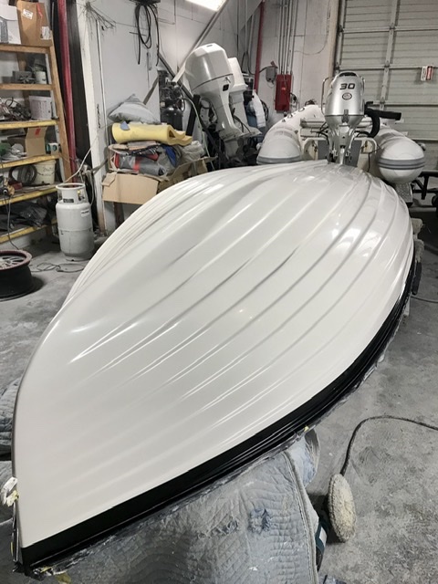

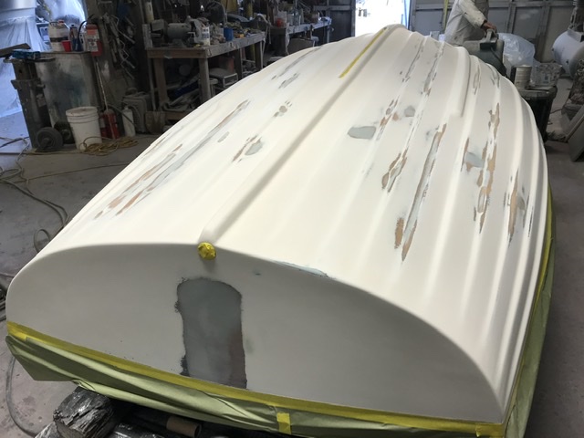

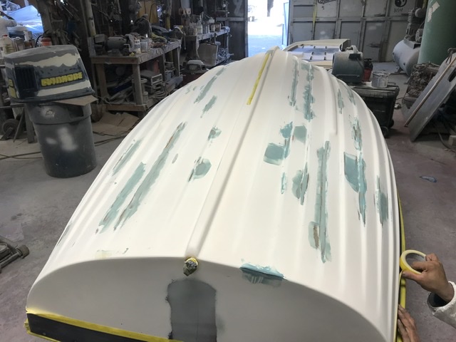

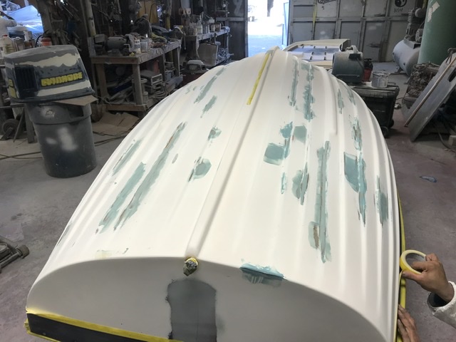

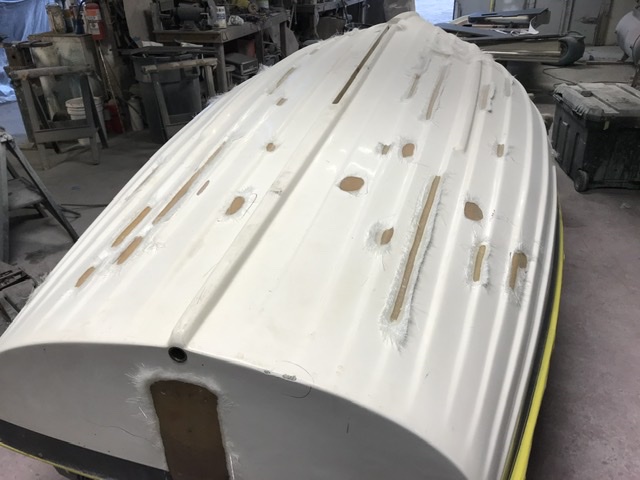

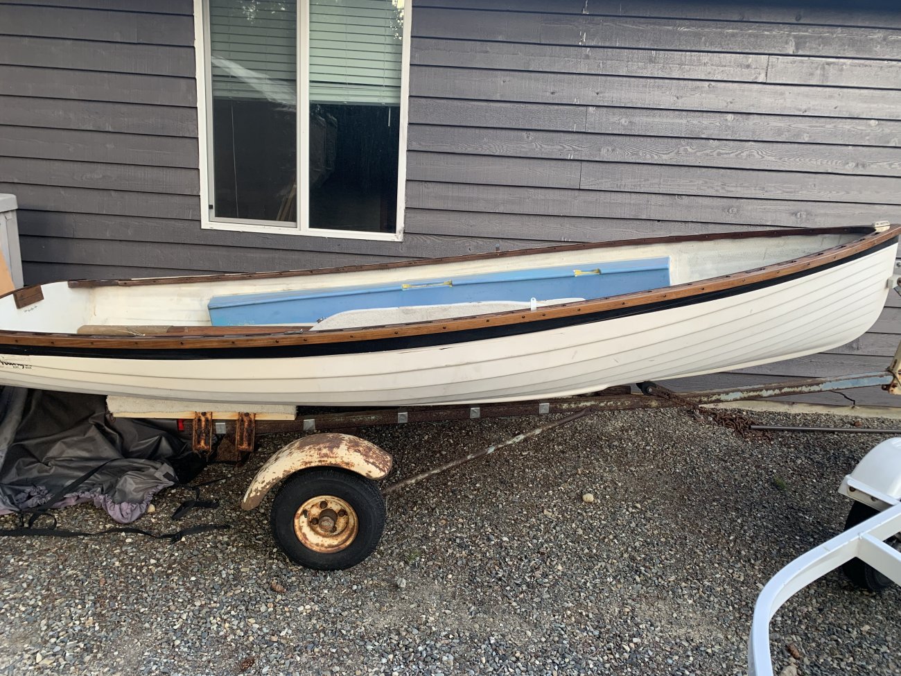

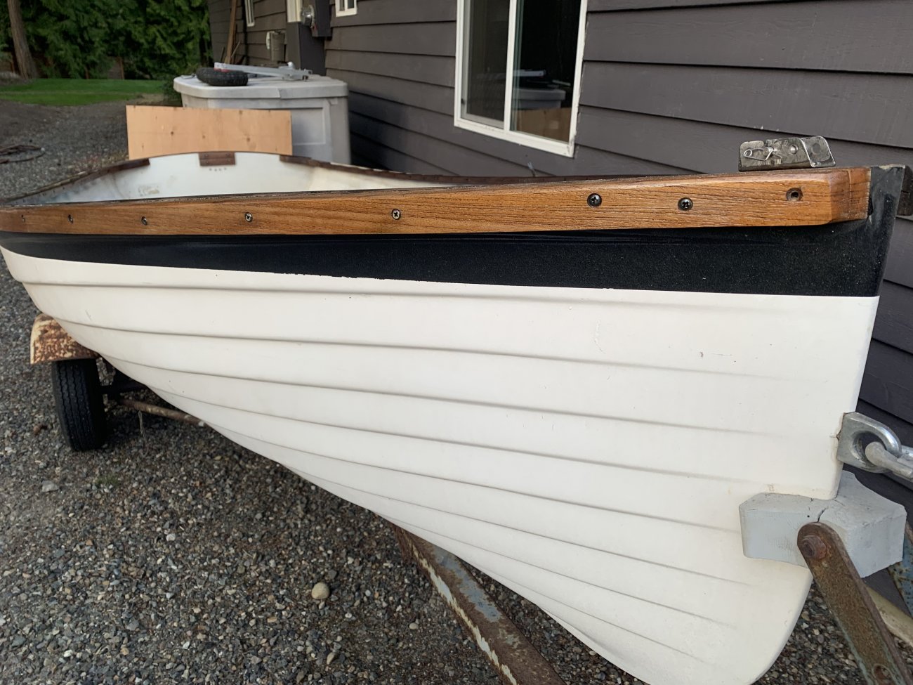

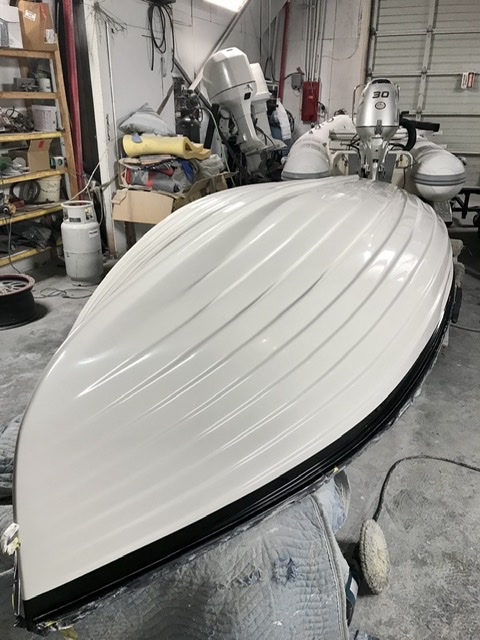

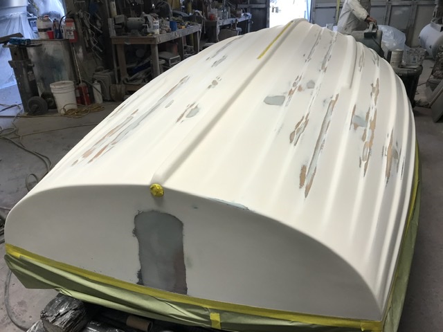

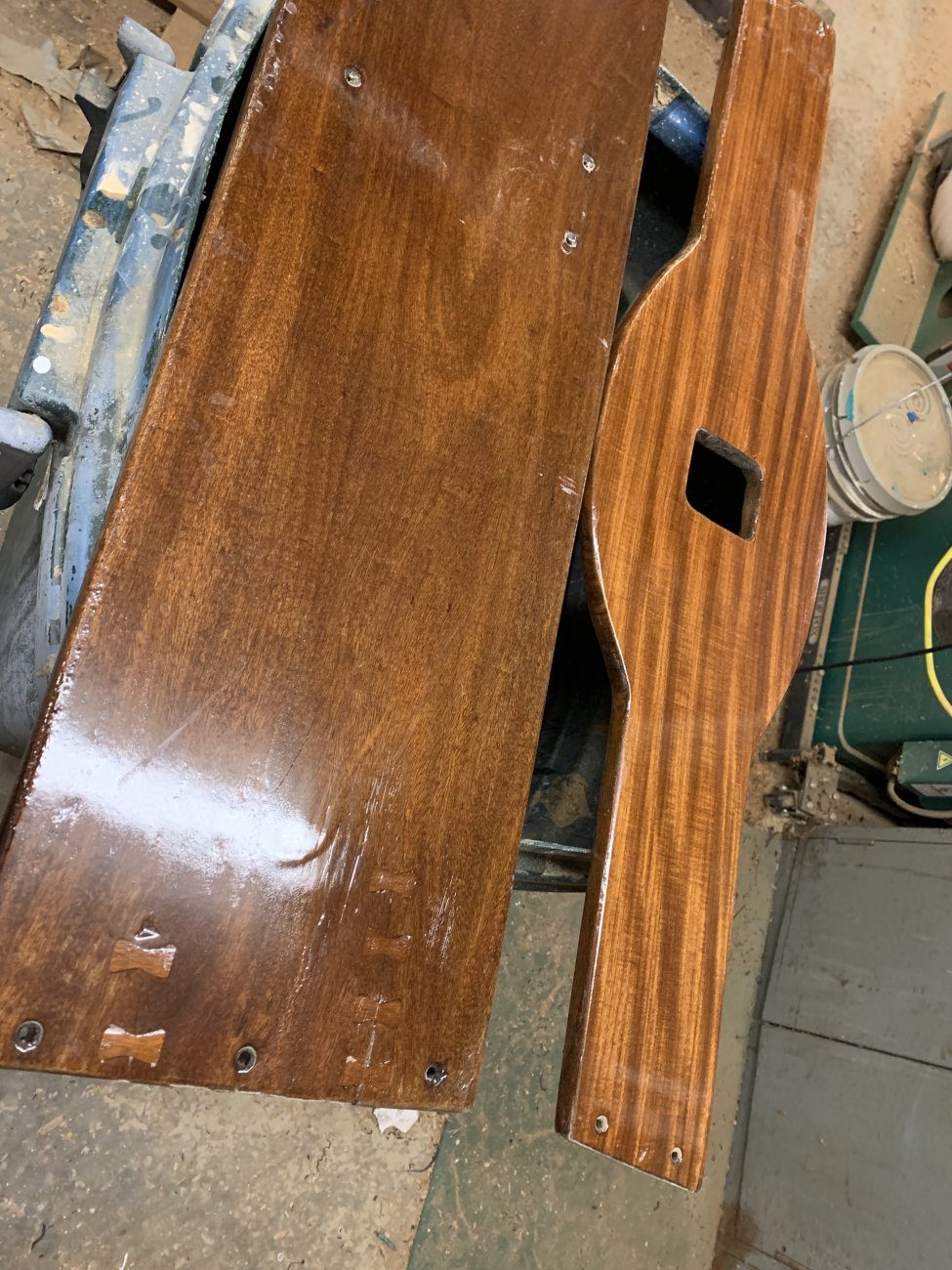

The fiberglass repairs and gel-coat of my Ranger 12 hull are complete! Looks really different now.
I’ll finally be fitting the new kick-up rudder I made to the transom, albeit with stainless steel gudgeons and pintles instead of the bronze I was hoping to use... Oh well!!
Here’s some photos of the ‘new’ hull!

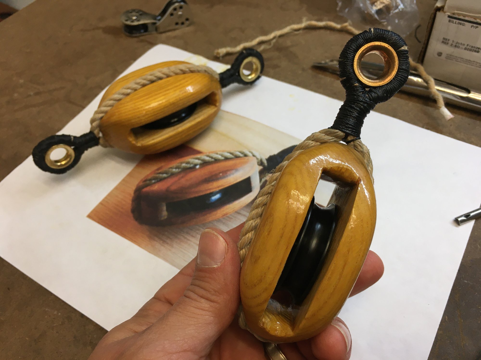

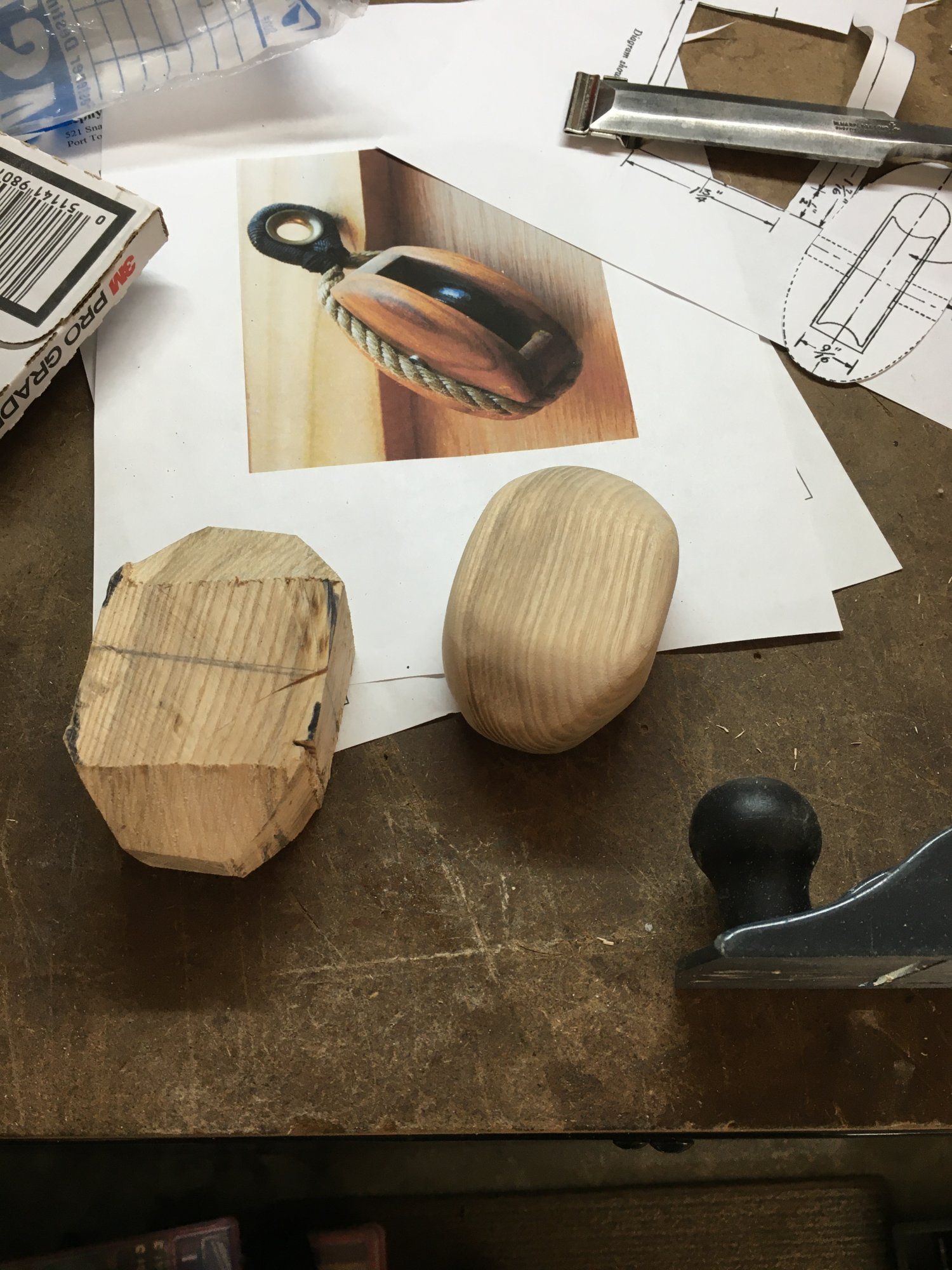

I have two rope stropped blocks to make for the mainsheet and sew one patch and grommet for the brailing line and then she’s done! Just a few more weeks.
View attachment 176832View attachment 176833View attachment 176839

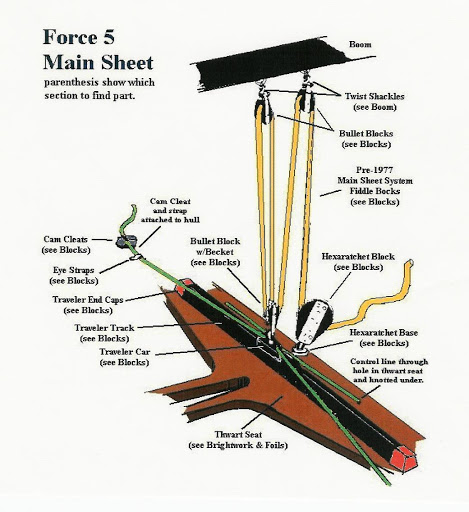

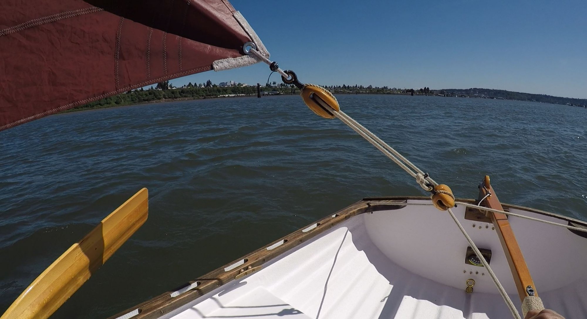

Great job (!) on the Gel coat repair - what did you use to paint it?

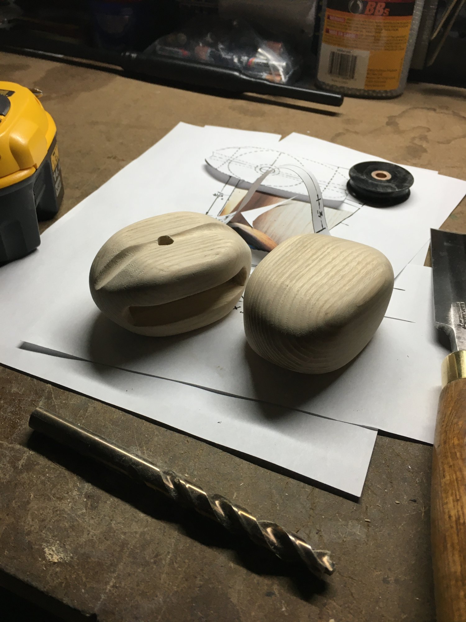

Also, why do you want to rope stropped blocks which are practically un-adjustable? It is not that traditional of a boat and modern blocks actually work. I am switching mine out to a Force-Five style setup as below-
Actually, I did a total conversion of the Ranger 12 and it's a traditional Sprit Rig Sloop now, hence the rope stropped blocks.
Oct 19, 2017
8,198
A B S O L U T E L Y Beautiful.

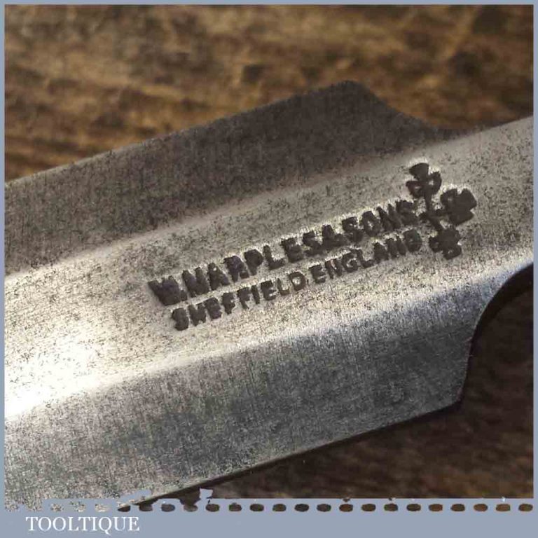

Good looking chisel, I can almost read the brand, but I don't think it says 'Witherby'. The symbol doesn't look quite like Buck. Nice tool, though.

Thanks Will!
The chisel is a vintage W. Marples & Sons (1920-1940). A good friend of mine got it from a restorer in the UK and gave it to me last year. I couldn’t have done any of the wood working without it. It’s super sharp and precise.
