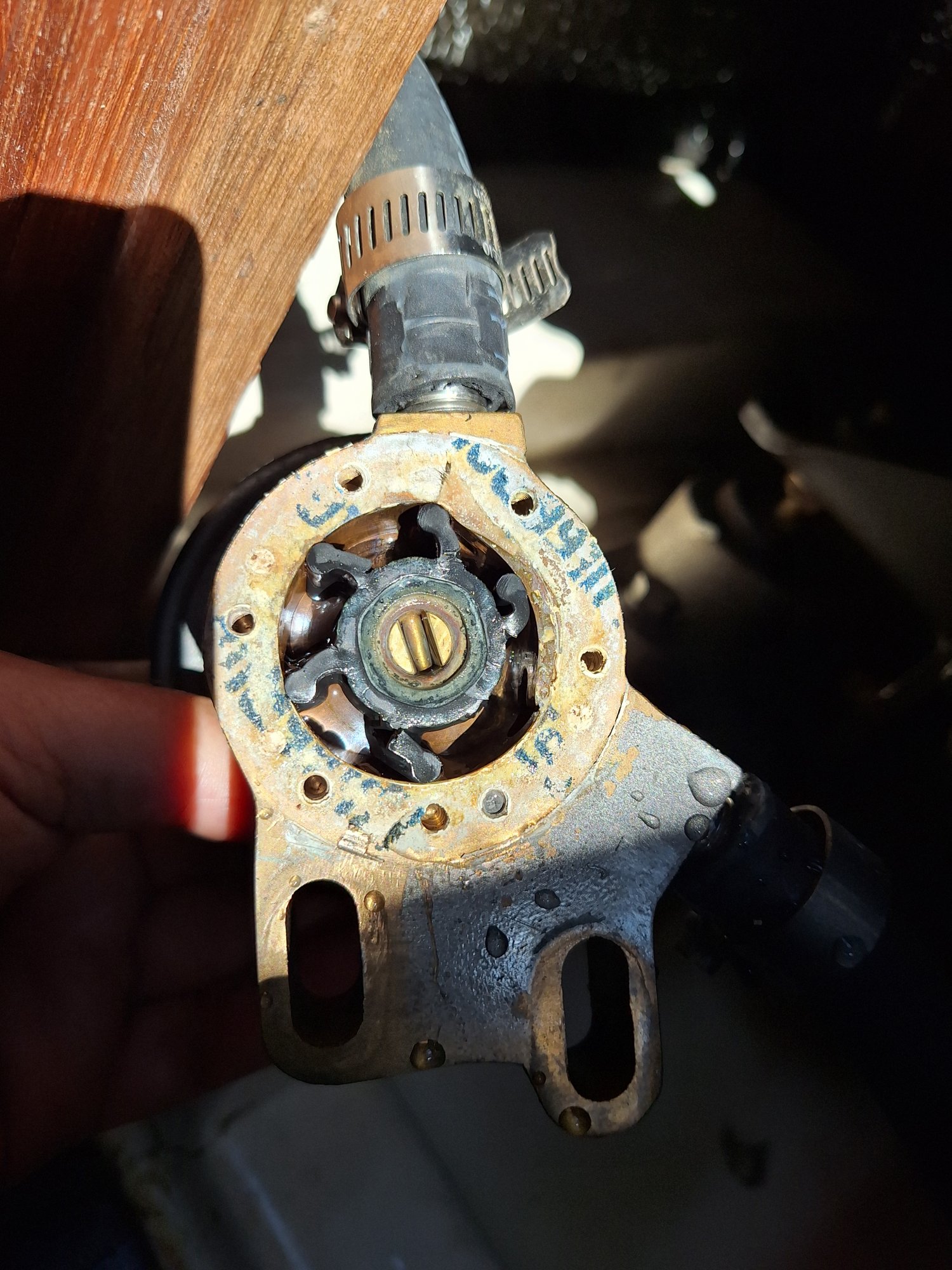

I replaced the oil and filter and replaced the impeller, which was definitely worn with at least one broken spine. Unfortunately, one of the M6 bolts broke off when I removed the thermostat, so now I have that to deal with before I can put a new thermostat in. Tried everything, nogo. I'll try to drill and tap, but I may need to find a used heat exchanger housing.

That’s a sad looking impeller. I wonder where the broken vane ended up. In fresh water cooled engines they often get stuck in the heat tubes of the heat exchanger. I don’t know if there’s a typical blocking point for them on raw water engines.

I'll be taking the heat exchanger apart to inspect/clean after I get the broken bolt drilled and tapped

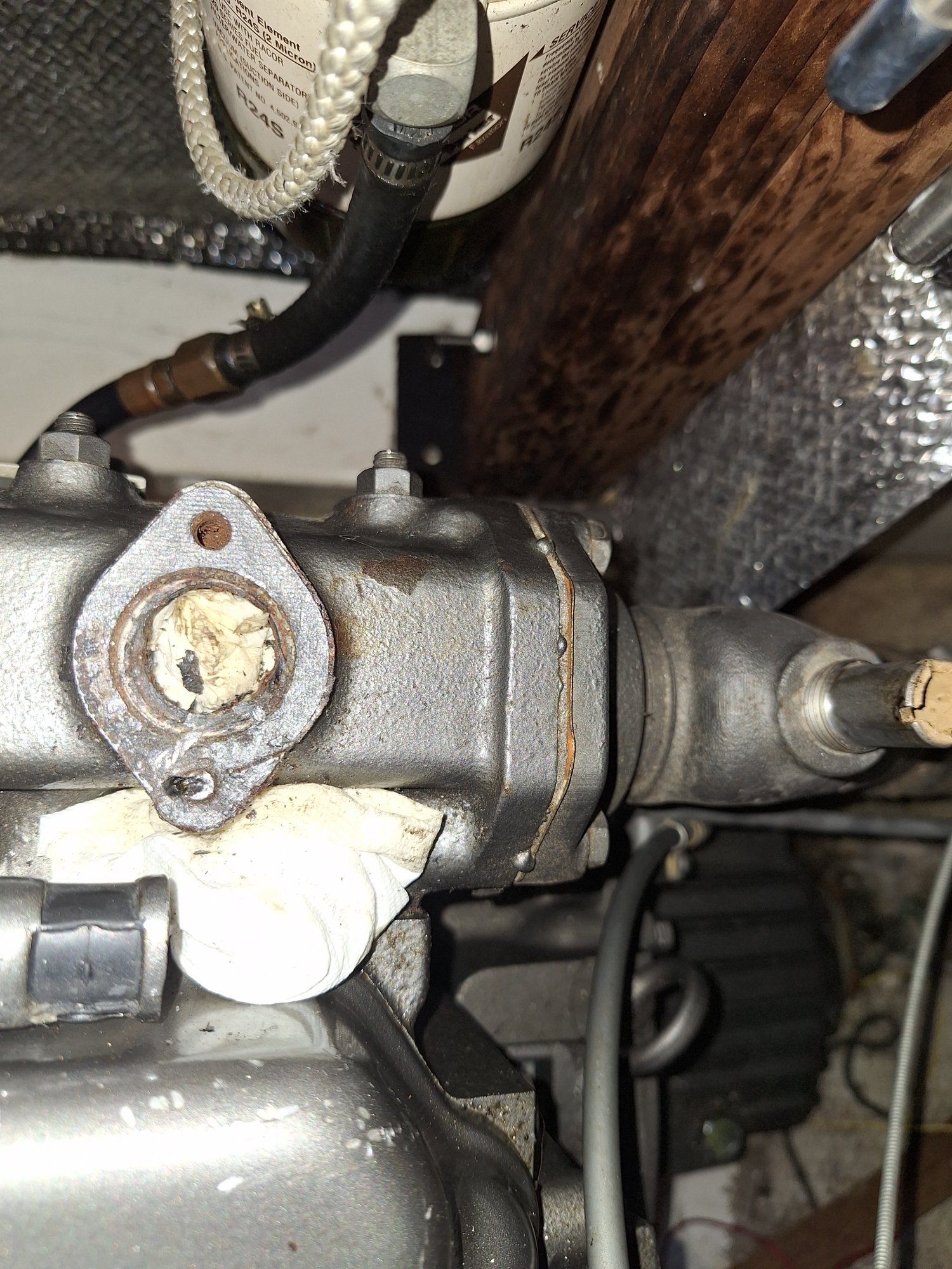

As a raw water cooled 2QM15 you don’t have a heat exchanger, at least assuming it wasn’t modified for fresh water cooling. The manual (page 7-1 at https://j30.us/files/2qm15_servicemanual.pdf ) shows the thermostat screwing into the exhaust manifold. I can’t really tell from your picture but I presume that’s where you have the broken bolt.

Thank you for the info, Davidsailor26! That is correct. I thought it was a tad short for a heat exchanger. I need to take exhaust manifold off and drill and tap both holes to a larger diameter bolt.

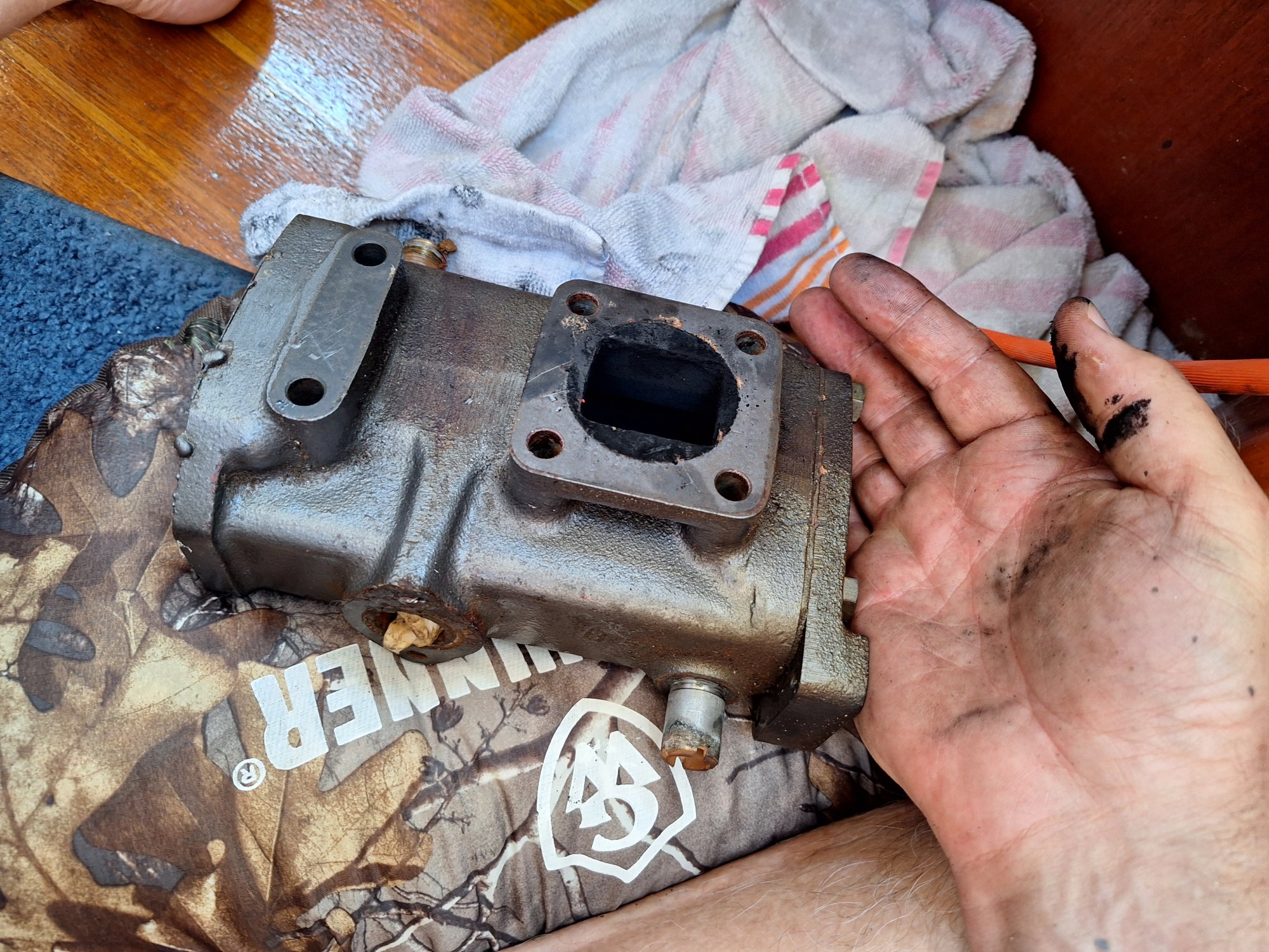

Got the exhaust manifold off. Now I need to drill and tap it. Should have the new thermostat in a couple of days.

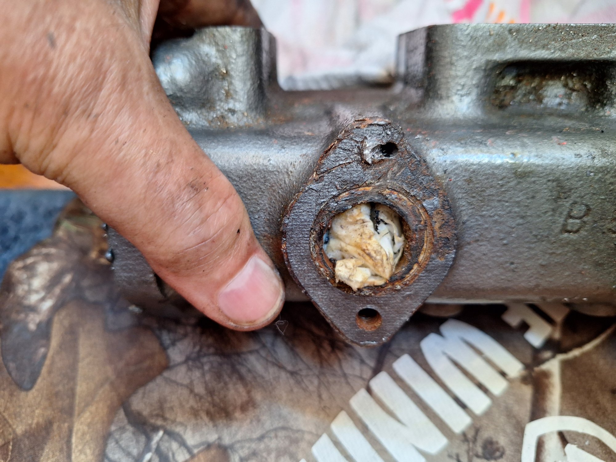

In looking at the picture of the broken bolt/damage, it appears like you have attempted to drill it out and the hole is now offset from the original hole. Is that correct? If that is the case, drilling and tapping an oversized hole my not be a solution. You may need to do some sort of repair to the base metal of the manifold that looks like a cast alloy steel. It is sometimes difficult to get a good weld on cast metal so make sure you have an experienced welder who knows what it takes to weld to cast alloy steel.
My thoughts exactly.
Can you take a picture of the flange on edge and lets' see if there is any room to use a nut and washer directly under the original hole in the flange ? Drill out the original hole with an oversized hole so that it exactly matches the other flange.
I don't think I need to mention "not too big a hole" or it will weaken the flange. Maybe use the thermostat or the mating flange as a drill guide when clamped (bolted) in place with the good holes, if possible ?
Thanks Smokey73, I'm definitely getting an expert opinion from a very experienced machinist.
Not sure I understand your suggestion. I think the best solution is to have a professional drill and tap using the thermostat flange as a guide.
