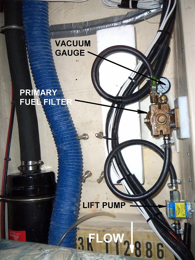

My Racor 110A was mounted in the worst location possible right from the factory ......... right over a run of wires and hoses. Near impossible to change the filter element without many, many rags and poly sheet to protect what's underneath. Finally got around to re-locating the filter further back in an aft compartment as shown:
Only 1/2" under the filter now but unscrew the nuts holding the filter in place and work with the filter sitting in your lap. Double nuts (shown) were only temporary - nylock nuts now hold the filter body in place.
