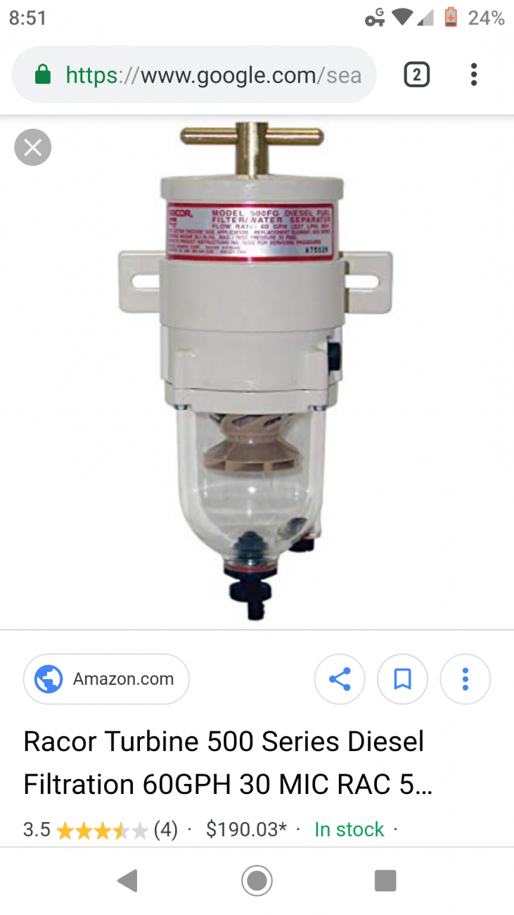

This is the 500. I have the Racor R20. Replacement filters are $35-45 here in the Caribbean. The Racor 500 are under $20. And everything I am reading says they are a better filter and easier to change.
That looks like a nice filter, Jesse. Turbo-charged! It might be a bit too tall to install where my Racor is.

The 500 is taller. Will it fit under the aft berth? Or would you go with the non plastic version and mount it in the engine compartment?

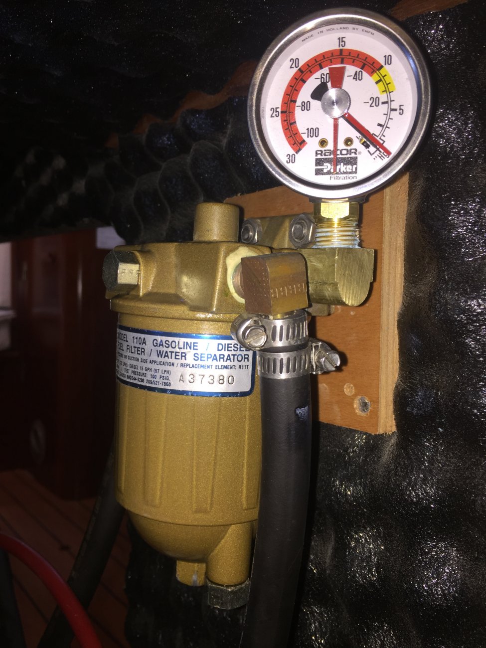

$200 will buy a lot of R20 filters. But unless you have a fuel tank contamination problem there is no reason to be changing filters until they need to be changed. How do you know when to change filters? You have a vacuum gauge that gives you a heads up. I haven’t changed my Racor 110 in three years. Zero vacuum restriction. Will pull the drain this year and see if I have any water in the bowl. If you keep the top vent in place it just dribbles a few spoonfuls of fuel. Also have the Racor R20 on my genset, that one is even easier to manage, clear bowl and it includes a priming pump. The Racor 500 is spec’d for 60GPH, your engine moves what 5GPH? Overkill.

Not mentioned was another major reason to upgrade to the "500 series" filter. It has less places for an air leak.
Our '88 boat came with the then-common Racor filter with the "stacked assembly" of the R20 model and the possibility of two separate O-rings to leak. After a number of years, we chose once to upgrade to the newer version of the same Racor model, as the original one was out of production and there was a question as to how long the elements would remain available.
Last year, when we changed out the original diesel for a new Beta, I followed the advice from several mechanics and installed the 500 series Racor. I also found a nearby separate area for it so it no longer would live in the engine compartment. Any filter there would need a metal bowl ($) over the bottom plastic bowl to meet current ABYC fire recommendations anyway.
Given that we only had to change the old filter element out every year or other year as a precaution, the new larger 500 should last a long long time between filter changes.
Back to air leaks (aka 'vacuum leaks') I had to trouble-shoot dying-engine symptoms a couple of frustrating times with the old Racor, and one time had a re-plumb my way round the Racor to get home from a vacation cruise.
Someone mentioned size of the total filter assembly. I did find that it measured out a bit taller. If there is a couple of inches to spare where the old one is, the new "500" might fit OK. Measure your boat, and use a mock up to visually check the fit, before you buy the new one.

Hi again! The tradeoff is less expensive filters with a more expensive manifold vs. the more expensive 20 filters and a much cheaper screw-in housing. I do not believe the 20 housing can be used for the 500 filter.
24,760
Stu is correct. The 500 filter does not work with the 20 housing.
I like the 500 for it’s top down change design. I can change filter without inducing a air into my fuel system. Filter change 7 minutes, no diesel spills, $10-$15 filter. Yes the initial cost is steeper than smaller models. But starting with dirty fuel and multiple filter changes to clean / polish the fuel, lower overall cost.
Its not as simple as flow. Its cost of replacement filters. Availability of replacement filters. Easy of change (you don't have to rebleed the system as much with the Racor 500 as you do with other styles, you can even keep fuel in the filter housing and change the filter with minimal priming. If I could fit it I would purchase a Filter Boss dual filter unit but on a 31 foot boat there is just so much space. These dual filter units are not uncommon on cruising boats even though the GPH rating is often 100 times the needed flow rate for the engine.
