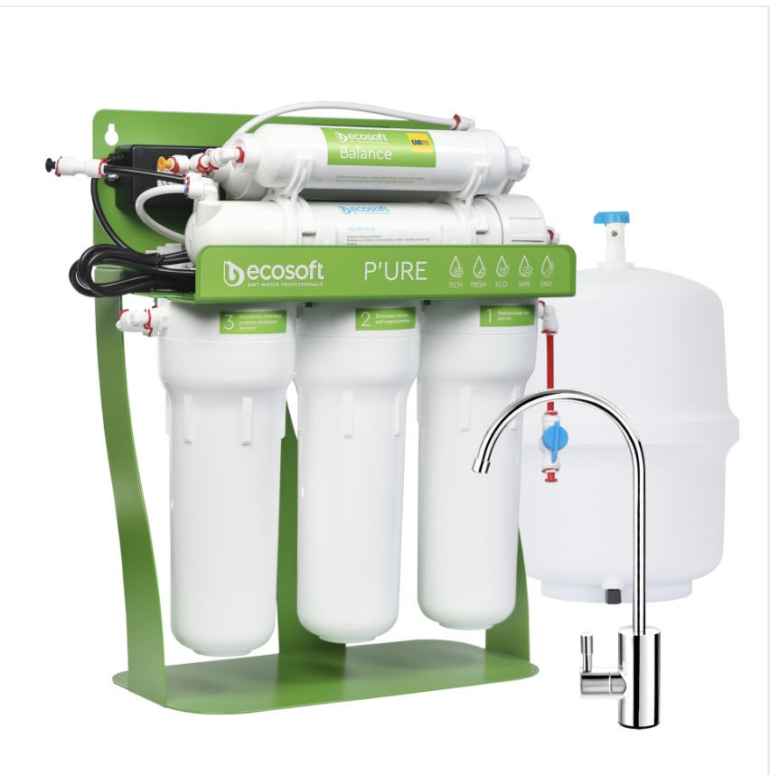

To use water from the tank. I'm not filtering the entire tank just what i need for drinking water. The RO system will be tee'd off of the main line. It has a separate storage tank and sink faucet, so im only filtering what i drink, approx 2-3 gallons a week. Showers and dishes etc...will bypass the filter.

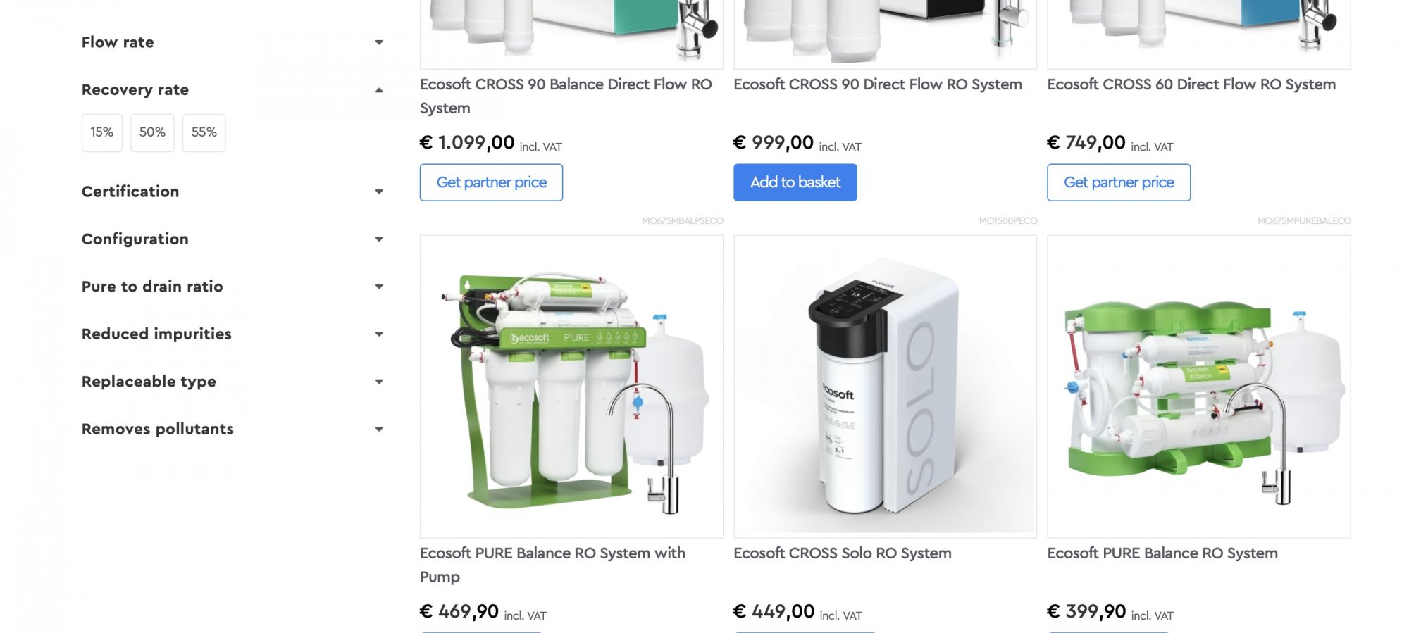

This unit, that looks like the OP's has a 50% recovery rate.
