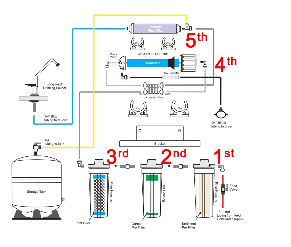

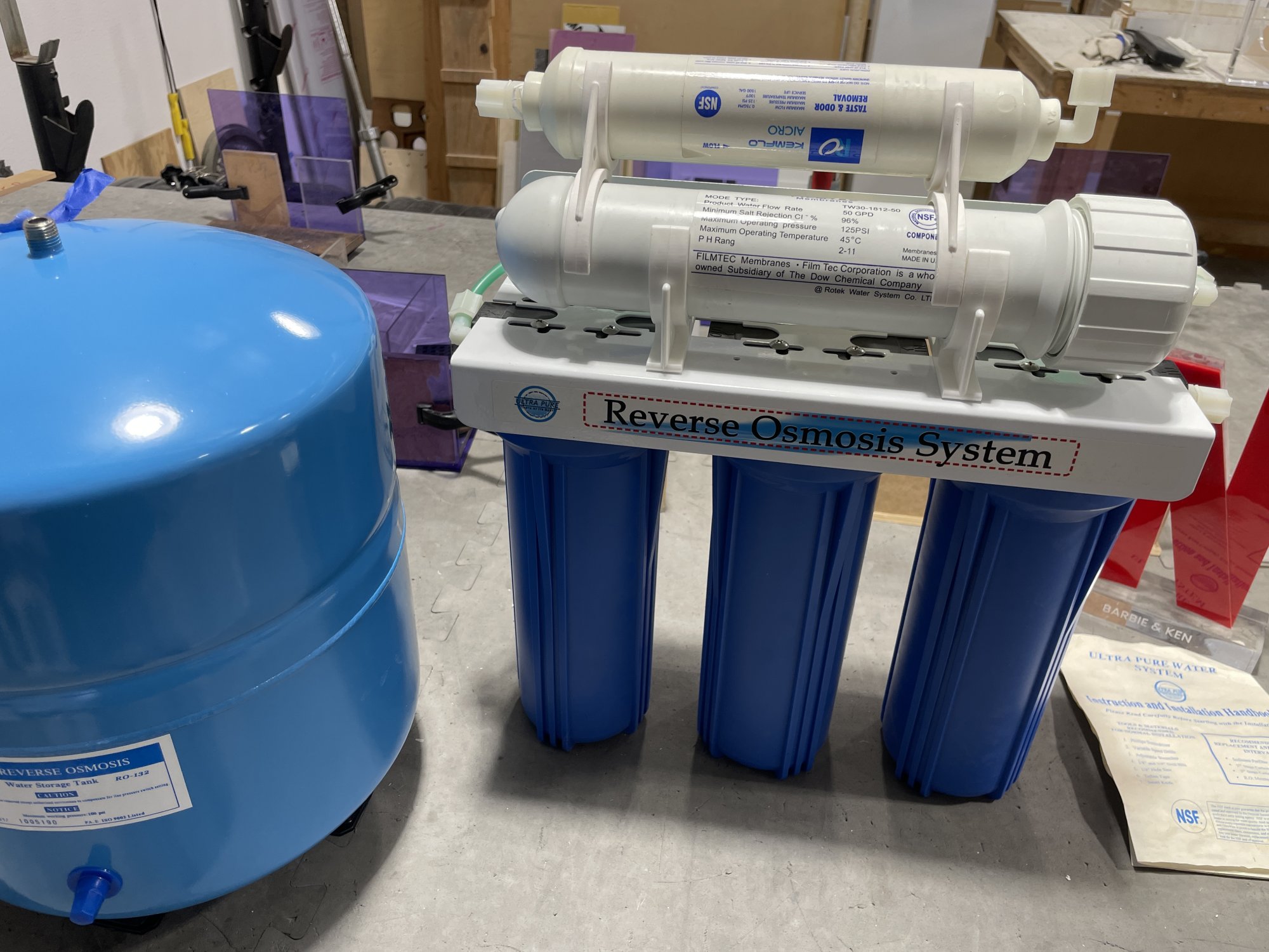

I recently inherited a simple five stage RO water filter. Do I need to install a second fresh water pump just for the RO filter? I wanted to have the system set up with a separate faucet for the RO drinking water, and a bypass or separate pump/line that goes directly to the faucet and shower for doing dishes etc...
Also, will i need to fiddle with the air pressure in the accumulator tank or do they generally come setup at the appropriate air pressure?
I recently purchased and installed a brand new Shureflow Aquaking II fresh water pump. Will it constantly/frequently cycle trying to push water through the filter more than it normally would?
Sep 25, 2008
7,747
Alden 50 Sarasota, Florida
You need a high pressure feed pump which typically comes with the RO system but yours may not. Check specs for the system you now have.
On the downstream side, all you need is to replicate the existing plumbing pump, accumulator and storage tank which can be plumbed wherever you need.

Oh I see. Its a generic five stage setup. I think its an older unit (early 2000's). I cant find the company anymore, but there are many look alike copies on Amazon that are basically the exact same unit. I did buy a wastewater fitting that I will attach to the sink drain. I have never seen or used one of these units so am not quite sure what to expect in performance on a sailboat.
