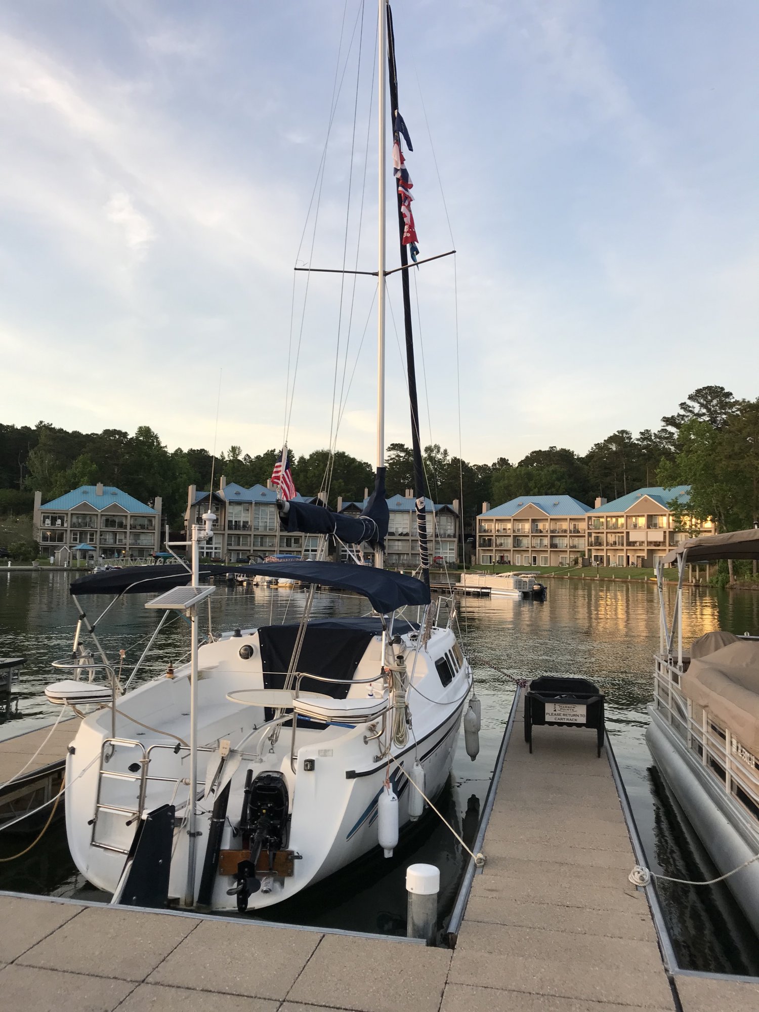

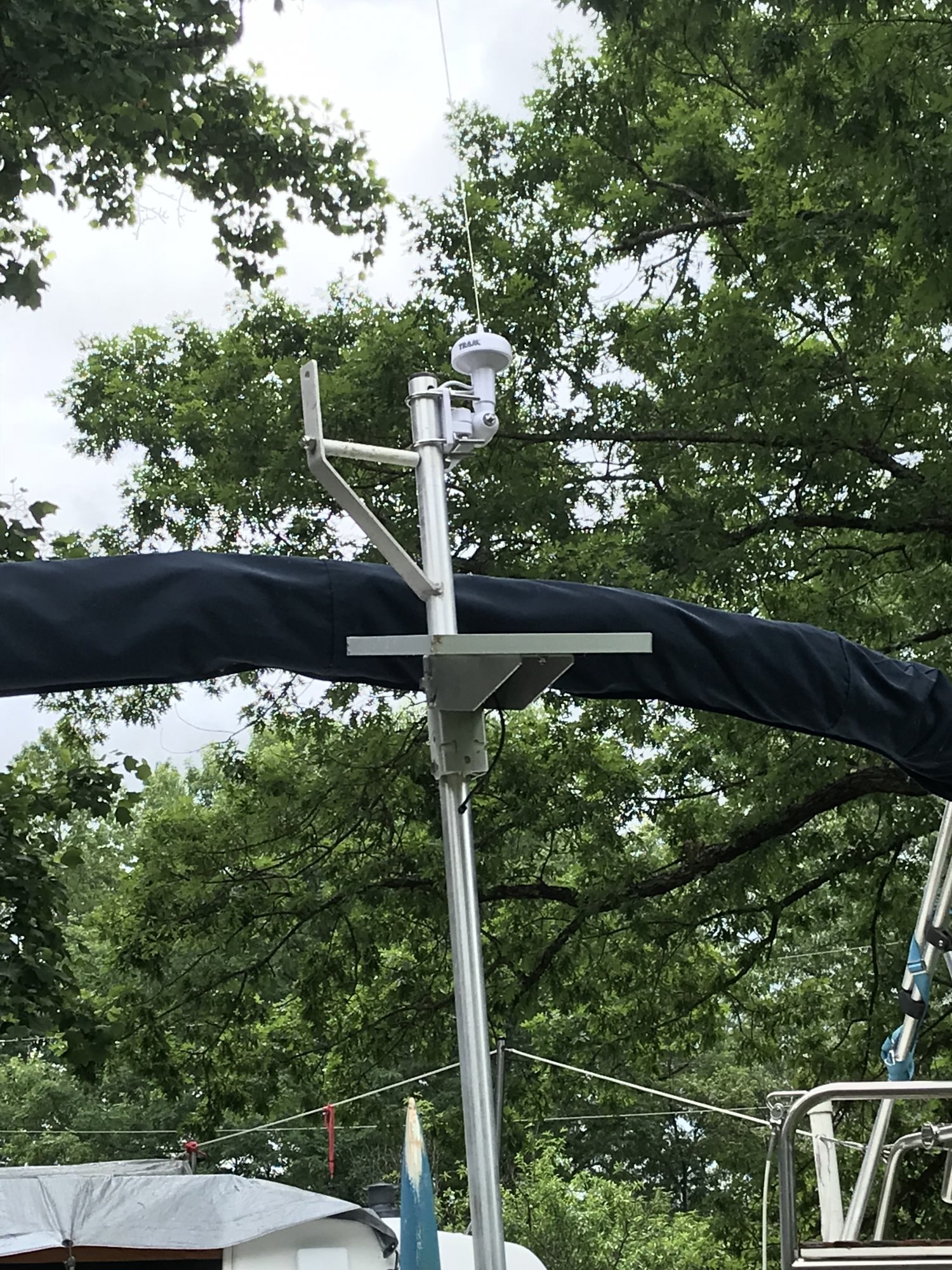

I already have a lot of stuff on my stern pole.... my stern pole is actually the mast crutch for when I'm trailering....
I could see building something that goes where my existing pole now sits....maybe a little taller. Would be easy to do. I could put my mast crutch in the shed when the boat is in the water. I think I'd also like a slightly larger solar panel and maybe move my VHF antenna onto the top of the mast. My VHF already has AIS and a RAM. I can also add the fog horn to my RAM but that is an add-on feature.
