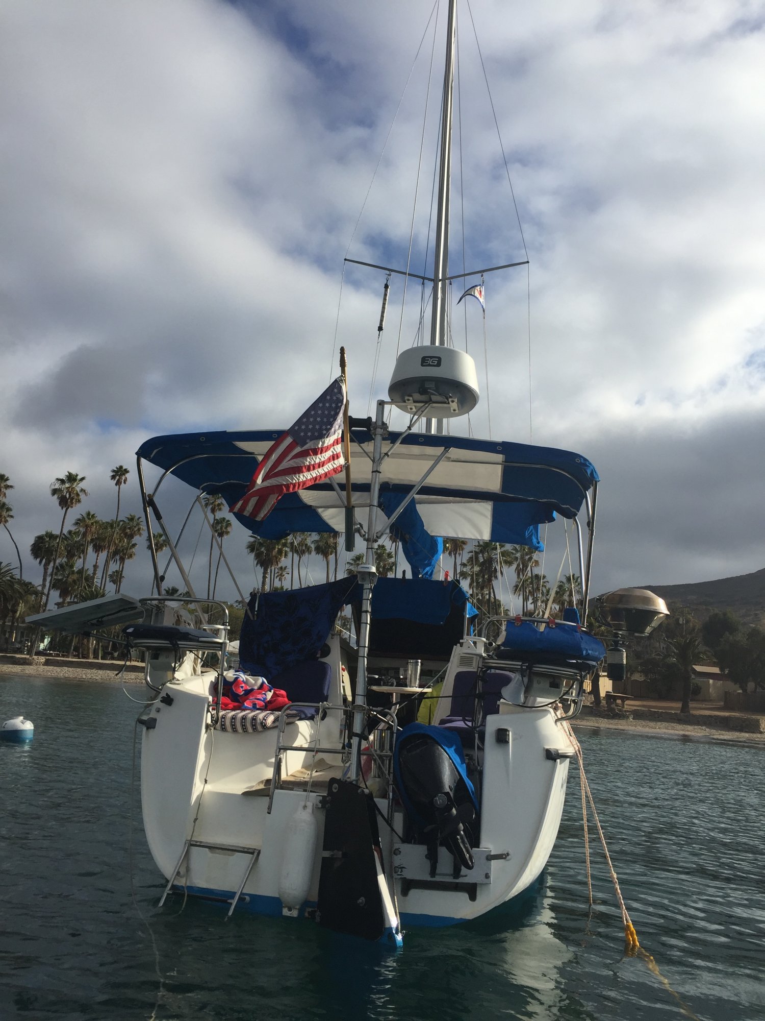

My radar display is below and it is usually turned off, or is on standby. So, it is not central for piloting me boat. I use the Fujinons far more often than I consult the radar display. But when I feel I need it, I’m happy that it is there.:)

One FYI note about stern posts versus masts for mounting radar. Stern posts are usually off-set to starboard or port, whereas the mast is on the centerline of the vessel. Thus, for radar mounted on stern posts the target bearing of a mark may not agree with your GPS (or chart) bearing of that mark. The discrepancy grows as one approaches the mark. In total fog of near zero visibility this can be a bit disconcerting if not down-right confusing the first time you encounter it.:doh: Obviously, it is more cautious with close encounters to stand clear of the radar target even if the GPS is telling you that you are already on course to avoid it, etc. That is, GPS may be telling you that you’ll pass the mark on your port when the port-side radar is telling you it’s dead ahead. It’s dead ahead of your radar (line-of-sight), but not your bow. Yes, it’s a small but noticeable discrepancy. In super dense fog when you are totally dependent on instruments, even these small things can alarm you.:yikes:
