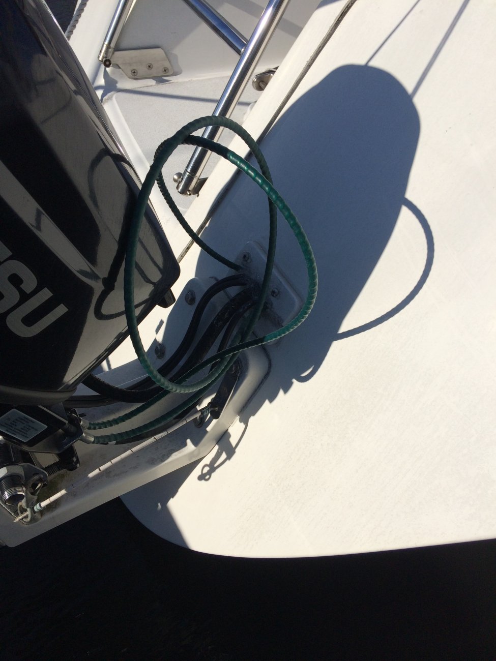

I am about to tackle replacing some rotten core in my transom. My 1988 H26.5 has a small outboard motor mount and there must've been water getting in through the mounting bolts. I have bought and read the West System book on fiberglass repairs and have all the materials in hand, but I'm not sure about one thing.

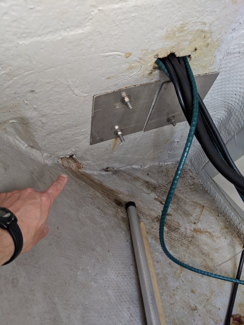

The repair will be done from the inside of the lazarette. It is a great place to do my first FG repair, as it doesn't have to look pretty. The inside of the lazarette is just fiberglass that looks to be painted. Especially the woven roving in the one corner. I seem to recall reading/hearing that you can't epoxy over polyester paint. Is this polyester paint, or is it epoxy paint, or is it just tinted epoxy? Do I need to sand off the "paint" in the areas that I will be laying up new fiberglass for the core replacement? Do I need to totally remove the paint, or just rough it up?
What kind of surface prep do I need to do to the areas that I will be epoxying onto? Any help would be greatly appreciated.

It is probably paint and you'll need to remove it. The inner layer of glass needs to be removed, the rotted wooden core removed and a new glass and resin laid up.
The new glass should bond directly to the old glass without an intermediary layer.

In your picture, that is not paint, but it is a polyester gel coat that is painted over the laminations of the transom. 31seahorse offered up some good points. If you have core material that is compromised from moisture absorption, you need to grind out the top layer of fiberglass (inside the lazerette) to get at the core to remove the bad, wet core. The best thing for you to do is to fiberglass the area where the outboard bracket attached leaving out the core and making it solid. The other areas you can put in new core material. This way, if you ever get water protruding via the bold holes, it won't be wrecking your new core. The moisture cannot go anywhere because it is solid. You need to use roving and alternating layers of matt gradually building it up to the thickness consistent with the rest of the transom. Also, as pointed out, you could add a backing plate on the inside to spread out the load and offer more strength. Remember when using epoxy, you must protect yourself. You can get senstitized to epoxy if you expose yourself to it too much. If that happens, you can't even be in the same room with it. So, wear a mask, gloves and protection as suggested above.
