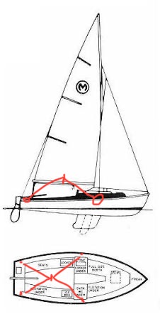

I am lifting my Oday mariner (my current bridle has two pieces of longer rope that loop on the aft cleats and then two clamps that attach to two shackles right where the side stays meet the hull)

So you need to pick up roughly 1500 pounds - the weight of your boat - is that correct?
As it's a lifting line, you could use almost any type line: dyneema, nylon, polyester - whatever. You may prefer a lower stretch line. Typically you use a line rated for about double you lifting weight. As you can't be certain each lifting point loading, I'd design each connection point to handle the full load. Using a generous safety margin, you could use 6 mm dyneema for your lines. But you would need to make certain of your connections strength and the design strength of line - different dyneema manufacturers may have different load values.

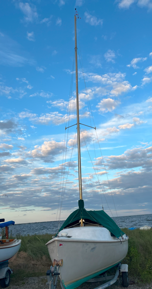

Yes the bridle for pulling my boat in and out of the water have nothing to do with anchoring it. I have attached an image of the points where I attach it to the boat. (On the two cleats in the back and then two clips forward on shackles attached to the side stays at their base.)

Look for lifiting slings. It will help distribute the weight a bit better than line. Any legitimate manufacturer will list the breaking strength and working load limit. Over spec the line by a factor of at least three. In many industries they do a factor of 10.

Is the mast down when you are lifting the boat?
24,872
Looking at your diagram, it would be unusual for a builder of your boat design to create and ship a "bridle" (or lifting sling) with the boat. That leads me to believe that the sling you used was an aftermarket or previous owner solution to lifting the boat with a crane.
You will want something with very low stretch. There are a number of ropes with different prices.
  • Dacron/polyester brade has a 5% stretch.
  • You can use Dyneema rope with, in your case, nearly zero stretch.
  • Or I would be inclined to get a polyester webbing that has minimal stretch.
Finding the center point of balance to keep the boat level when lifting will need to be discovered. It will be influenced by whether the mast is in place or not. Looking at your image, I would want to move the crossover point of the lines further to the bow or remove the mast so that you can find the balance point. You might also consider moving the points you use in the middle of the boat forward in front of the mast base for better balance.
