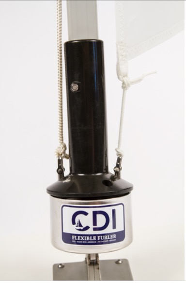

Just found a manual online for H22. We’ve all sorta been steering you wrong, or not quite hearing you. Your boat has the forestay integrated into the luff of the jib, so as you said from the start, the jib itself is what holds your mast up in the front. That integrated luff wire attaches to a swivel bearing at the mast and a furling drum at the bow fitting. As such, as with my boat but for different reasons, you have no need for the jib halyard.
The manual I’m looking at doesn’t show a halyard at all. My guess is that it’s there in case you ever want to replace your “jib with integrated forestay” setup with a traditional forestay and hanked jib, or a forestay and separate furling system setup. In this case you would need the jib halyard (unless the furling system has an internal one like mine and rgrangers, in which case you still wouldn't need it).

Yep, I should have deleted that question, per next post.... Your forestay is integrated into the luff of your jib, so as you said from the beginning, the jib holds the mast up and needs no halyard. So, per your original question: you can use the halyard (red line) for raising a jib sock type sail cover to protect your jib when it is furled, as a halyard for raising a spinnekar/gennekar/asymm, or as a jib halyard if you ever replace your existing setup with a traditional forestay. Otherwise, you don't need it. Just tie it off at the bottom of the mast and sail-on!
