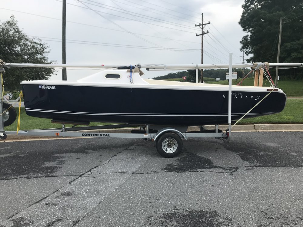

I just purchased a sweet 2014 h22. Trying to understand one rigging wire. I am not a real sailor.
The mast has three lines, the main line, a red line that exits the mast on the front above where the jib swivel connects and one fixed line to the rear of the mast to hold up the boom...
What it the line that exits the front of the mast?.. for a spinnaker?

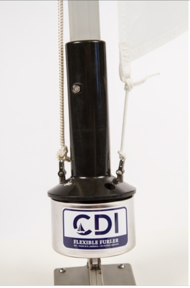

Not sure if his furler is the same, but mine has it’s own halyard that runs in a groove on one side of the luff tape extrusion, over a sheave built into the top swivel and then back down a the other side of the extrusion. You attach that end to the head of the jib and then pull down on the other end to run the jib up the furler extrusion. No attachment of sail to mast halyard at all.

I’m reading back through all the comments. I think granger has the right terminology for how mine works... “internal halyard on a roller furler”.
Clnhse, if that’s what you have then you done need the red line other than for raising a sail cover. The furler extrusion will have a groove on either side with a line running in one side up to the swivel near the mast.
If like the picture JViss posted, you’ll need the red line for raising you jib in the furler slot.
Feb 20, 2011
8,062
Ah... got it. Mine is a totally different design. I kinda like your better because you you can control headsail luff tension. (I’m not really an advanced enough sailor for that that matter, but I’m working on it! :)). On mine the headsail luff tension is fixed once the sail is set in the furler.
Goin' out on a limb here, but your's sounds like a CDI Flexible Furler 2.
Aug 1, 2011
3,972
requires a jib halyard to raise the jib
The CDI that is being referenced has that halyard internal, and not on the mast. The track has effectively two tracks, and the halyard rides inside the aft one, with the bitter end tying off the tack of the sail. (It has plusses and minuses, external to this topic) The CDI is also encapsulating the stay, and while it's function is the same as a larger boat, the setup and operation is slightly different, with the stay attaching inside the drum and the CDI assembly attaching to the thingee (I was on a roll there) on the deck.
EDIT: chainplate! It attaches to the chainplate on the deck.

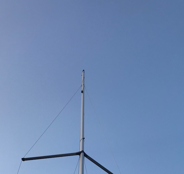

The Jib is permanently attached to the mast on a short cable with a swivel. The extra line is labeled as a jib halyard but I think it might be for a spinnaker? I could use it for the jib?
:plus:
Yep. Mine is just like that.
