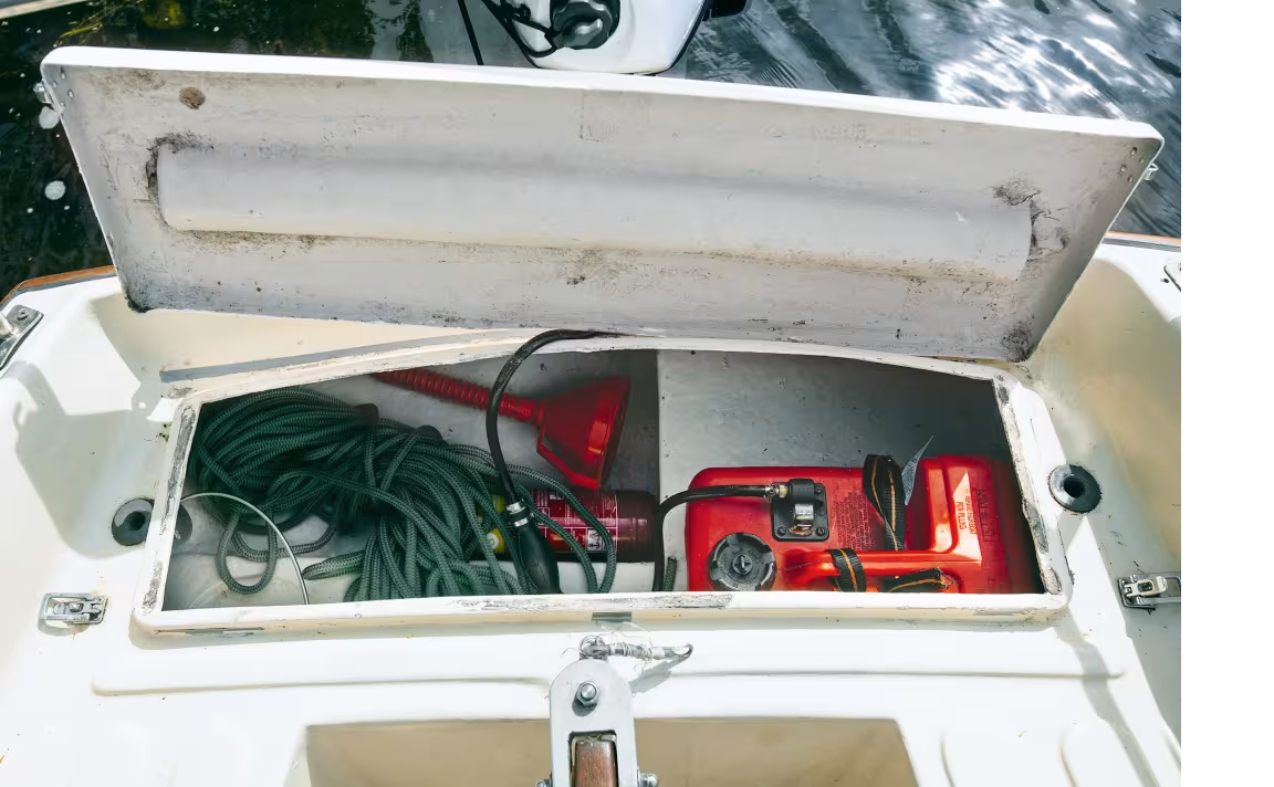

The rear locker where the tank would be stored is shown below. My worry about just running the fuel line like in the image (from Google) is that the outboard will suffer from fuel starvation if the line is pinched. On my boat there isn't an obvious point for the line to pass through.

Does anyone have experience of running fuel lines through the transom? What is best practice/equipment/hardware to use?
Easy decision regarding the sail pro; recommendations of two mechanics & excellent advice by an experienced sailor / owner @Joe. Agree with Joe that it isn’t a big concern with drilling thru the upper transom near the gunnel as long as you place a rubber grommet to make it water tight & to prevent chafing the fuel line. If you are hesitant to drill thru the transom, there appears to be a recessed area under the locker (where the red funnel is), where you can drill thru the deck. The fuel line would course under the recessed area, thru the deck, and over the transom . Again, use a rubber grommet in the deck hole.
I also like the idea of a fuel tank. You have extra fuel capacity that translates to fewer refills as compared to an engine mounted tank. When you get low on fuel, simply remove the tank & refill without needing a separate container as necessary to refill the engine mounted tank. A major advantage is if the fuel gets contaminated or if it becomes “stale” during a long off season lay up, its very easy to discard the old fuel & refill without removing the motor. Not sure if the sail pro has an engine mounted filter, if not, install a simple inline filter in the fuel line. And, don’t fret about the hole. You’re a normal sailor; always hate to drill a hole in your boat!
This image was taken from Google, it isn't my boat unfortunately, and the transom locker varies as they were in production from 1965 to 1990 - an estimated 4500 were produced, so there were tweaks and updates along the way.

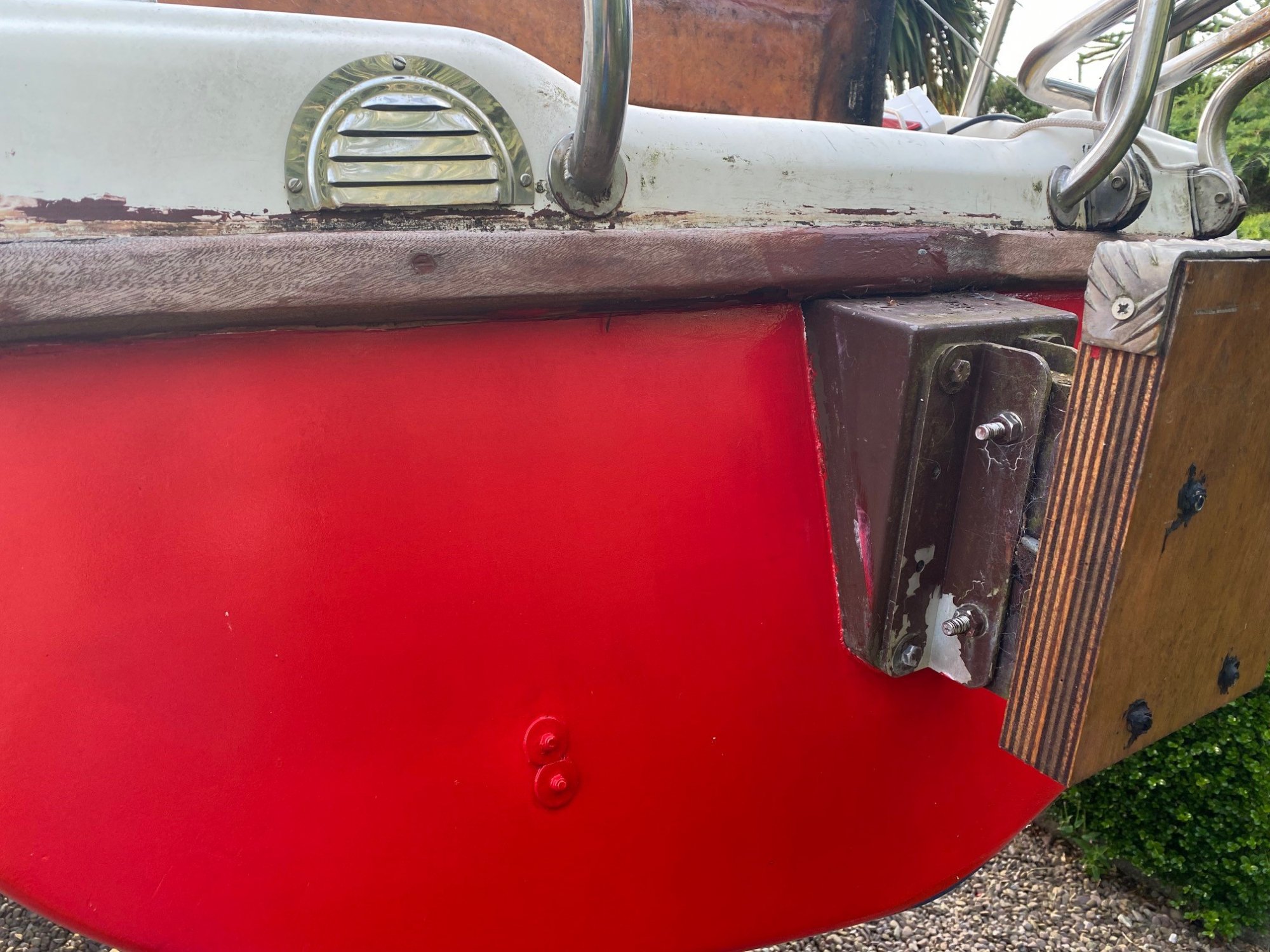

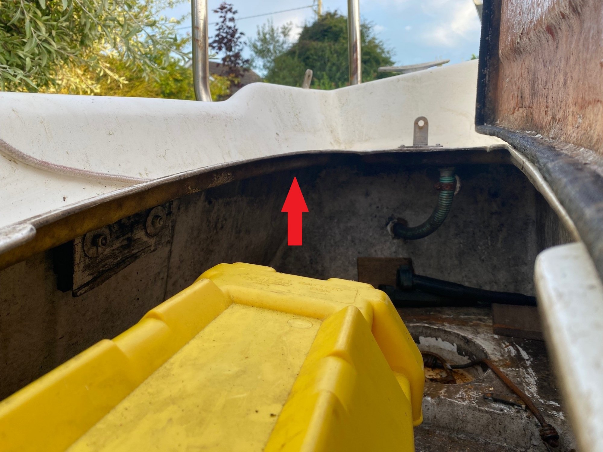

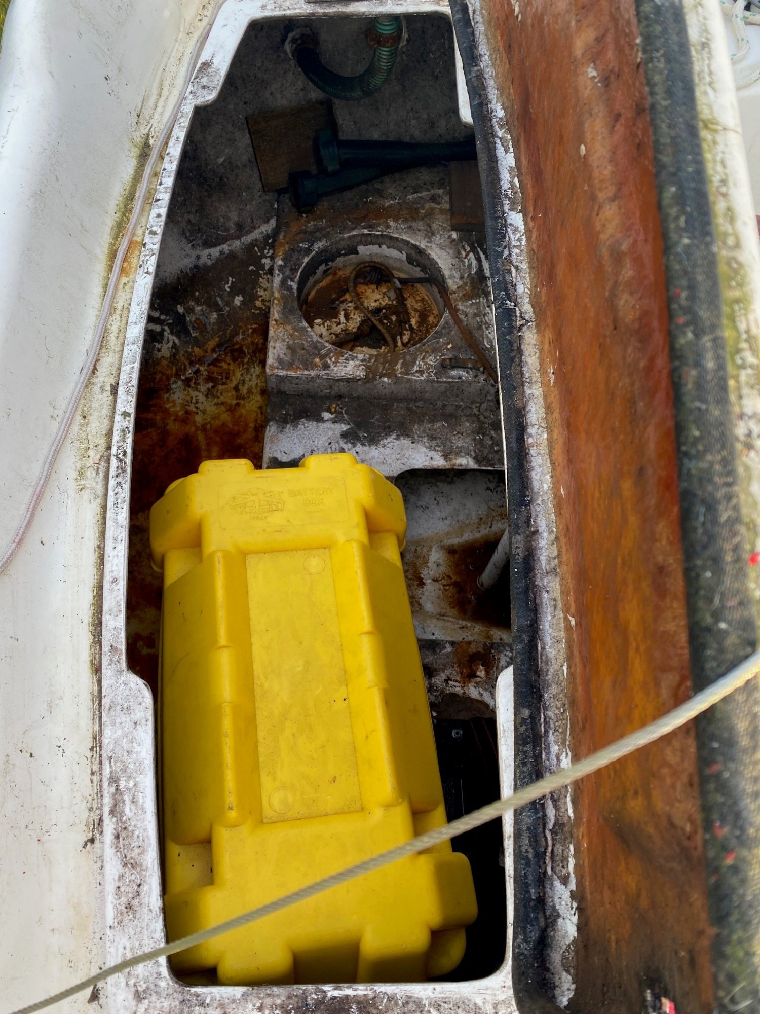

Please ignore the filthy locker - it has been low on my priority list so far!
The vent location is where the red arrow is pointing, so I know that is too far up. The waterline sits a couple of inches below the lowest point on the transom. The locker door/cover sits very snuggly against the rim of the locker, so pinching of the fuel line would definitely occur if I tried to just run it through there without cutting anything out.
The battery box is just temporary while I'm working on the boat, I know I'll need to seal that off separately to prevent possibility of spark.
I don't understand why these boats weren't built with a lower vent to begin with, as the circle cut of visible was originally forholding a propane/butane gas tank, and that was originally routed through to the cab where there was a two burner stove.

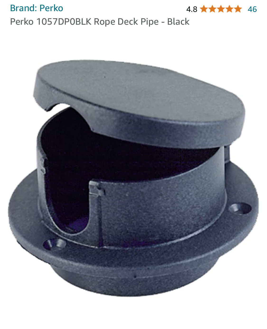

Here is one example by a boat owner using a Perko rope deck pipe
The hole pipe and cover look like this.
this one is plastic. They are also made of metal. This approach would allow you to pull the fuel hose in or out of the transom.
