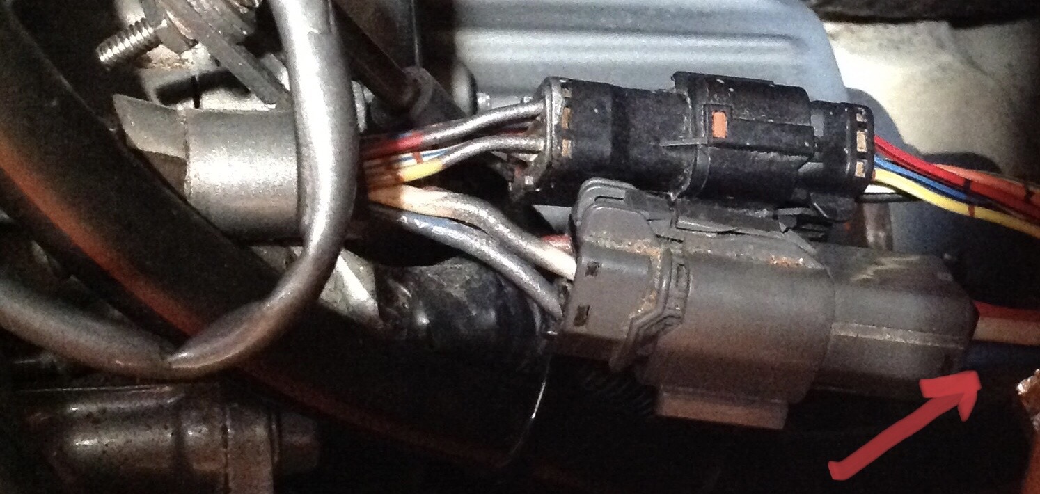

Reading your link (thank you very much by the way)….
From your response #18 ( These factory start relays are usually located right below the starter motor bolted to the engine block. You could pay Yanmar about $80.00 for one or grab one at any auto parts store for about $15.00 to as much as $34.00 for a premium Cole-Hersee.)
Am I correct, that if I get the Start Relay and mount it at the starter…..I would the have to splice a length of wire to each of the 3 wires (Red, White, Blue)that are in the 3 wire connector just before the starter now, from the push button.
Then connect them to the relay and from the relay to the starter.
This would eliminate the 3 wire butt connector, which I think is the problem all along. And in essence make a solid run of wires from the button to the starter.
It took me a while but I did find a picture from this site of the very same butt connector I am referring to. It is the same 3GM30F Yanmar as mine. And the only connector, I can see, from the Push Button to the starter. Thats why I feel it is the issue. Red arrow, I added, shows the 3 wires from the push button.
I hope I have this right and you can understand my logic.

You may want to look in the forums for a posting from August 2017 “Yanmar 3GM30F Wire Connector”. this may answer some of your questions. I think you may have even shown a photo of my broken “extension harness” in one of your comments.
Sorry I don’t have any photos to show as well. But it would be good if someone does have a photo of their replacement of that Extension Harness. A picture is worth a thousand words.
My “guess” is that is a major source of your intermittent starting issue. More than the switch itself. As well as the fuse holder just before it. The second weak link in the chain. Now that “fuse holder” may be anywhere in the line, depending on the installation at the time. That’s the treasure hunt, to say the least.
Also check “Leslie Troyer“ and “Geek guy“ responses in the same post. They expertly help clear up the cutting of the harness wires.
I hope this helps you in some way and stops your boat from “not” starting. How frustrating is that!
