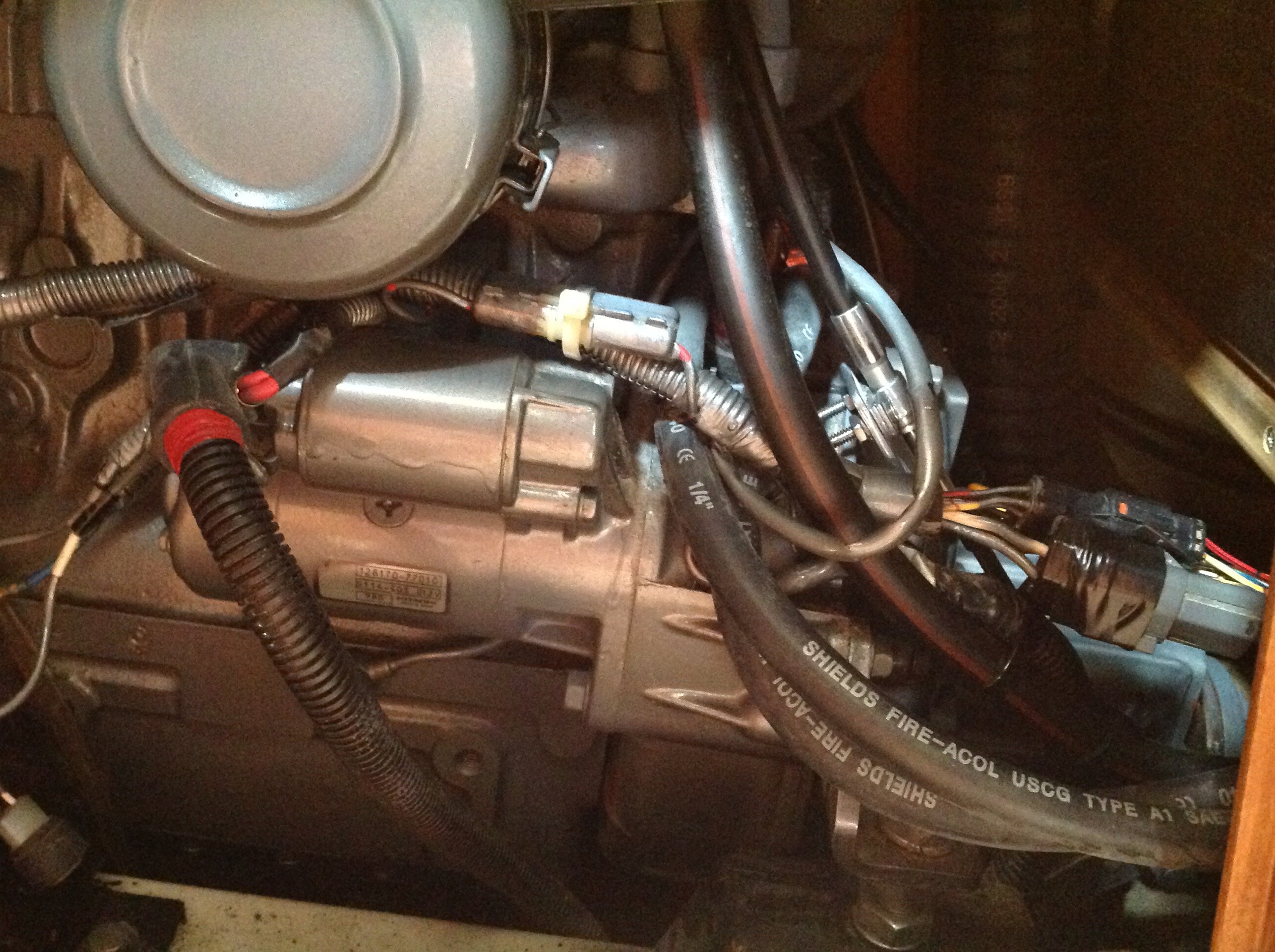

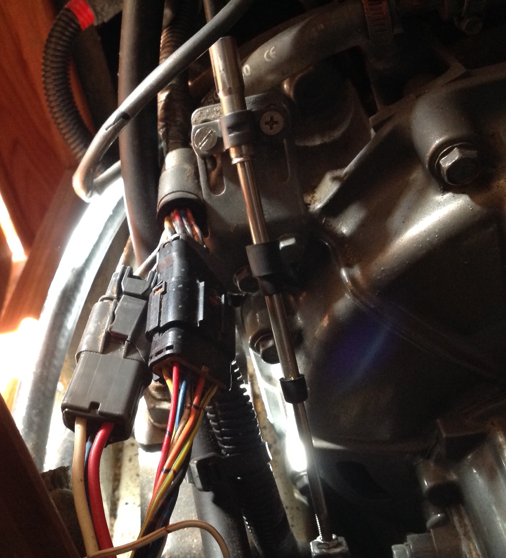

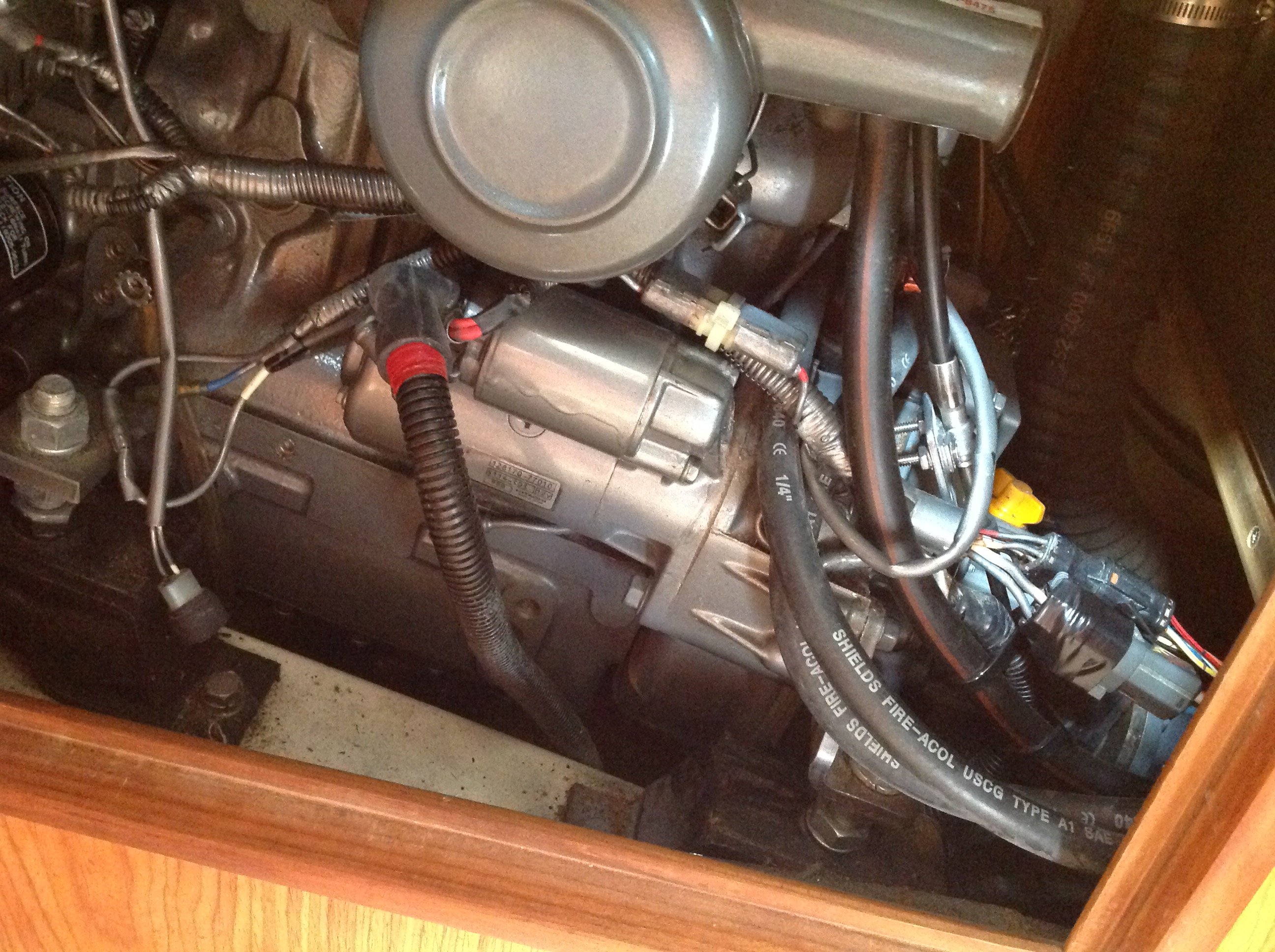

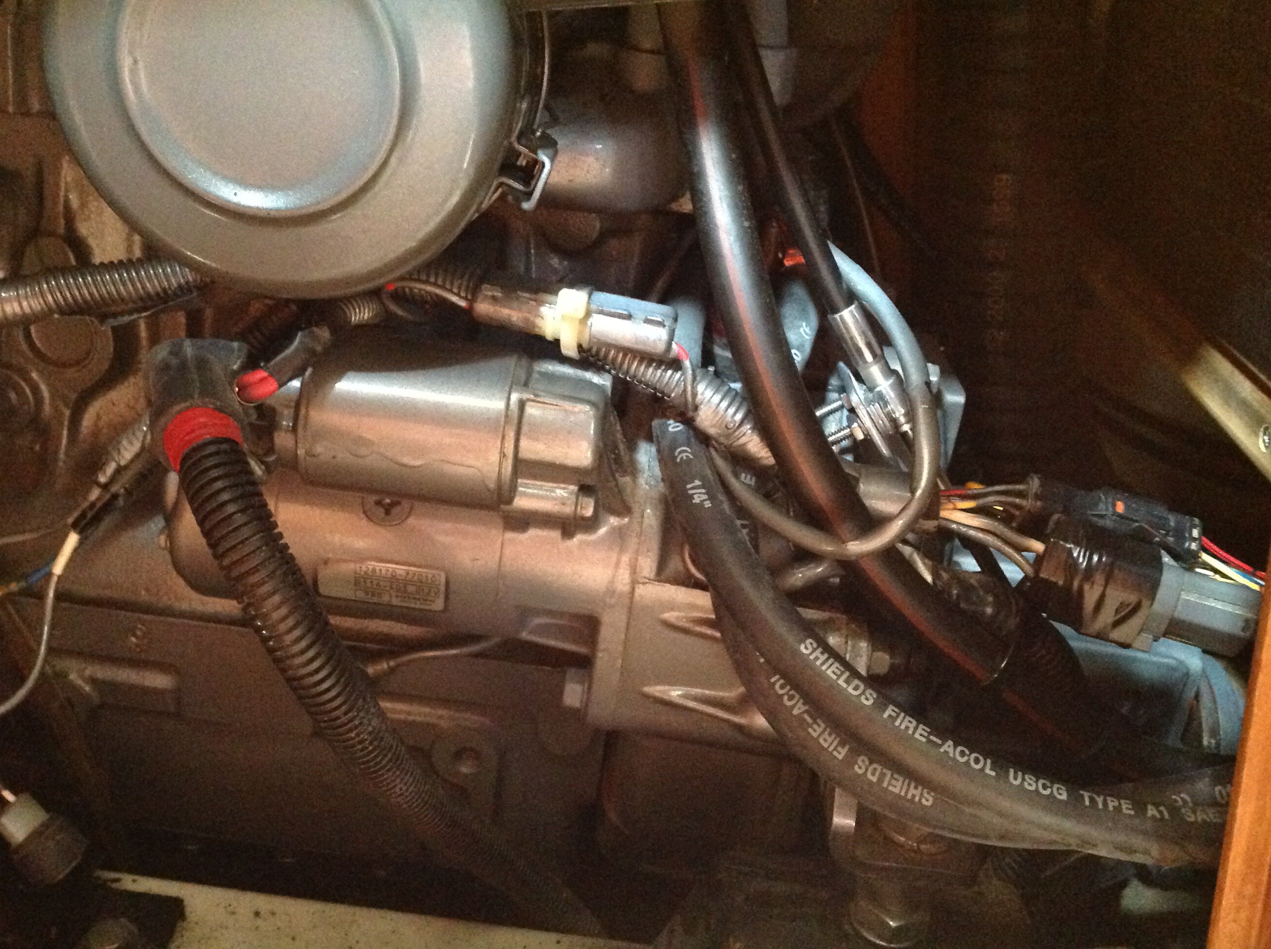

After replacing the Yanmar starter button on my 2000 340 because of intermittent starting issues I found this wire connection. Reading all the posts relating to Yanmar's wiring issues, I traced all the wires to see if any deterioration of the wires, as many have said could be a further issue.

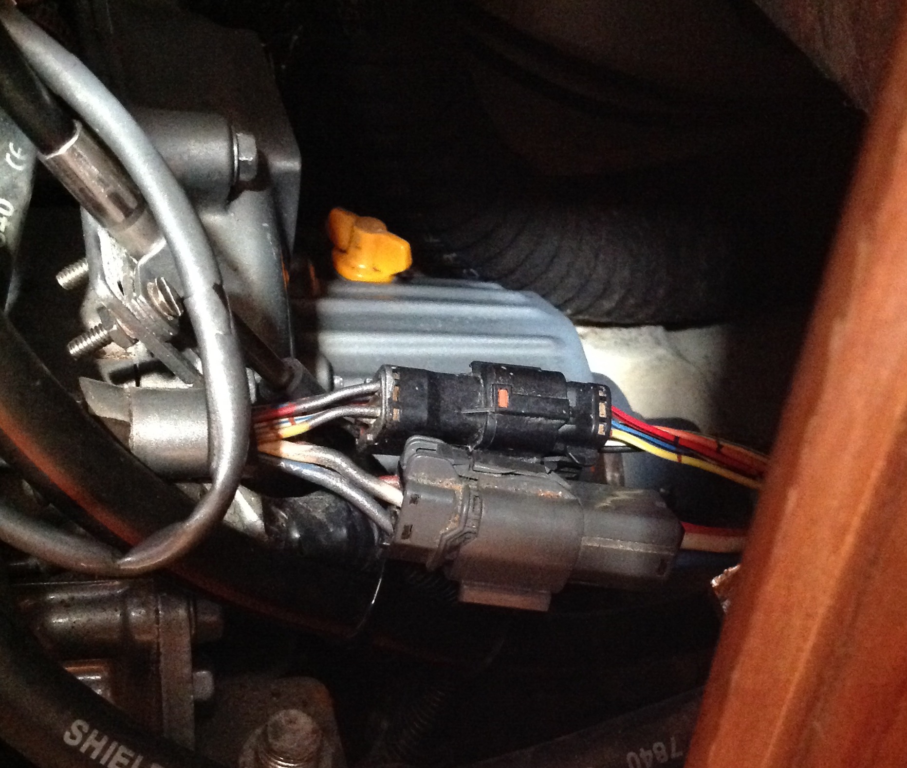

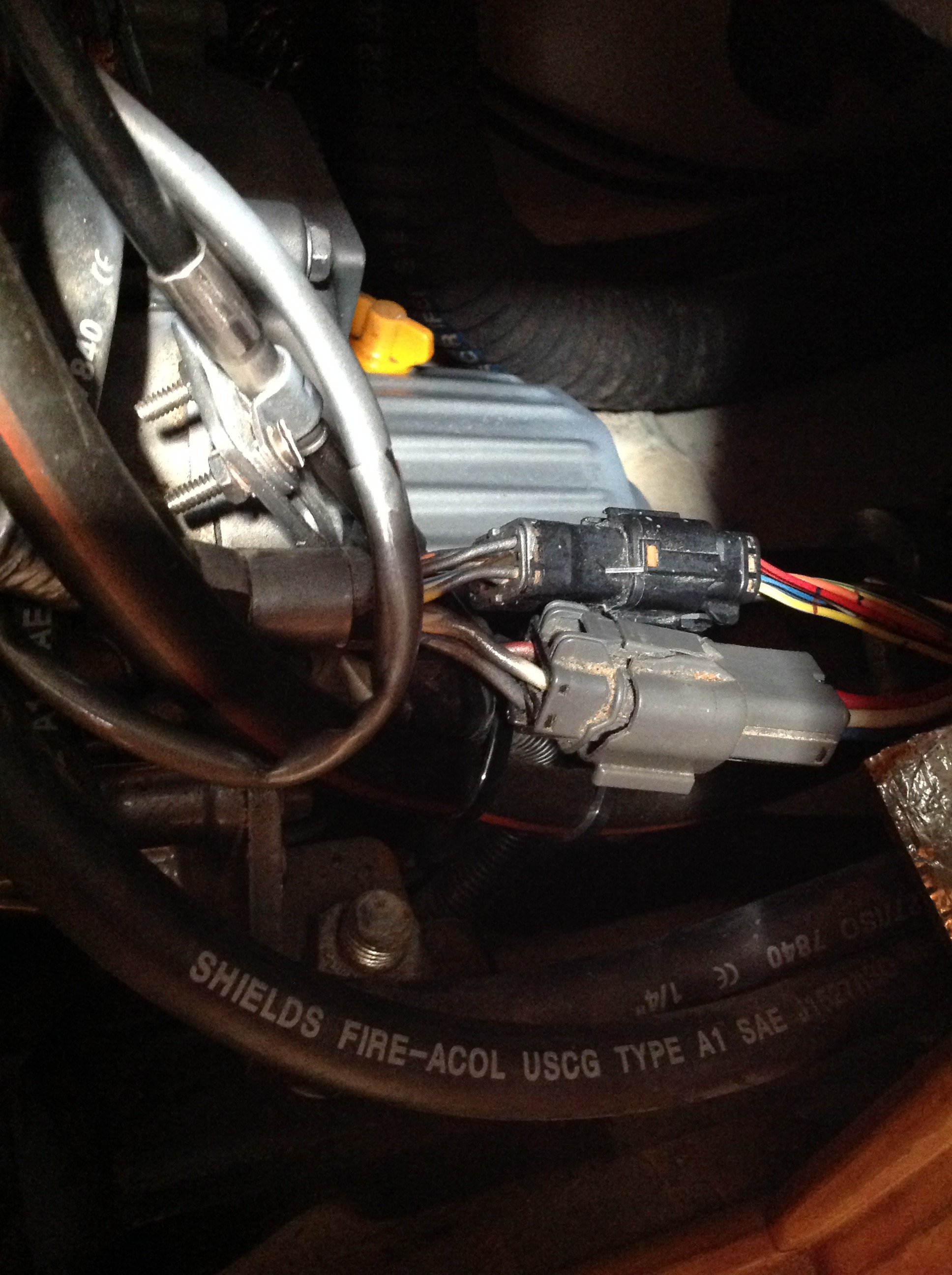

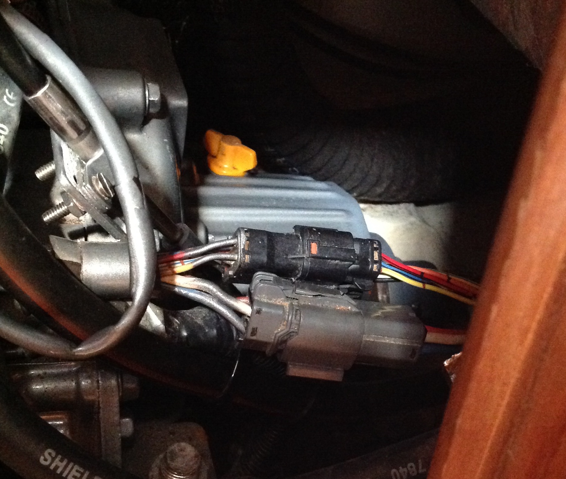

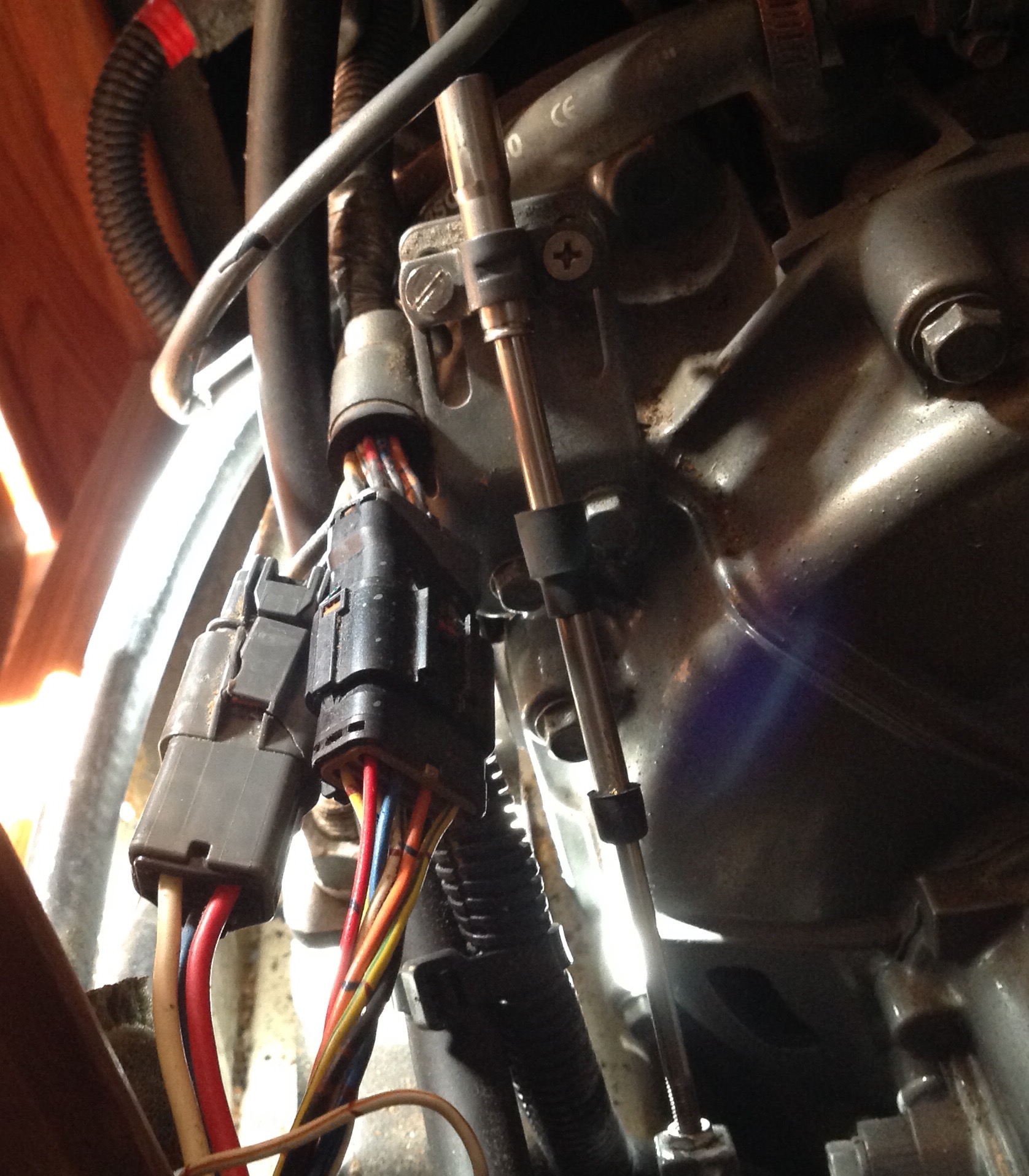

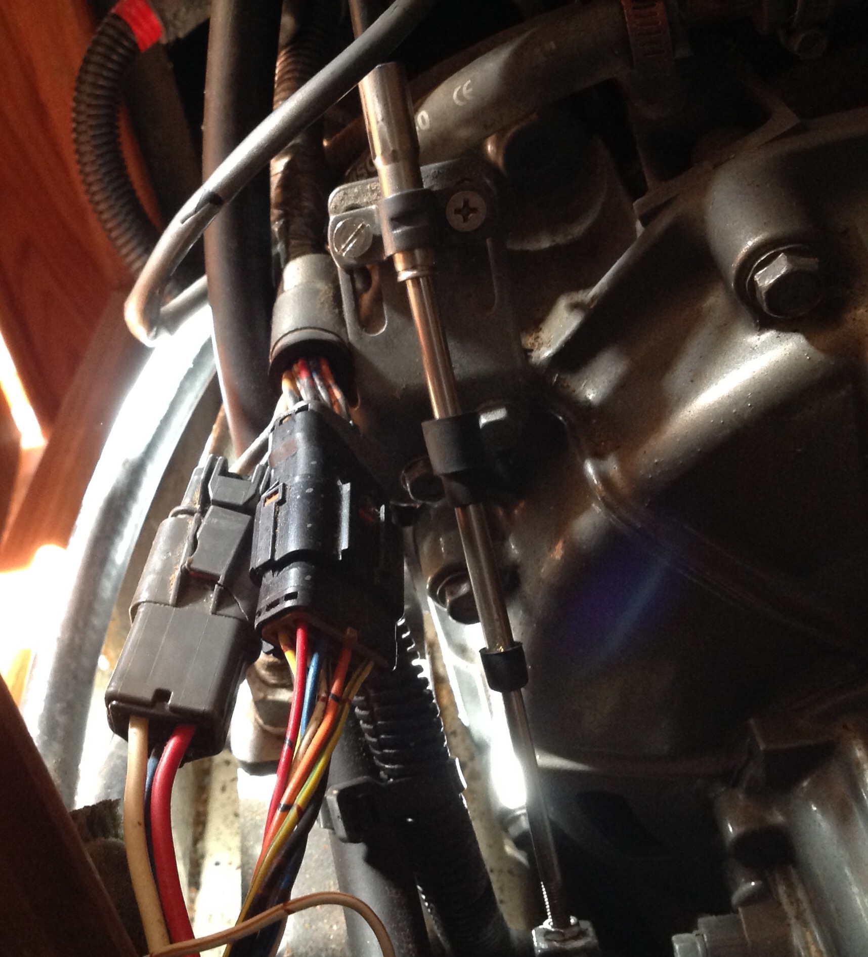

As I said, I found this cracked 3 Wire to 2 Wire Connector, pulling apart from each end.

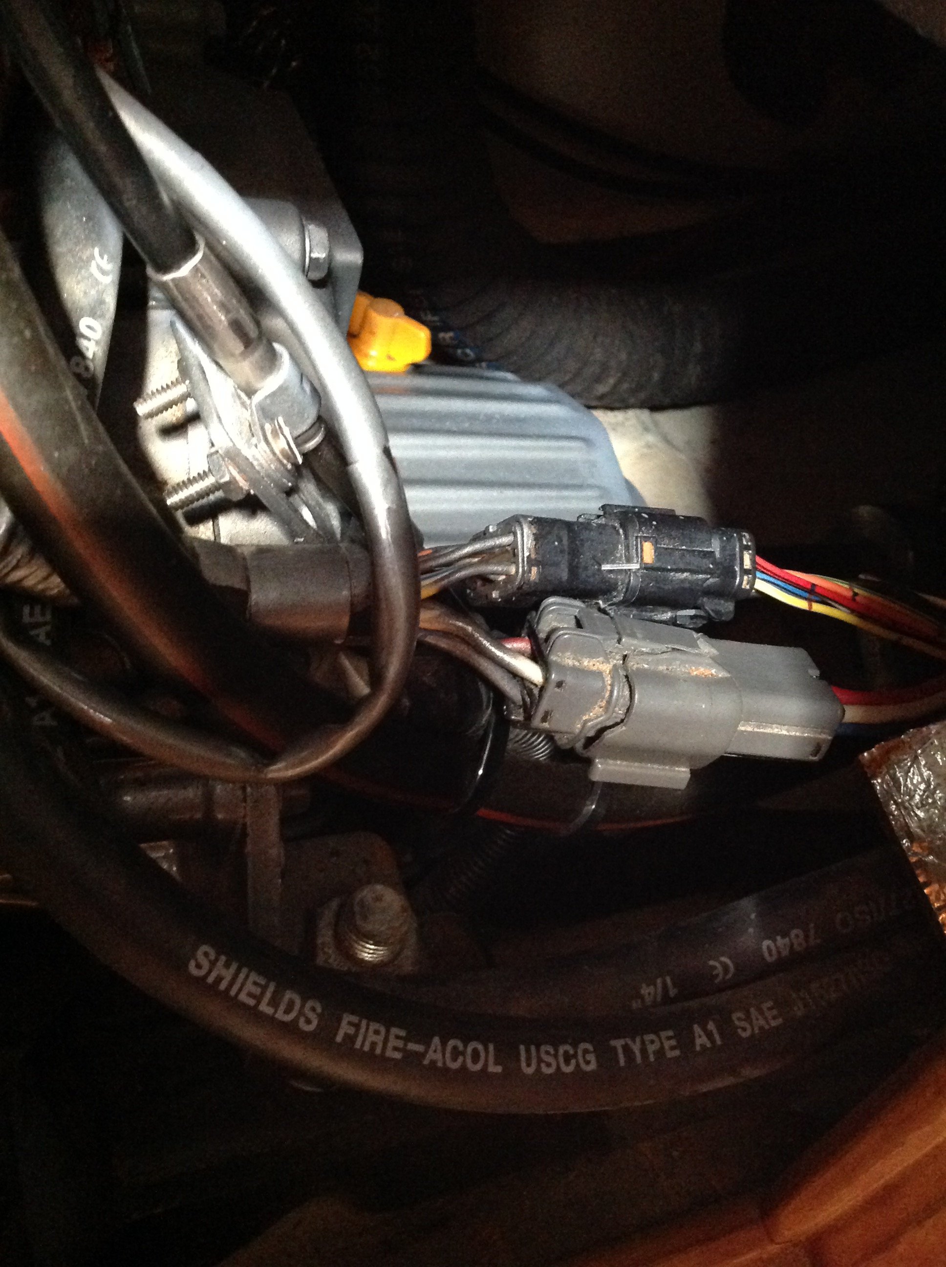

I checked inside and it's a series of bayonet type connectors. After pushing it together, I taped it until I can get another.
Now, what is it called, where can I get another one and will a new one come with long leads on each end?
Has anyone replaced one like it on their boat?
Thank you for any help you can offer.
