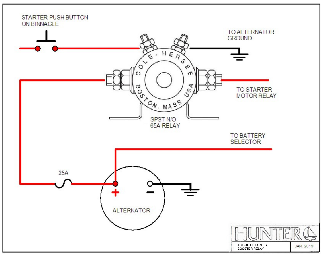

This may help:

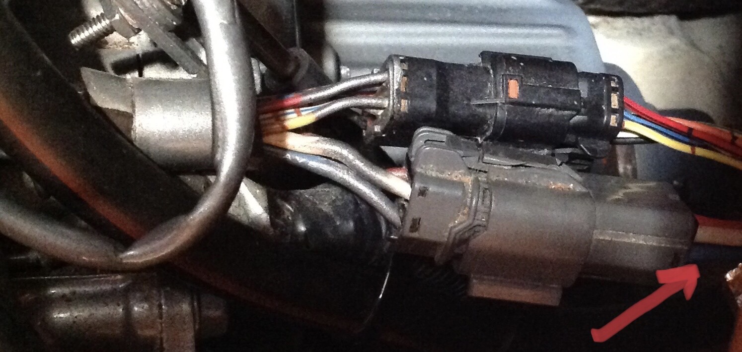

Am I correct, that if I get the Start Relay and mount it at the starter…..I would the have to splice a length of wire to each of the 3 wires (Red, White, Blue)that are in the 3 wire connector just before the starter now, from the push button.
Then connect them to the relay and from the relay to the starter.
This would eliminate the 3 wire butt connector, which I think is the problem all along. And in essence make a solid run of wires from the button to the starter.
I am sorry I don’t have a photo to show you but I will get one.
It took me a while but I did find a picture from this site of the very same butt connector I am referring to. It is the same 3GM30F Yanmar as mine. And the only connector, I can see, from the Push Button to the starter. Thats why I feel it is the issue. Red arrow, I added, shows the 3 wires from the push button.
I hope I have this right and you can understand my logic.
