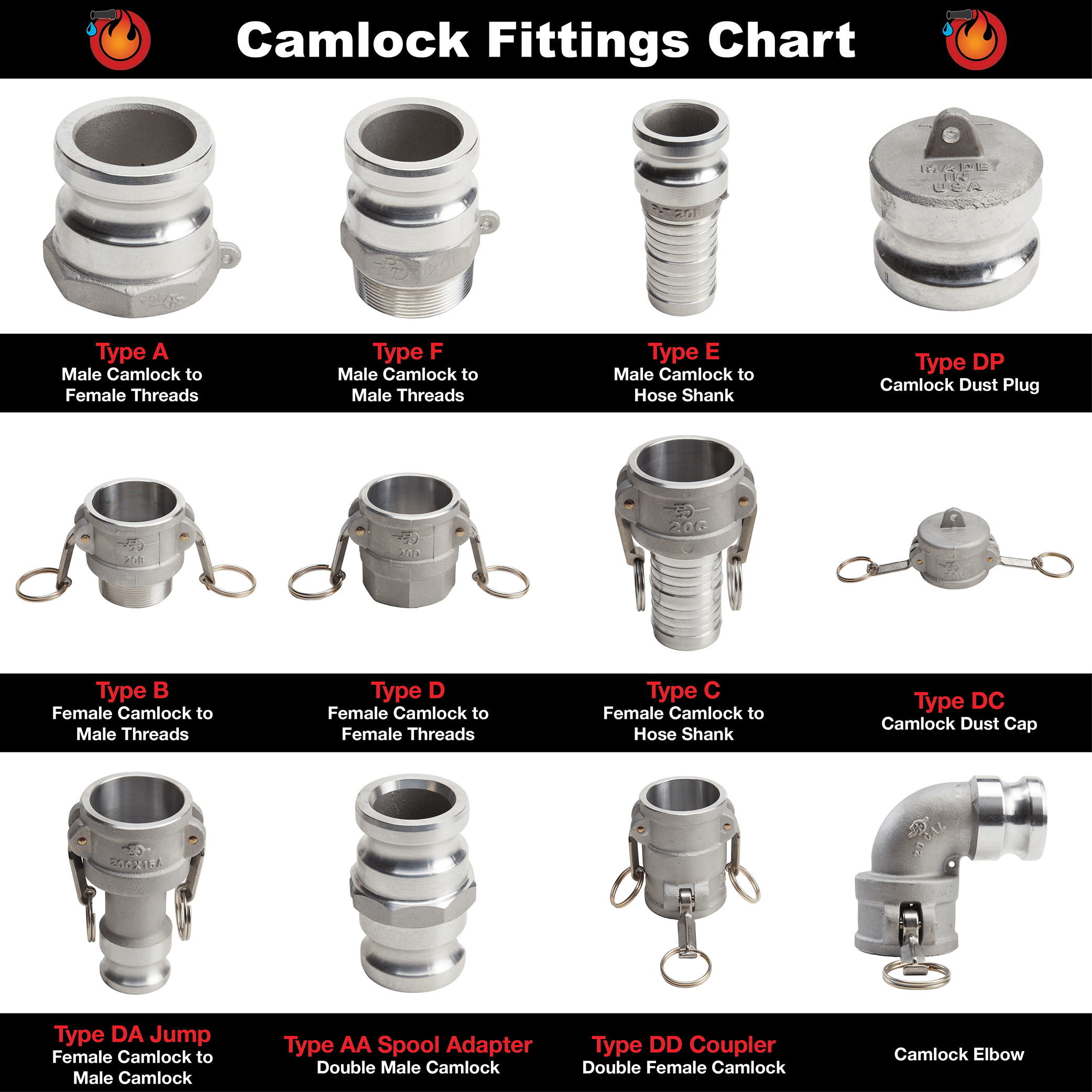

Really, nozzle seals are the bigger problem. A tiny air leak destroys vacuum and flow rates. Easy to solve too, but boaters don't like the answer (an installed camlock).
Absolutely the worst invention in the pumpout industry. Edson should know better. Yes, using the nozzle saves a minute or two over using a cam lock and cam lock fittings can't swim, still they were better than the nozzles especially after the nozzles have worn a bit and leak.
Forget the hose, build a better nozzle.
Mar 26, 2011
4,050
Corsair F-24 MK I Deale, MD
Should we blame Edison? Or the boat builders that have not provided a proper fitting at their end? Edison is just trying to match up to what they are faced with.
On my PDQ you were free to screw in a 1.5-inch male camlock (all of the deck fittings I have seen are internally threaded for 1.5-inch NPT pipe), and the Maryland pump outs have a 1.5-inch female camlock just behind the nozzle; just screw in a male camlock, pop the nozzle off the pump-out hose, and you have a perfect vacuum and pressure tight seal. Camlocks are the industry standard for pumping waste and many industrial chemicals because they are durable, reliable, don't clog or easily get buggered up, and universal. But the camlock is not flush with the deck, so you would typically screw it out and replace it with a deck plate, for looks and to avoid tripping. Camlocks are what you will see on most commercial pump-outs, such as ferries etc.
One solution would be to mold a recess into the deck to allow a flush male on the boat side. Or better, just place it out of the way and let the male stick up--I would have fine with that on my last boat, since the fitting was in a corner. It would have worked better. But appearance rules the market over function. What you do not want is a fussy fitting that will get clogged up with poop.
You can get pretty much any combination of threads and size, and you can get them in most plastics. Cheap as chips and industry standard. For example, you can screw type F into your existing pump-out fitting and and seal it with type DC. I did that for a while.

McMaster has polypropylene cam lock fittings for under $5 for eighteen 1 ¼ " or 1 ½" threads. It is what I used when I built my 12v portable pumpout. The female cam lock sockets are around $12. Pretty cheap. The cam lock plugs have a hole to attach a floatation device, aka an empty soda bottle.

That is why the fittings have internal threads. My PDQ actually came with a camlock from the factory.
To avoid getting sprayed, remove the hose slowly, and cover the gap with a towel. In refineries (wearing very heavy gloves) you learn to place one hand over the gap on your side to deflect any leaks into a waiting bucket, or at least, away from your face. I always wear gauntlet gloves for pump-out.
