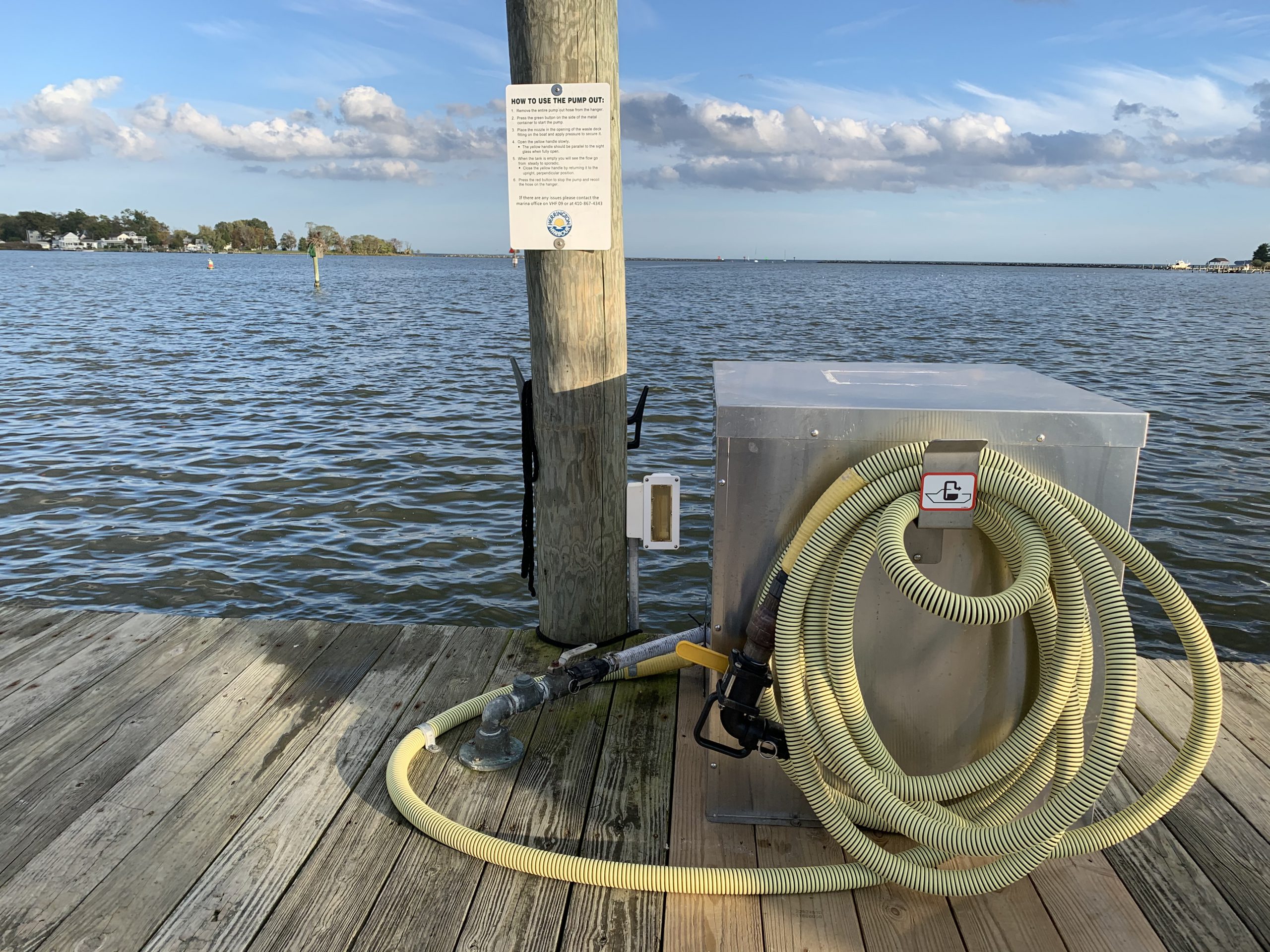

This is common in Maryland. Looks the same. Very easy to use, by my measure, but some people feel differently. I don't understand what they expect. Commonly they are the same folks that think laying it on the ground is too difficult and then wonder why it does not work.
In MD the pump outs are many places, but they are not carts and they are mostly not at the fuel dock (congestion). A cart is bound to be a heavy beast
