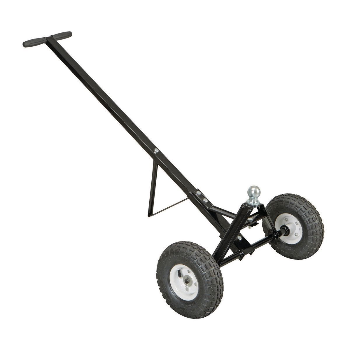

Here's another option. We used these at my old sailing club to launch the Lido 14's and Hobie's . Easier and faster to handle. Store in boat or pick up bed, You'll love it.

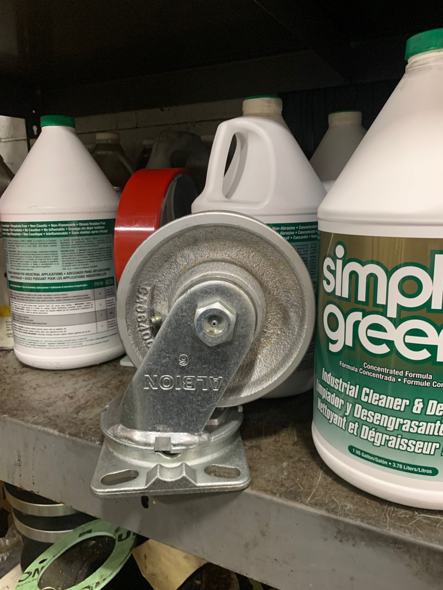

With our Oday 25 being rather heavy to say the least , I tried to use the trailer jack to move the trailer around .
The pin that allows the jack to pivot horizontally bent and came out of the locking holes almost immediately .
So I mounted a rather substantial pivoting caster right beneath the jack . I made sure the caster sat lower than the jack so I trailer tongue would contact the caster and I could still pivot the jack . The caster is rated for 10,000 pounds

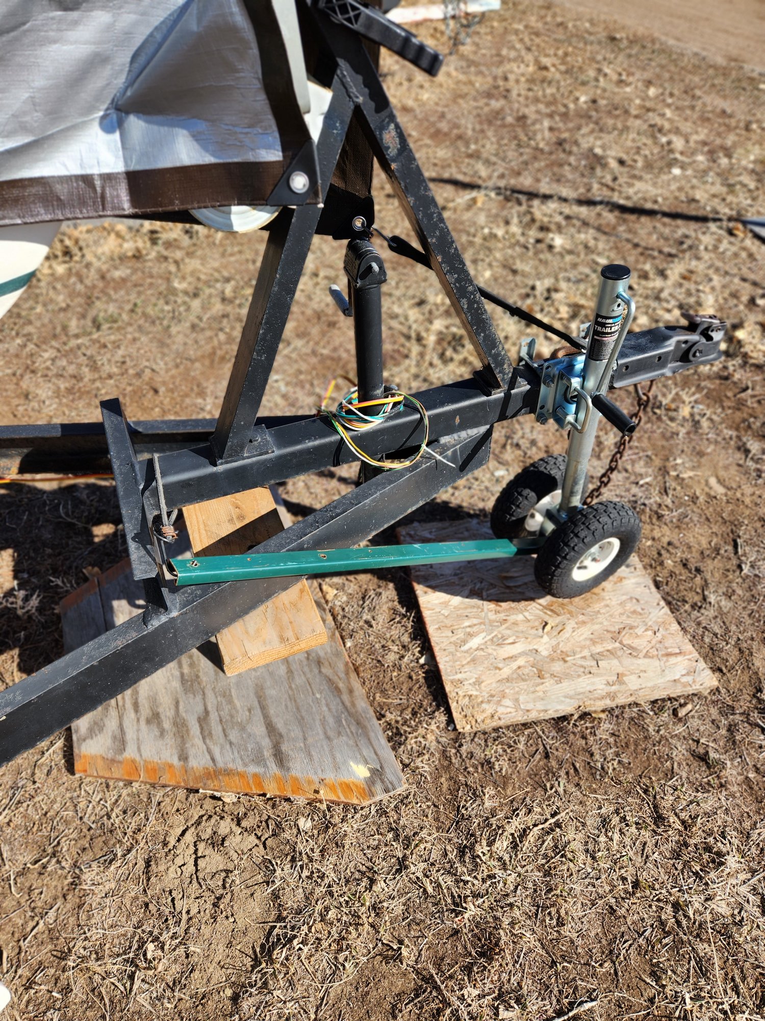

After breaking a plastic wheel on the tongue jack in those drainage grooves, I replaced the inner plastic wheel with two external pneumatic wheels with bearings using 1/2" threaded rod and a spacer in the yoke where the old wheel was. I use the green "handle" to steer the empty trailer for recovery. I did sacrifice tilting the wheel out of the way, but I have enough clearance when fully retracted and get about 330* of rotation. BTW, this is still a work in progress.
