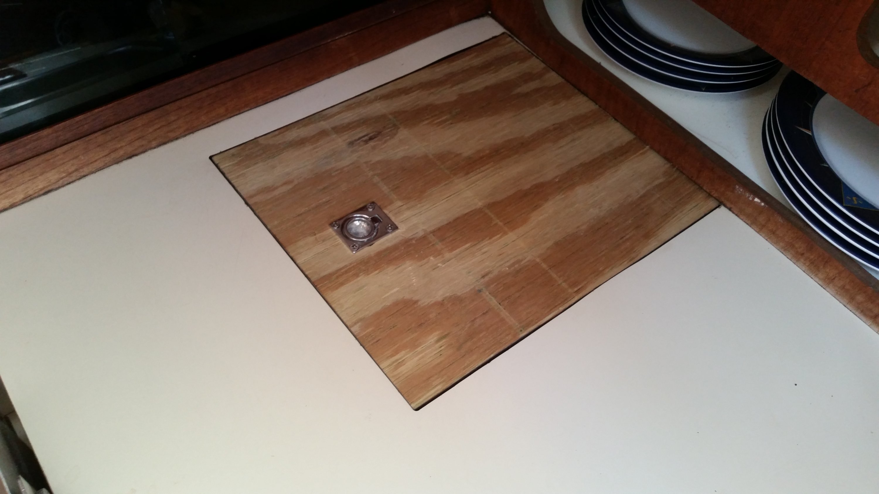

I did this for the same latch on my replacement icebox lid.

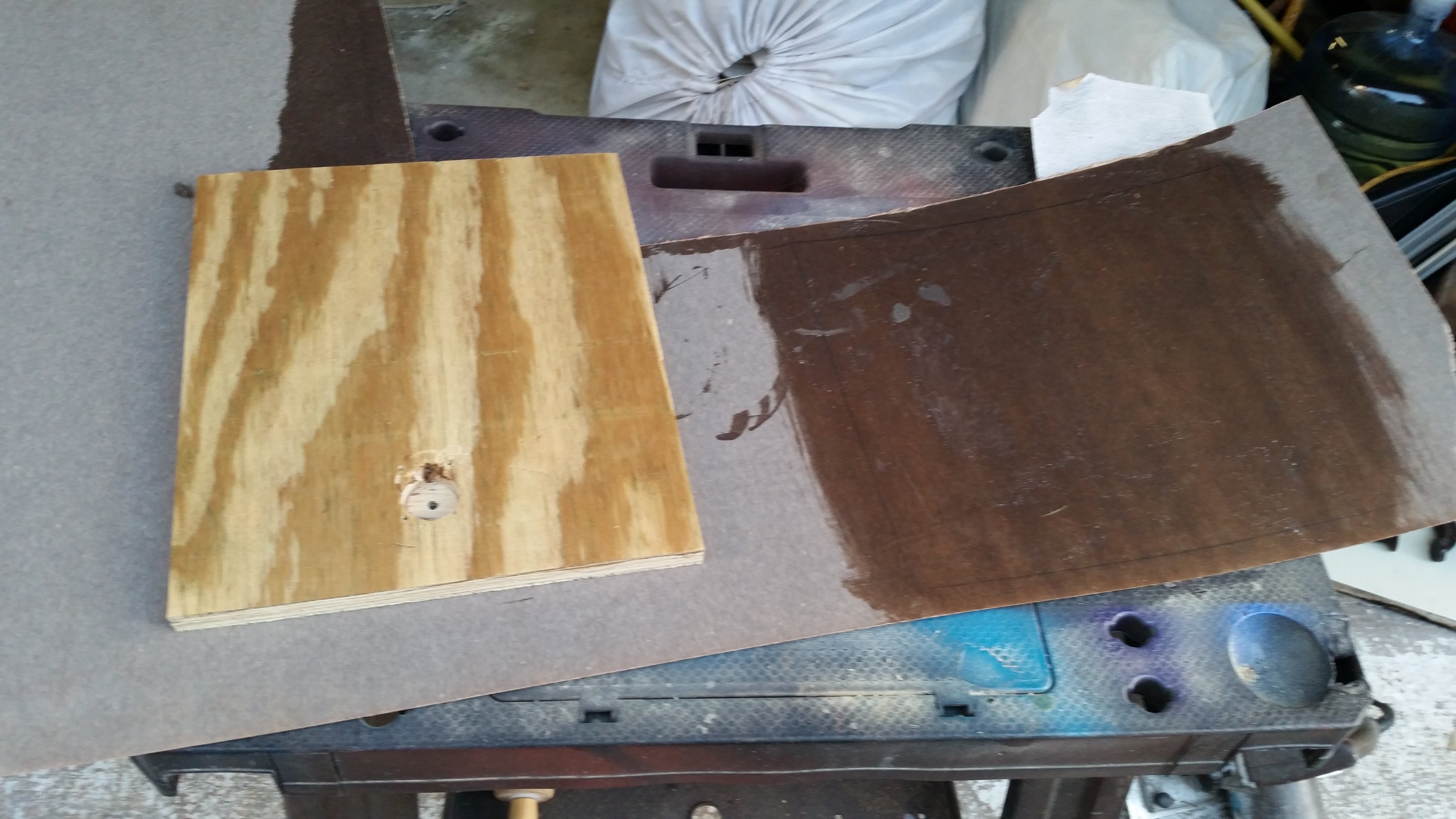

Measured the thickness of the hatch, and drilled a pilot hole to the correct depth to not penetrate. Then used a spade bit the diameter of the latch back to drill partway down to the pilot depth

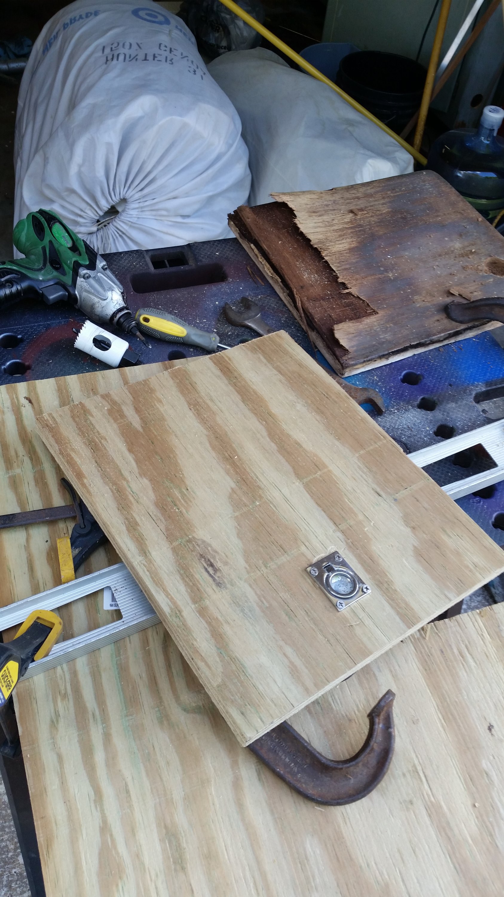

Test fit the latch and used a dremmel tool to round out the bottom without going beyond pilot hole. (that is the old rotten hatch in the background on this photo)

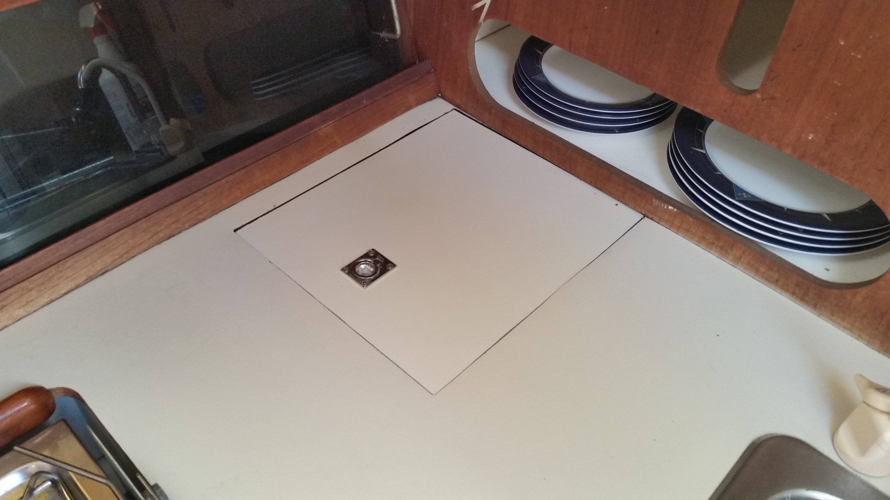

Test fit the entire hatch:

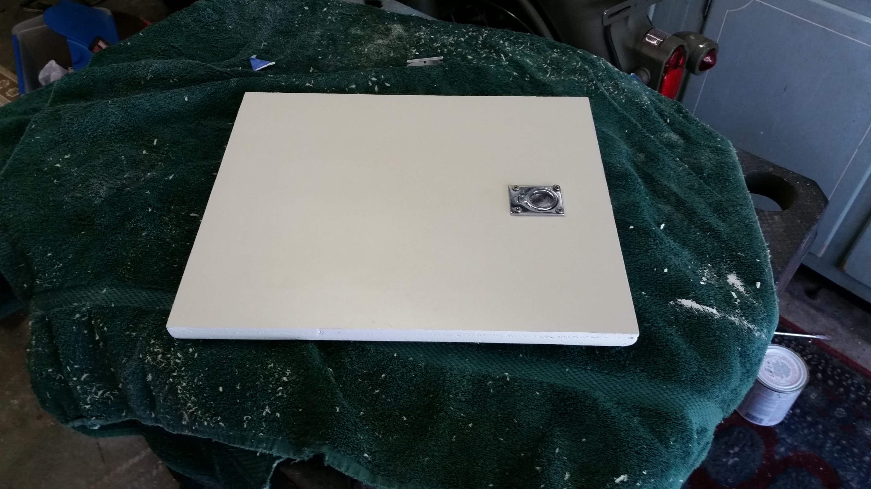

Covered in matching Formica, and white epoxy paint on the bottom. You can see the hole for the latch in the left picture.
