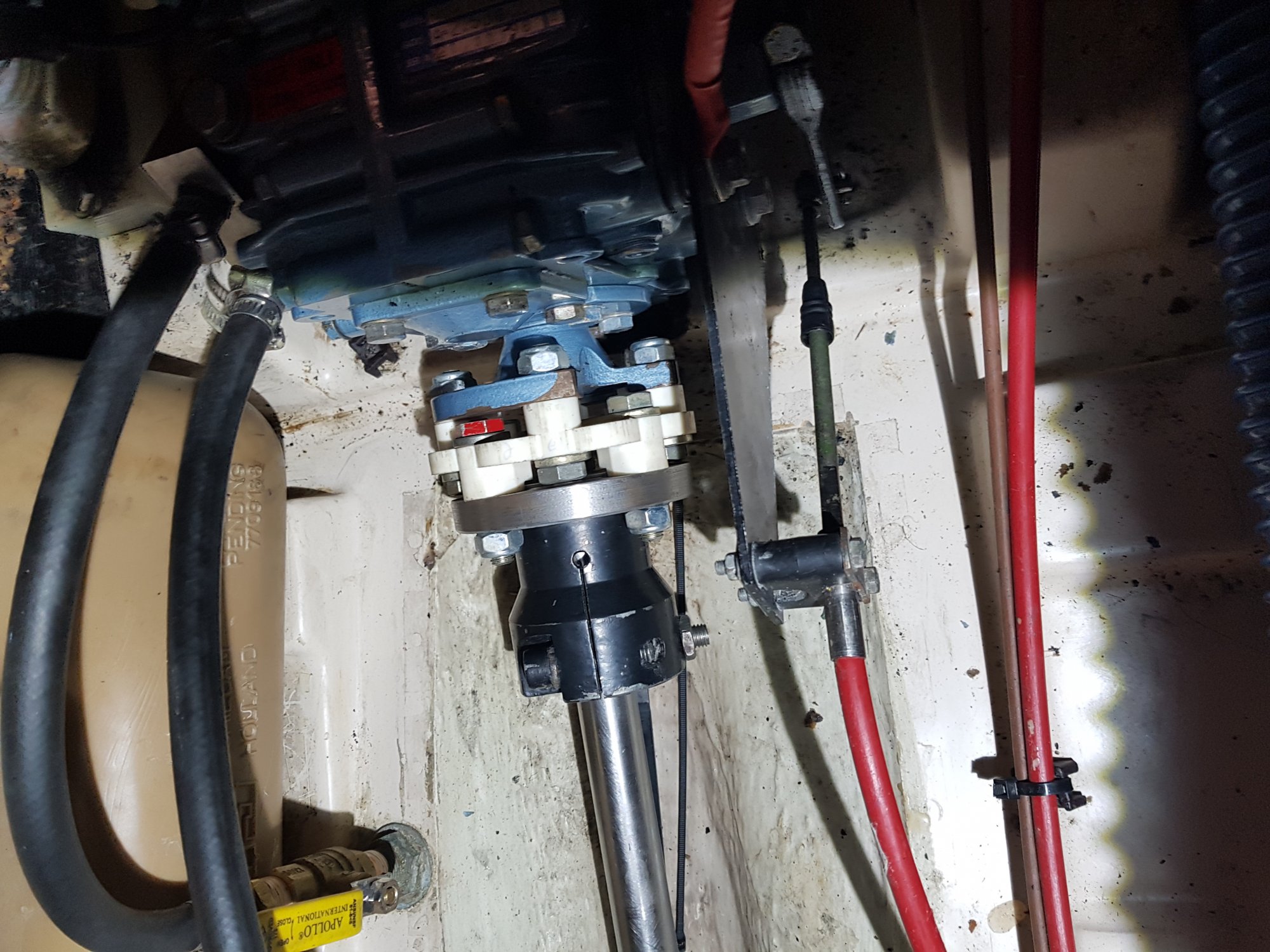

Here's mine installed. the red bolt is for engine alignment ,you put a feeler gauge between that and coupling half ,take readings at 12 and 6 and 3 and 9 all the same your engine is in perfect alignmentI wonder If there would be enough clearance to prevent my prop in the folded position from hitting the front of the rudder...Not a bad idea for all of the other benefits mentioned by Mechone.
