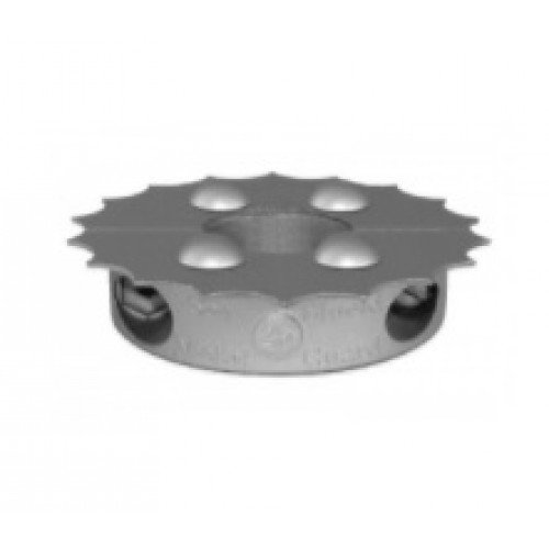

on the same topic: I have Beneteau 43, 2008. I used to put a collar zinc on the shat and a prop zinc. However, sailing in the NE finally convinced me to add a line cutter to the shaft and now there is not enough room for a collar. The standard prop zinc by itself does not last the season. Does anyone know if there are larger size prop zincs available?
The size is the size. You should've known better when you bought a French boat :biggrin:
That said:
DPW
Feb 9, 2017
40
Beneteau 43 Hingham, MA
Vive la France - that said, love this solution if it works with my cutter. Thanks for quick response!
Feb 26, 2011
1,440
Achilles SD-130 Alameda, CA
No, you miss the point. This is an anode with the cutter attached as an integral part. When the anode is depleted you replace the whole thing.
