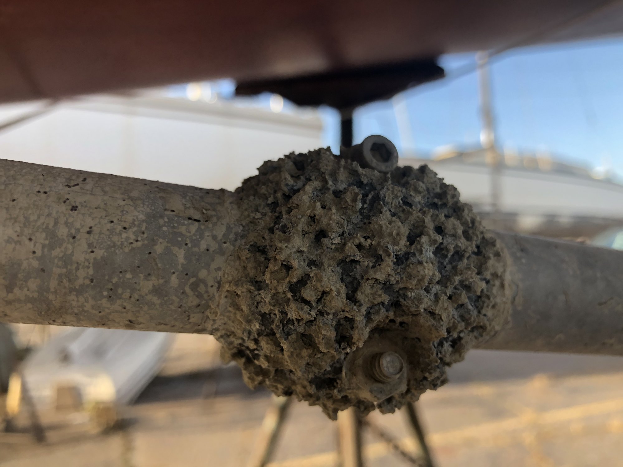

Has anyone put a zinc donut on prop shaft on 321 with Yanmar. I know that one goes on the nut (25mm) but there looks to be a small gap in front of prop. Boat is 1400 miles away right now but wonder has any put one in this spot?
Hi Doug,I use a shaft collar zinc between the prop and the skeg on my 323, just left space for water to get to the cutlass bearing.

That is what I use. I have one laying around the condo somewhere, but i think it is just 3/4 thick. I have pics of Doug's prop, and his zink looks somewhat buldged. With the screws being a bit long, I bend them so they can't unscrew and dump the zinc in the briney deep. Not sure that is is "Euro", though.For Beneteau the only one that fits is Martyr anodes 25mm for your boat and it must be euro style and its available in zinc, mag and alum .Euro style is thin to fit between prop and skeg and still allow water to exit cutlassView attachment 188267MARTYR Aluminium Euro-Style Thin Collar | West Marine
