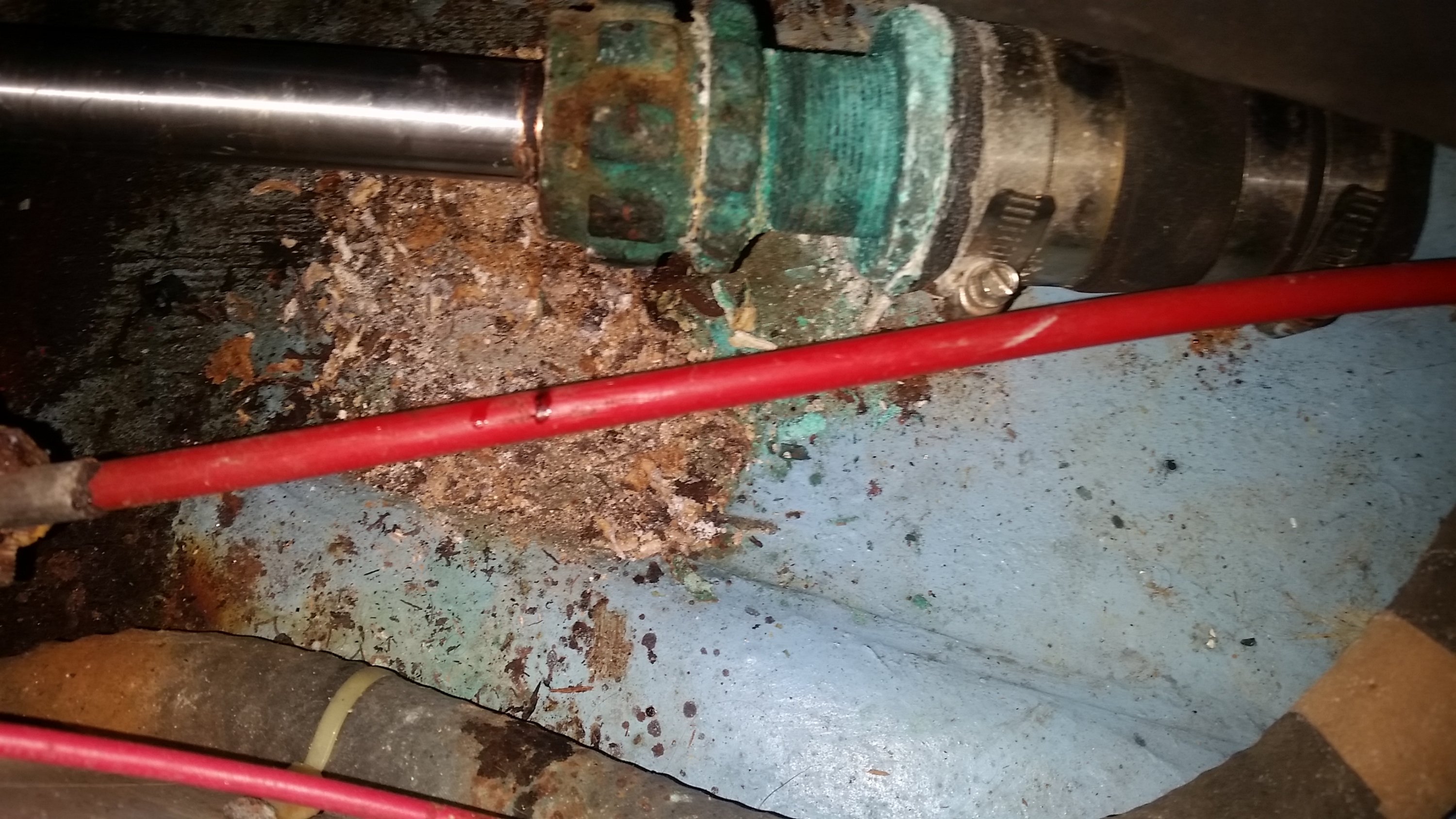

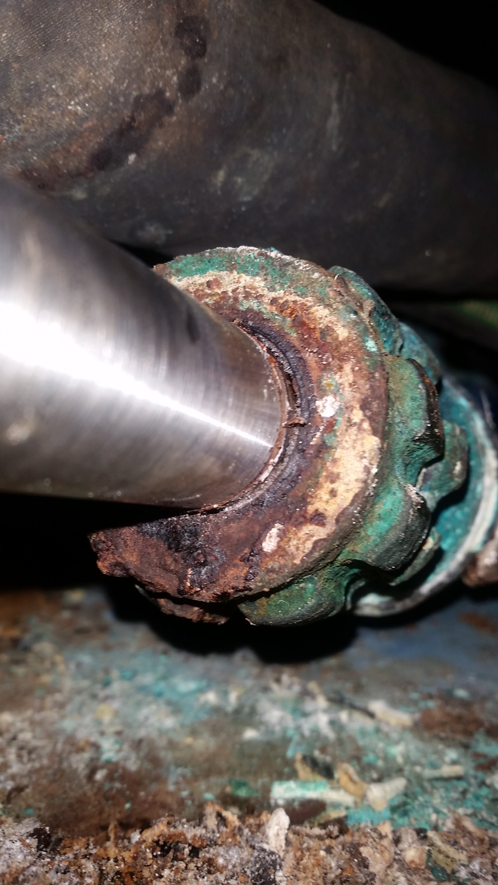

Wondered if anyone can help me out with this, long post i suppose but im looking at buying an 87 oday 322, boat seems to be in really good condition, above the water and had it hauled out to check underneath, no blisters or keel joint cracks, there seemed to be a bit of play in the cutless bearing maybe 1/16", when we took it out under power the prop shaft from the motor to the stuffing box had a lot of vibation there also is debris under the stuffing box what is this ( is this debris normal ) anyhow i had a guy who is a mechanic check it out and he was all doom and gloom, this is what he told me it would need, cutless bearing replaced, possibly the pilot bearing in the motor may need replaced, most likely engine mounts need replaced and could need work on the shaft or engine aligned, said it could cost $7500 to $12500 and because of that it should be a total loss! anyone had any of this work done and could tell me what it cost? I offered $10k for the boat before i found this out and they accepted the offer, the boat was donated to their foundation, any help appreciated, will try to post a video or pics of the shaft

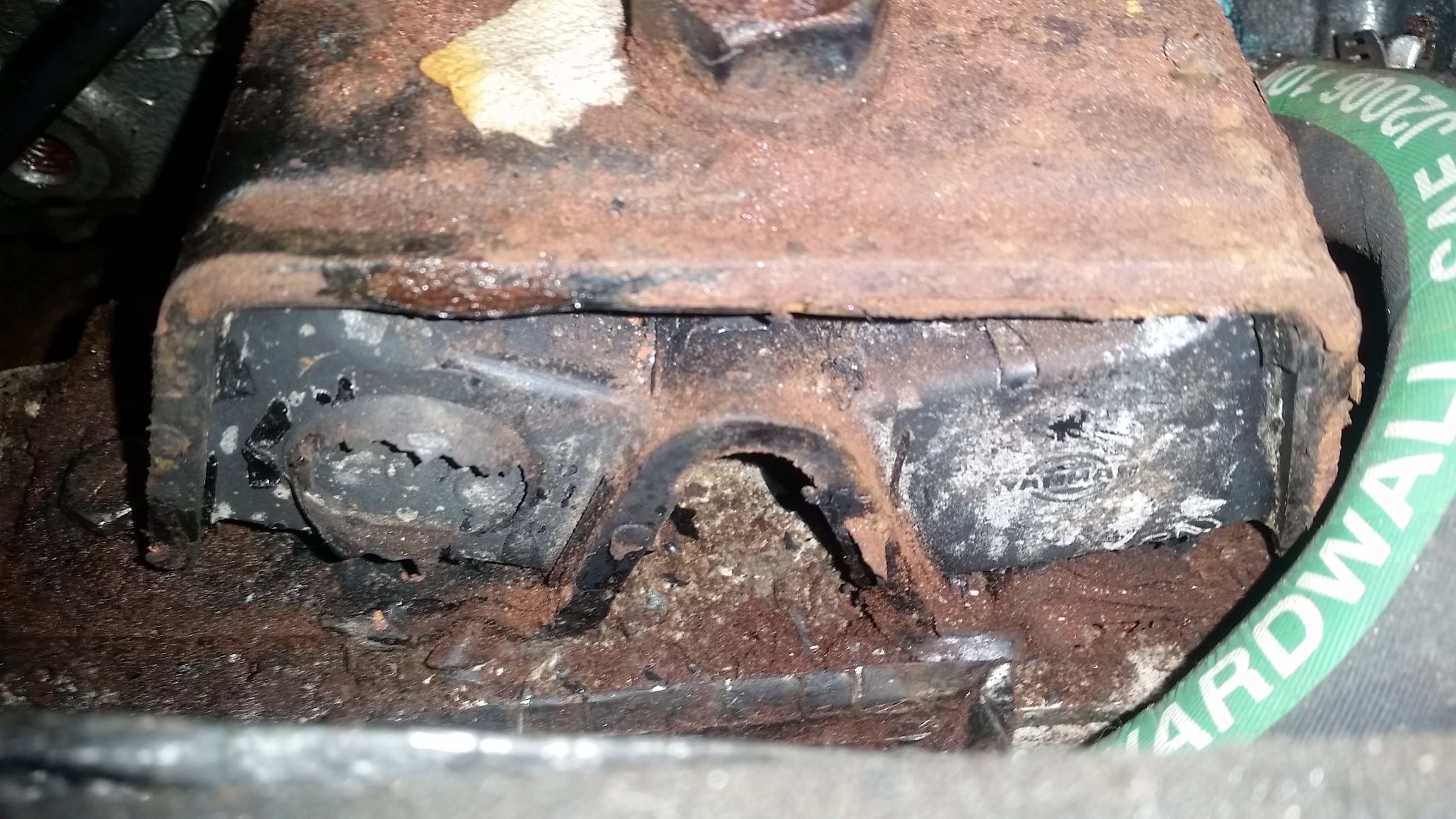

Engine mounts.. pretty straightforward.. ya have to disconnect the shaft coupling but a small scissors jack to do one end at a time; the basketball is a cool idea too. That said, if the top plate of the mount is not touching the bottom plate and has 3/16 or so clearance at both ends, the mounts are still OK.. One of those things .. might look terrible but still be OK.. clean 'em up and check clearance at both ends of all four. I would discount the "pilot bearing" comment.. The shaft may be bent or the prop may have a lot of growth on it causing the vibration.. A bent shaft can be found easily by uncoupling then rotating the shaft by hand while watching/measuring the gap between the engine side coupling and the shaft coupling. If the gap wide part rotates with the shaft, shaft is bent or the coupling is shot.. First really is to try to align the engine output to the shaft while the shaft is held in the center of the stern tube, the part that the packing box hose connects to. This can and should be done with the boat in the water. If the prop is clean and has no barnacles and the shaft is straight, alignment may solve the vibration..

8. Inspect engine mounts, clean and replace if necessary or if it looks like they will need replacing in the near future. Do it now to get it behind you.

I have just finished replacing my shaft, cutless brg. and packing gland on an Endeavour 35. I see some really good advice on solving your problem. Have you considered a dripless shaft seal? Mine is working very well and I did the installation-easy DIY but you will have to remove the shaft coupling. Here you can place a ratchet socket (same size or close to the diameter of the shaft) between the end of the shaft and the trans output shaft. Using 2 longer bolts through the coupling tighten and the coupling will back off. I agree with having your shaft analyzed for straightness and maybe you'll want your prop looked at also. Could be bent? Clean up those mounts and if they are ok per previous posts, apply some Ospho and paint 'em. I also used some allthread, washers and a piece of galv pipe to pull out the cutless brg. You can also press the new one back in place using same tooling. I learned a lot and saved the $120.00/hr yard rate!
