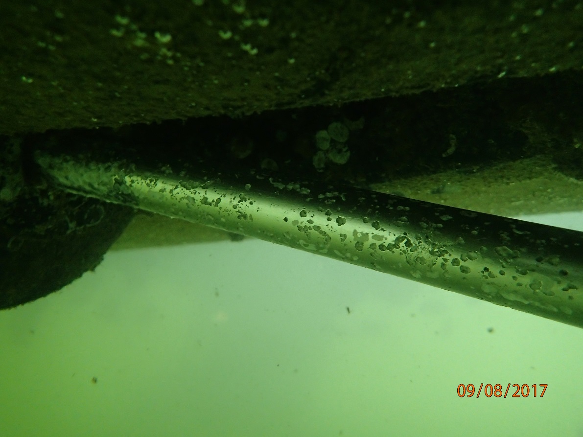

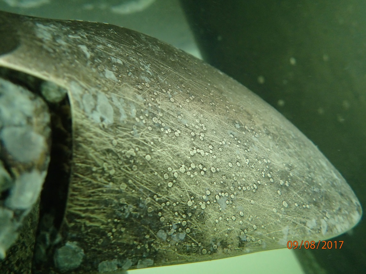

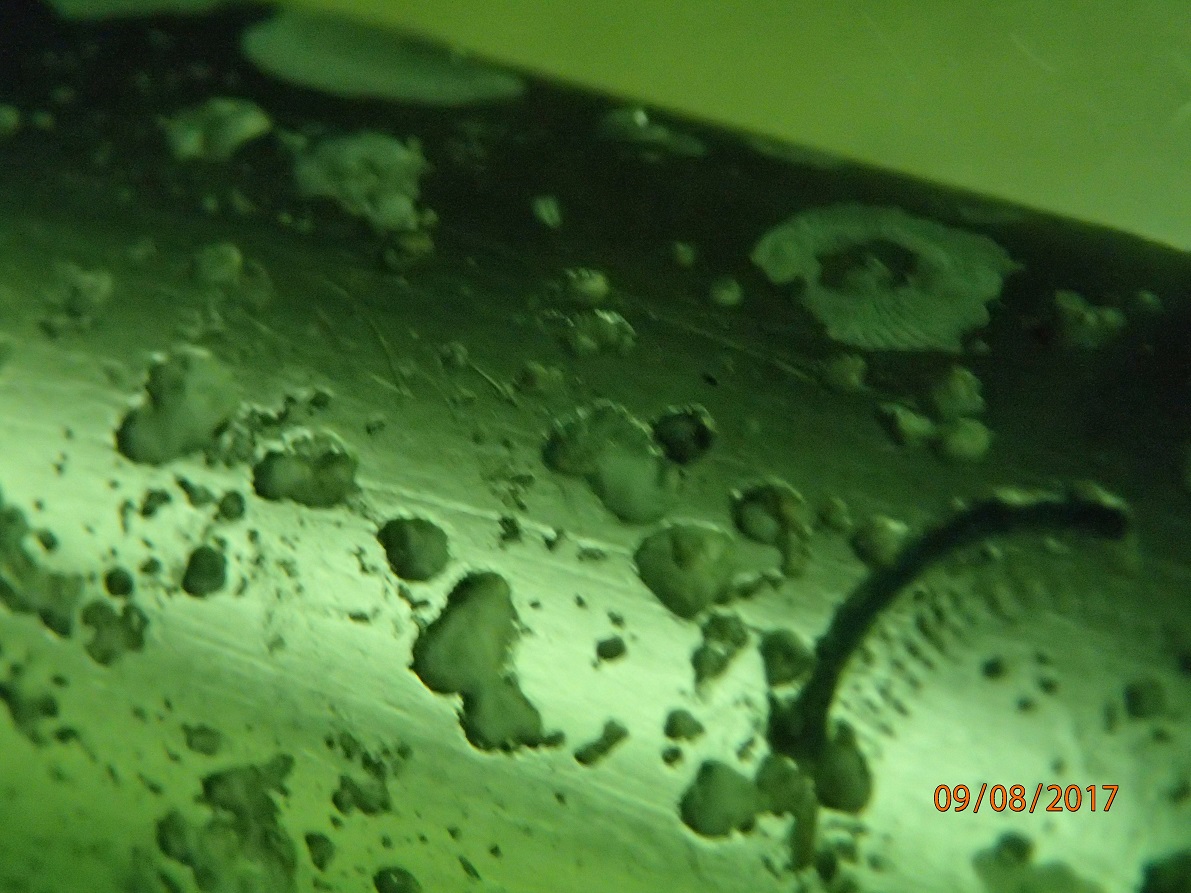

Here's the photos of my prop shaft and FoF prop. The shaft doesn't look good and the prop I see it started to pit.
Do I have a problem here? Will the prop breaks off should the FoF prop hit some logs? There's a crescent shape on the shaft. Didn't notice it till I see the photos. Could it be pitting?
I've my shore-power connected 24/7 charging batteries. Perhaps I should remove the cable when I'm not onboard.

Grossly - the pitting looks symptomatic of stray current but we do not know the shaft alloy you have. So measure your hull potential - plugged into shore power and also not plugged in. When you do this make sure your regular neighbors are is their slips so as to replicate conditions. Chances are this problem is originating from your own boat (in which case plugging in and unplugging will show no difference in hull potential) but it is impossible to say without hull potential measurements/assessment. I would imagine you must be going through shaft and prop zincs at a very high rate of decay too.
For replacement use the alloys MaineSail lists and no other. In any case you need to install galvanic isolation - never mind whether the shaft corrosion is caused by galvanic activity or by stray current. However, if stray current is the culprit you must identify the source and fix it - or your repair will be for naught - galvanic isolation will not protect you from stray current at potentials above about 1.3 vdc or thereabouts.
Hull potential = the difference between your shaft/propeller/its zincs compared with a reference probe silver/silver chloride (or in my case a very inexpensive all zinc reference anode.)
Charles

That doesn't look like its a result of simple pitting to me either. Do you have a isolater on he AC side; and shaft zincs? Have they be disappearing?
Something else is going on -- or you have a very bad piece of metal.

Yes I've a galvanic isolator that comes with boat from factory. Since i moved back to this marine i saw a fast depletion of shaft anode and increased shaft pitting.
Several years ago when i was first at this location my stock 2blades prop has pin holes!! Shaft wasn't too bad. Anode changes every 6-9 months.
Now everything seems to be eaten fast.

Off topic a bit, are you connected to shore power? If so you may be providing zinc for the rest of the dock. The ground wire in the shore power connects you to every other boat on shore power. Test (carefully) between the shore power ground at the dock and the ground lug on the shore power cable. The shore power cable has to be connected to the boat of course and the boat should be in it normal electrical configuration when you leave it for home. There should be 0.000 volts (there never is BTW). If you see anything over a 1 volt the consider getting a galvanic isolator for your AC circuits.
Also I don't think the shaft is in any jeopardy of breaking with just the surface pitting show.

The metal composition is almost the same as Alloy 20 . which is used to prevent Chloride Stress Corrosions. It is the high Nickel-Chromium content. Aquamet 22 appears to save $$ by lower Ni-Cr content since the Chloride content of sea water and temperature is low. All keel bolts should be made with this type metal too, since they could be Oxygen starved.
The picture is NOT Stress Corrosion.
_______
:plus::plus: you lost your Zinc protection Rapidly.
Jim..

SPEAKING of other boats in the marina...What's happening with them? Replacing zincs every 6-9 months in a marina isn't a huge depletion in my experience. If you're in question, I'd get a zinc "grouper", connect it to a solid ground on your boat, and hang it over the side. In some installations, the continuity of ground through to the shaft with some vibration isolators isn't clear.
