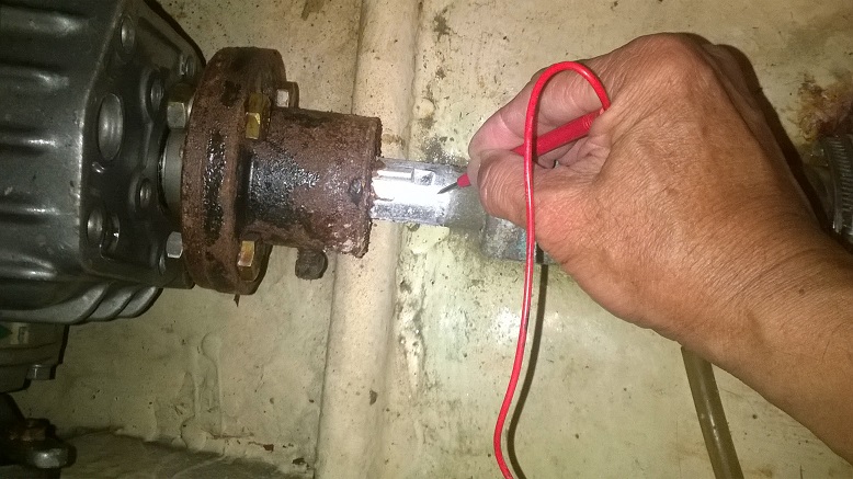

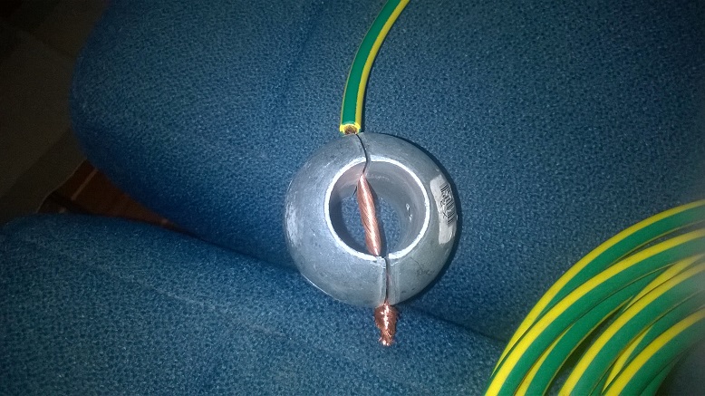

As a precaution for the moment, I've removed shore power connection when I leave the boat. I'll measure for voltage between shaft and seawater. How far down must the anode be lowered? Same level as prop shaft?

anode be lowered?
Submerged and Attached per zinc instructions to the shaft.
Sea water is the the other electrical pathway for galvanic protection.
Jim...
Not critical - over the side and a couple of feet from the surface works just fine.

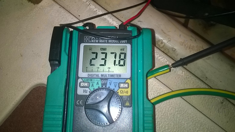

Anode lasted 6-9 months. About the only other wetted metal parts that's connected with ground wire is the Keel bolt.

The values your report are completely normal. A 6-9 mo rate of zinc depletion is not particularly rapid. But I am a little confused by your statement that you presently have '6- 9 months zinc life.' Was it 6 or 9 or somewhere in between? Also since you had 6-9 months zinc life the prior prop/shaft at same location then 6-9 months with the new prop and shaft is not out of line.
The normal voltage level means you are not exposed to stray current at the time you measured. 9 months of zinc life means you were probably not exposed to stray current since the last zinc change. 6 months suggests some possible stray current is at work some of the time. 3 months would be even more suggestive.
In any case continue to measure often and regularly. Keep track of the results. That way as conditions change - for example if a shaft zinc fell off or if current were passing via the shaft - you will know right away.
Charles
