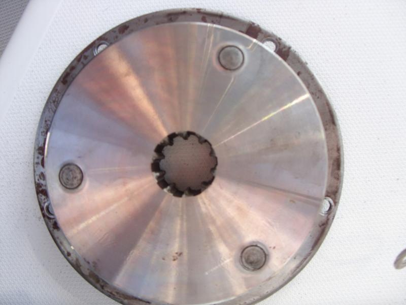

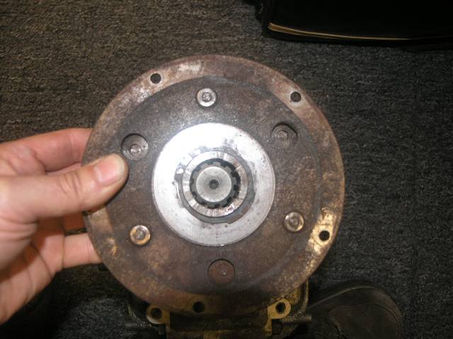

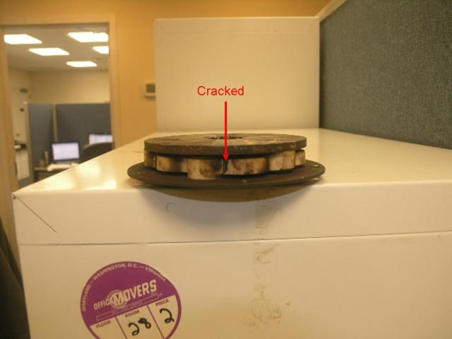

No, It just wore the cutlass bearing out faster from uneven pressure. The transmission is in between the mis-aligned strut and the damper plate, isolating any lateral forces applied from the drive shaft.
The reason for the problem was 2 fold:
1) The transmission alignment pins to the bell housing were mis-aligned causing the input shaft of the transmission to be out of alignment to the engine crank shaft causing lateral forces to be applied to the damper plate. This became apparent when putting the transmission back on, it would not mate properly to the bell housing. My guess is the mounting plate for the transmission is what was incorrectly made, because I find it improbable the the bell housing casting some how was wrong.
2) The R&D damper plate used was also too stiff as rated for the M25, so while at idle speed it could not isolate the torsional vibration out of the system and once a little play got started on the spline it just tore the damper collar up.
What is surprising to me is other than the wear on the input spline (which became a non-issue because of the new mounting ring pushing the interface beyond the wear point) that there was no apparent damage to the transmission from all this.
BTW I now have ~ 200 hours on it, and still quite and smooth as butter.

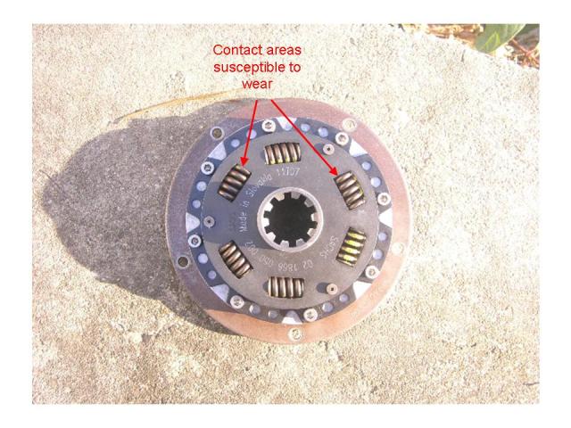

Did you see the pictures of mine after only >500hrs. Seems like maybe your noise is from something other than the spline/collar play. It was a clacking noise under 1500 RPM, loudest at idle. The R&D damper in mine is a plastic ribbon, that cracked and failed.
The correct Sachs plate uses springs. The contact points from the springs against the two plates is what normally wears.

The C36 guys had a lot of trouble with the damper plates on their engines - big time. But Witz' description and pictures are best ones I've ever seen.

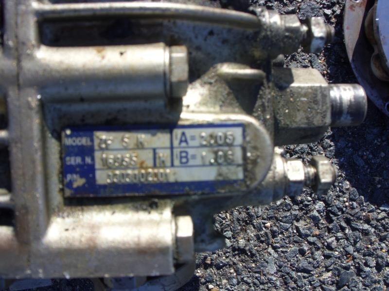

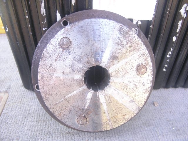

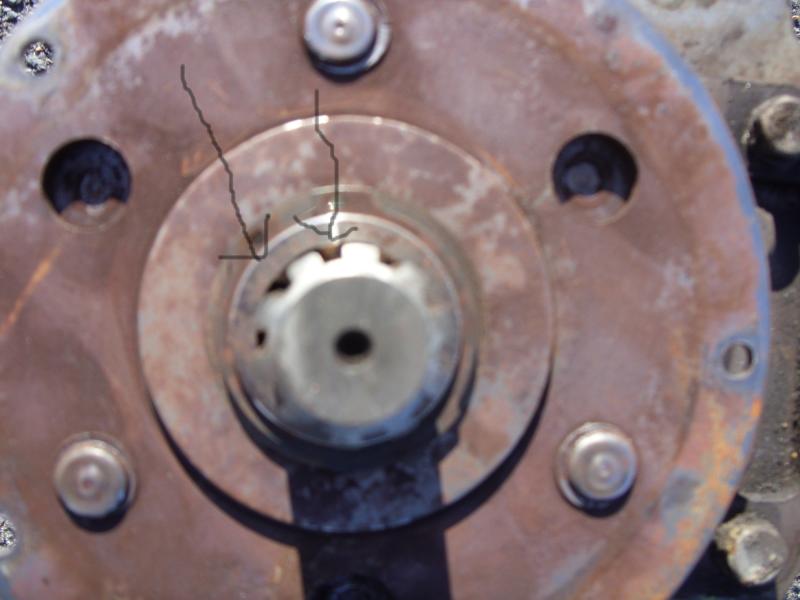

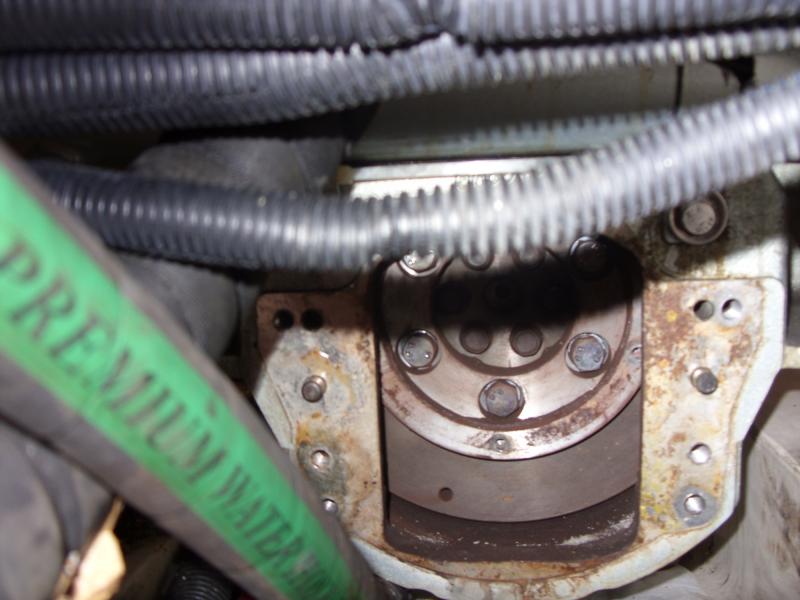

Pull the Tranny and Damper Plate today
Turned out to be a lot easier than I thought. I saw the Westerbeke rep at the Annapolis boat show and he told me I could pull the transmission off of the back and the pull the damper plate out of the opening, and he was right. Took about 1.5 hours.;) I was really doubting I would get the damper plate out the opening, but as soon as I pulled the last last bolt out the plate just slid right out. I have the R&D 2284 damper plate which I am going to replace with the Sachs one. No parts or pieces in the bottom of the bell housing :), but when I shake the damper plate there is a rattle in it. Also the teeth on the damper plate are pretty worn down, but the teeth on the transmission shaft look nearly brand new :D; but the overall result a lot of play between the shaft and the damper plate.
To avoid PaulJ riding me :pix:I am also posting the pictures. Needless to say, this most strongly appears to be my problem and I am pretty happy it is just a simple damper plate replacement. :dance: There is also a picture of my transmission and it is a Hurth ZF 5 H.

Hey Ray, Same problem I had, only yours was not as bad.
So you did not even have to separate the bell housing? I did not think you could get it the damper out without doing that. Anyway are you going to put another R&D in, or find another plate. I could not find one that had the right torque rating that would mount up the the fly wheel. So I had to salvage the mounting plate from the R&D and mount the Sachs to it. If you end up going that route, make sure you have all the run-out out of the system, or it will just eat it up again. BTW, grease the shaft up before you put it back together.

... So you did not even have to separate the bell housing? I did not think you could get it the damper out without doing that. Anyway are you going to put another R&D in, or find another plate. I could not find one that had the right torque rating that would mount up the the fly wheel. So I had to salvage the mounting plate from the R&D and mount the Sachs to it. If you end up going that route, make sure you have all the run-out out of the system, or it will just eat it up again. BTW, grease the shaft up before you put it back together.
Witz, I did not have to pull the engine; I simply disconnected the transmission from the bell housing and pulled it away. Then I was able to reach in through the back of the bell housing to unbolt and remove the damper plate. I did get a Sachs damper plate and I am going to do what you did and salvage the R&D mounting plate, and perhaps some extra spacers and longer bolts, to mount the damper plate back a little so it mates nicely on the transmission. There is a hair bit of play on the end from wear (not near like what you had) and I could probably pass on this, but since I have it all apart why not get it right. By moving it back like you did it will be a real tight fit, and I will confirm the rumors I like that.

Note, by spacing the Sachs off the old plate it will make the assembly fatter, will you still be able to fit it through the opening in the bell housing to re-install?

Glad to hear work is working out. Yes, with the old plate it should all fit with no problem. I was actually pretty surprise when I loosened the last bolt as how the whole thing pretty much dropped out on its own. Plenty of space.
