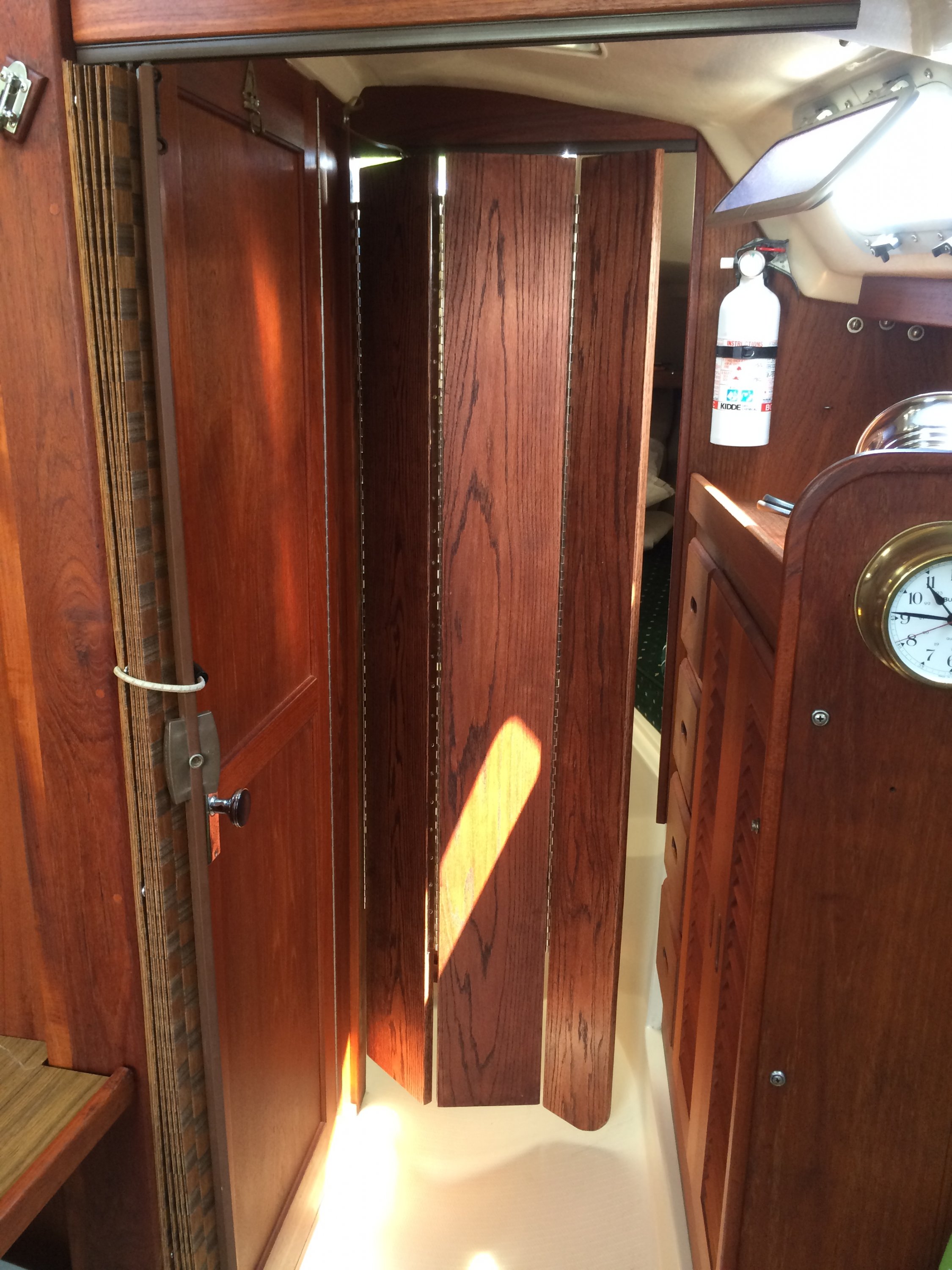

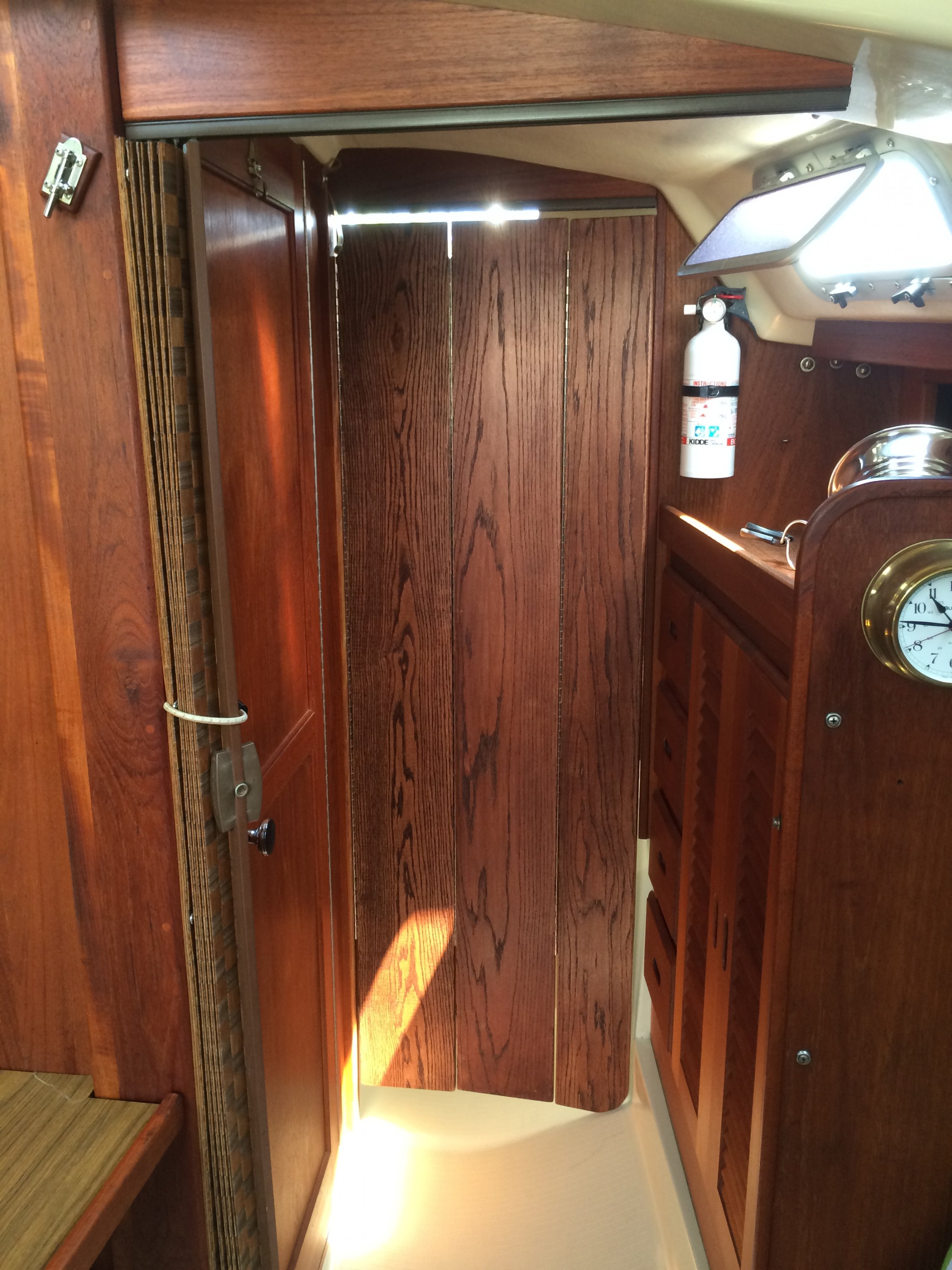

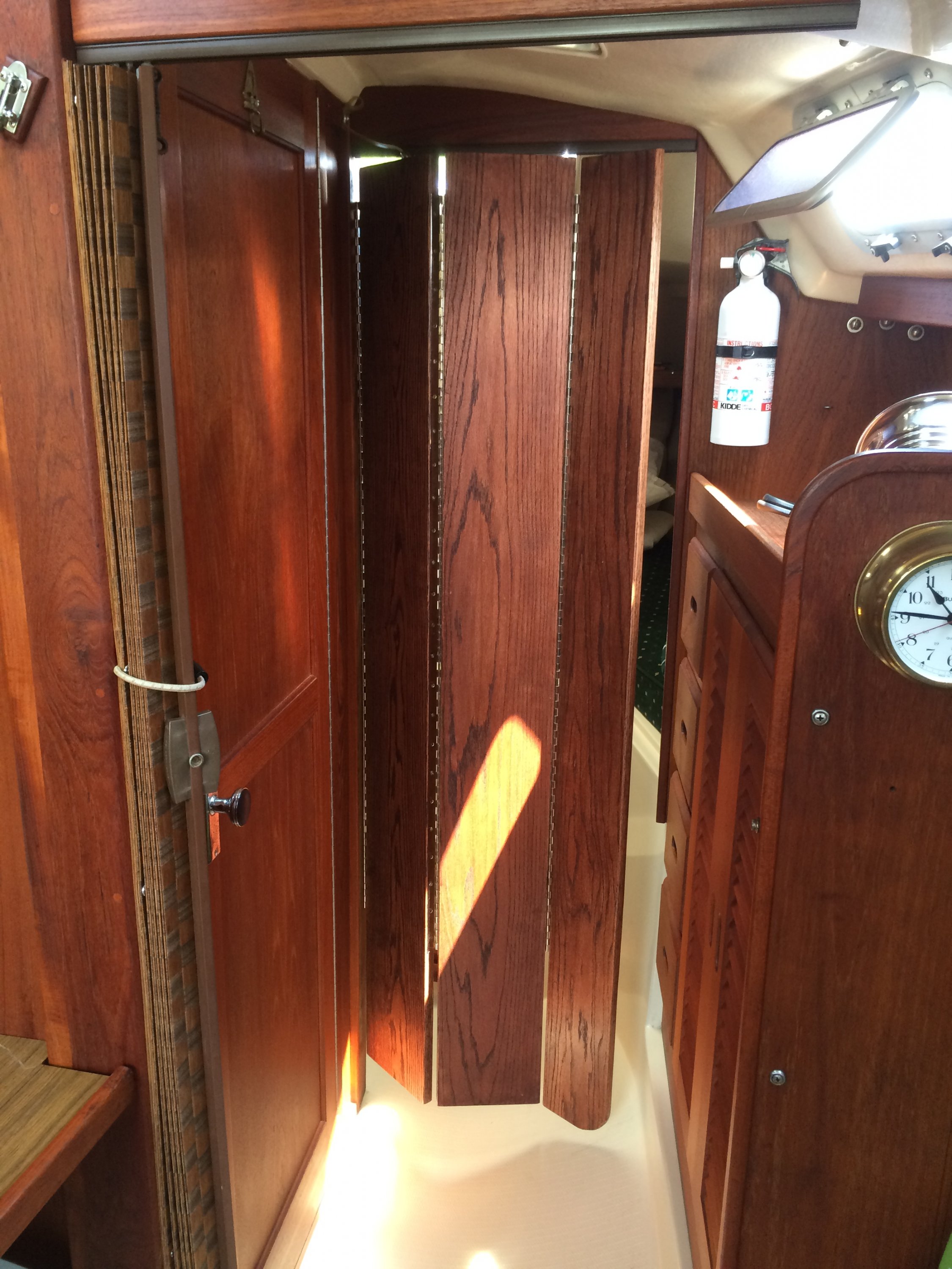

Oct 28, 2013
132
Catalina 42MKII Fairfield, CT

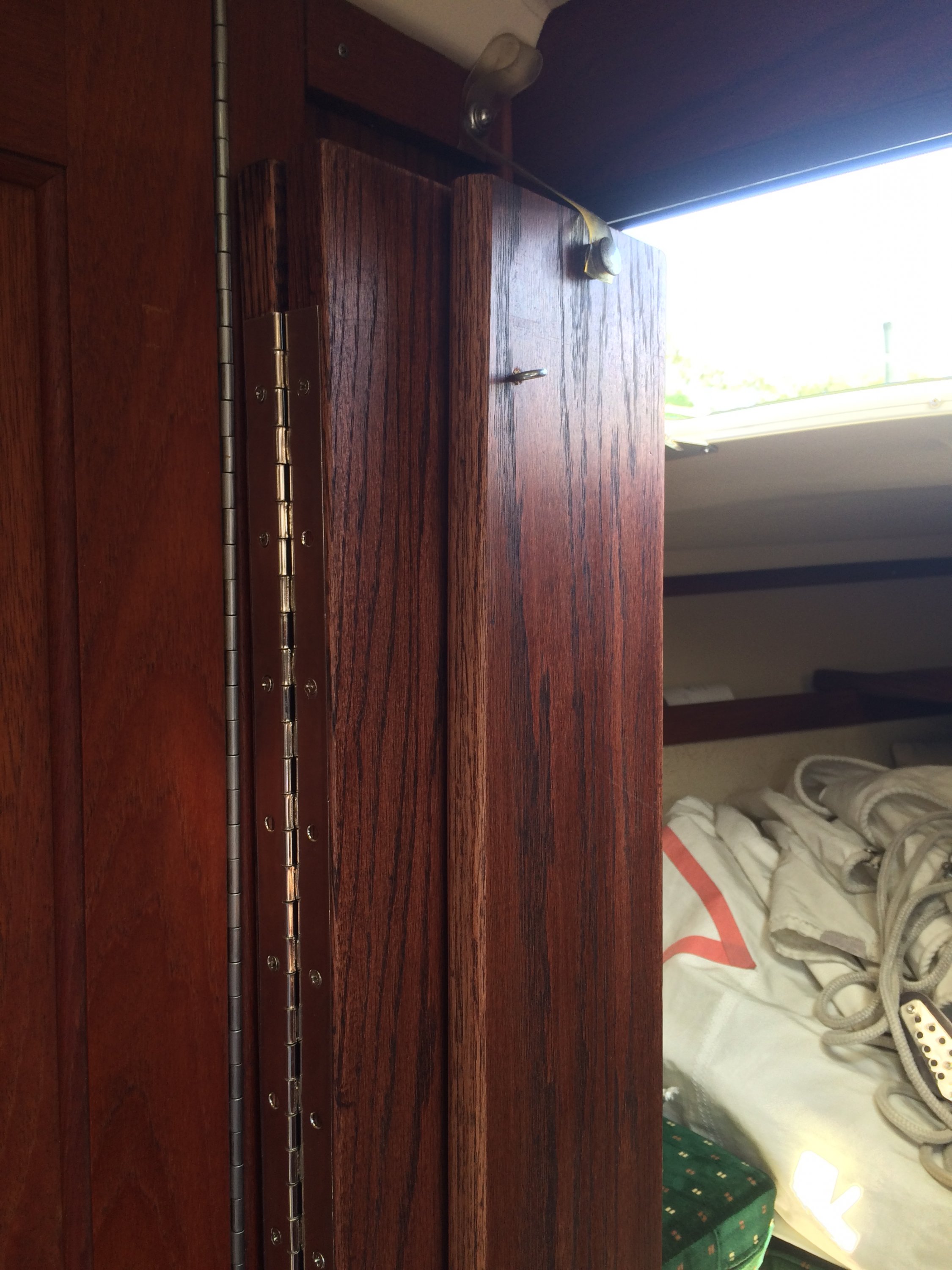

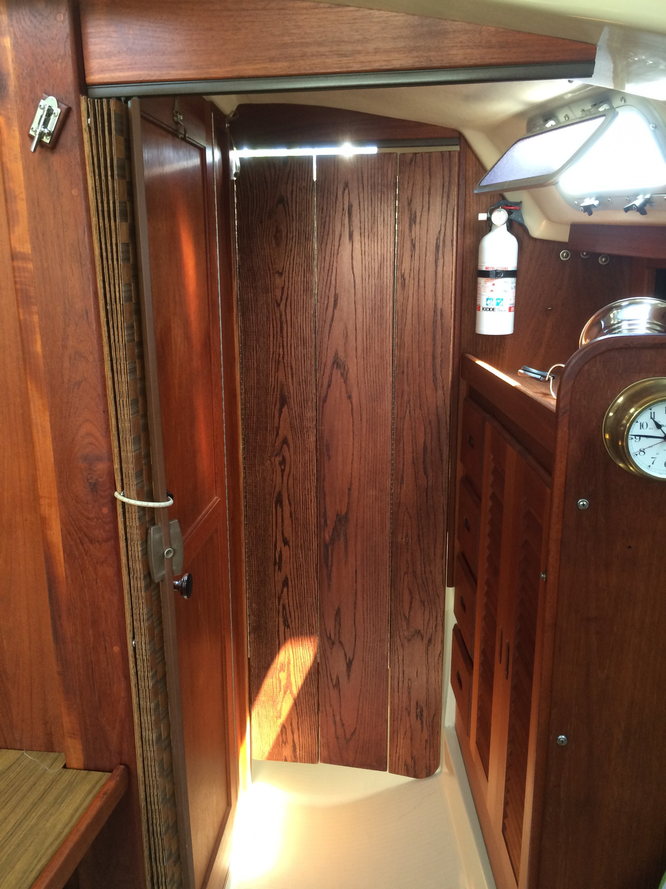

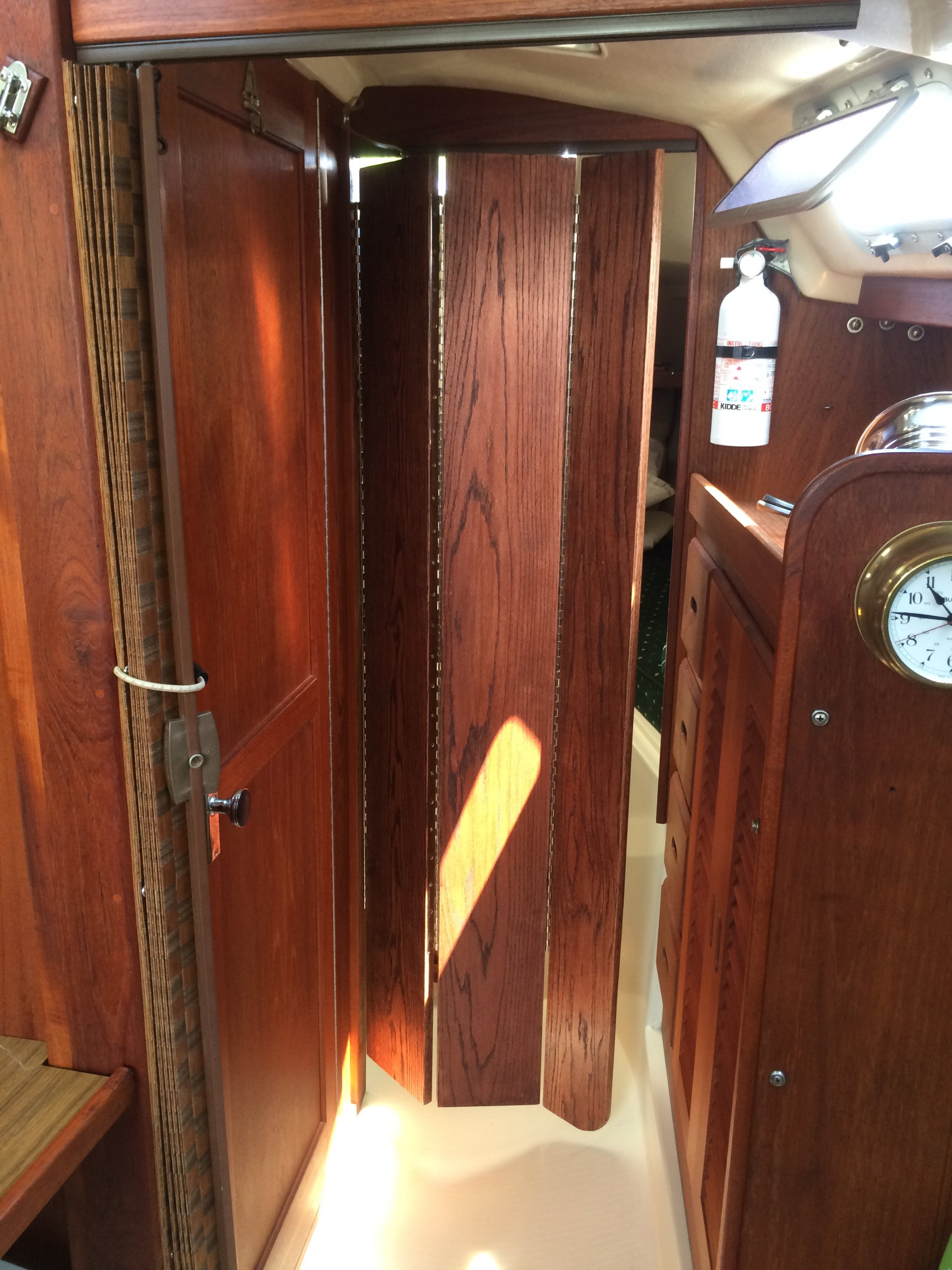

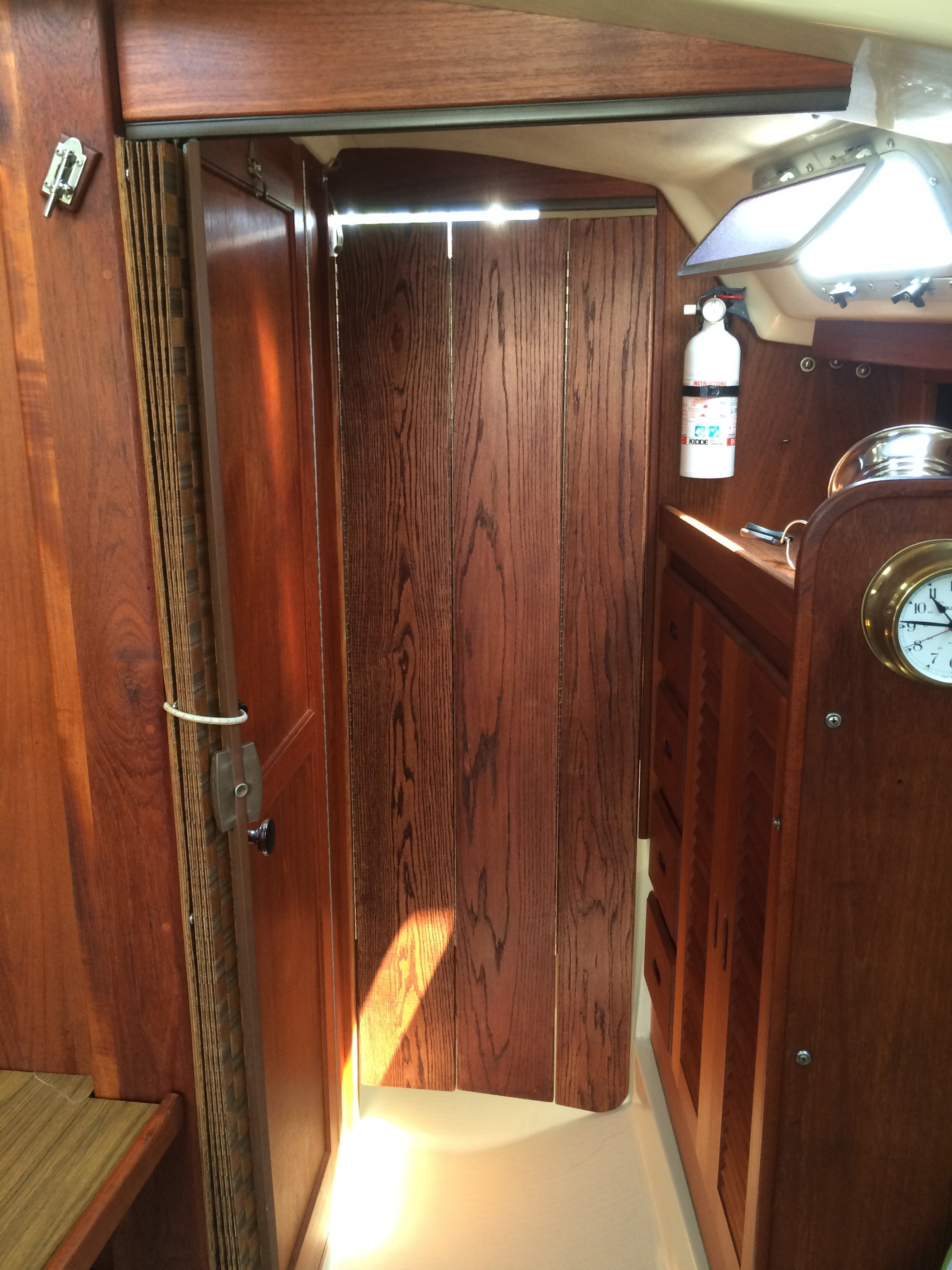

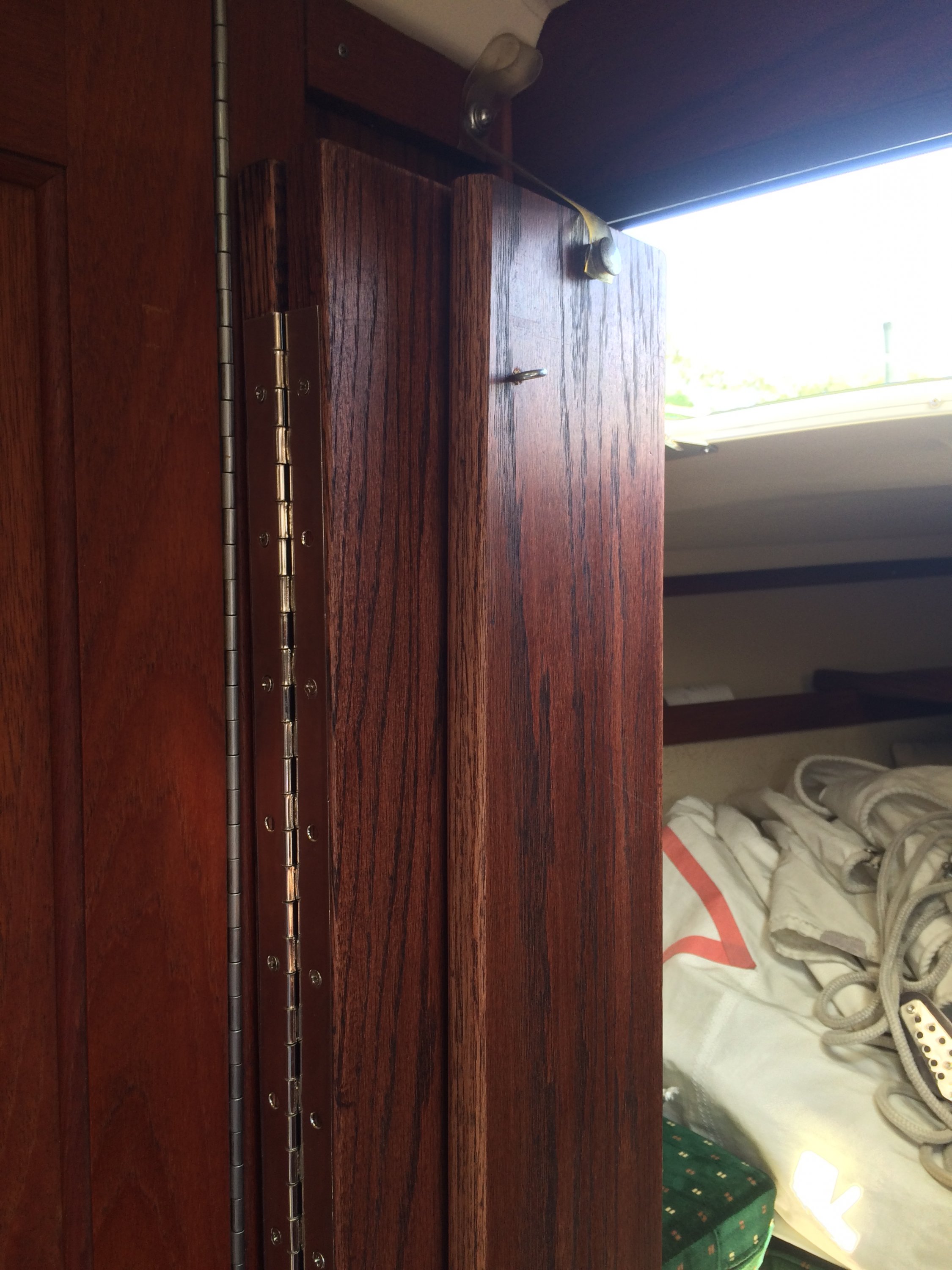

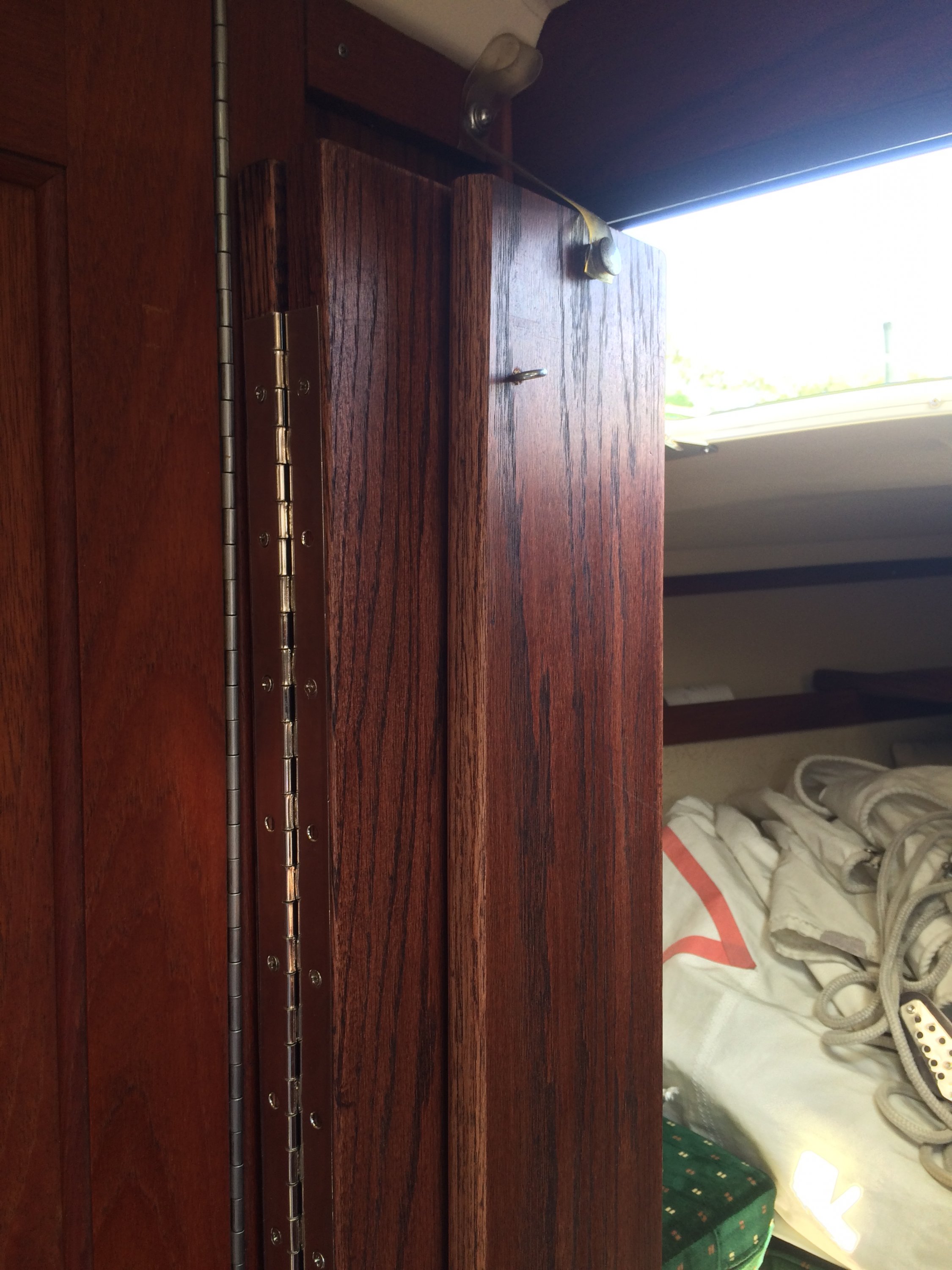

I could not stand that door, and ours was also falling apart. These are the pics of what i replaced them with, and love it. More privacy, looks better, and fits into the same space.IMG_1807.JPG IMG_1808.JPG IMG_1809.JPG
