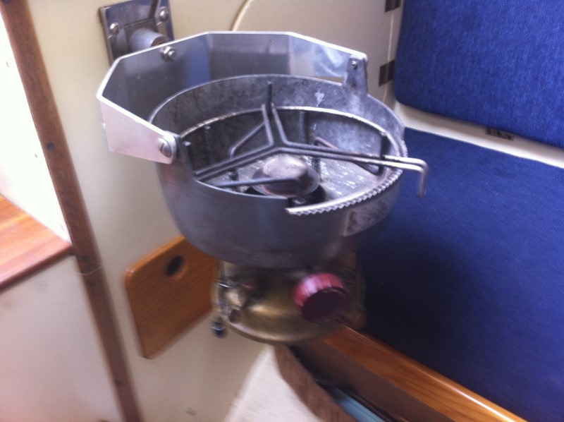

My gimbaled Seacook, with my kero burner in it. It was originally propane, which I discarded
And in use under way
