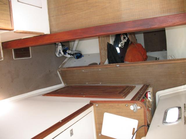

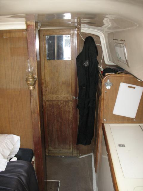

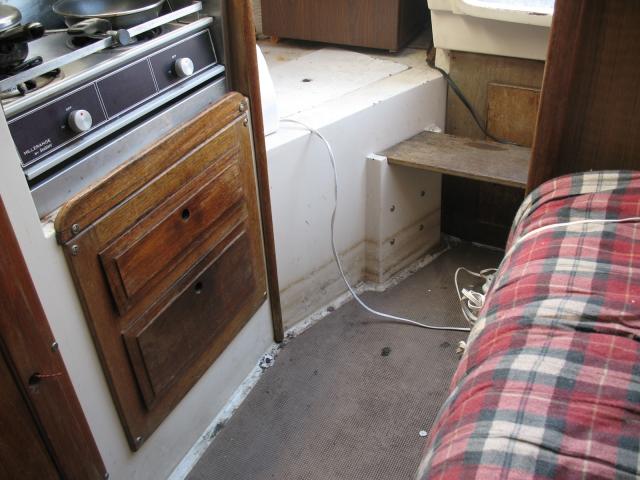

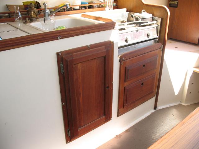

Oh and here are a couple pics of before and after with the cabinets inside...

Get the electrics for sailboats book by Casey. It will walk you through proper setups. Also, is that a series of waterlines inside your boat? What else got wet besides the floor pan?

That was a water line that the boat had when I first saw it. Some A-hole unplugged the boat from shore power to plug in their boat just before a few bad storms. Bilge ran till the battery died. You know the rest. None of the electrical got wet though.
