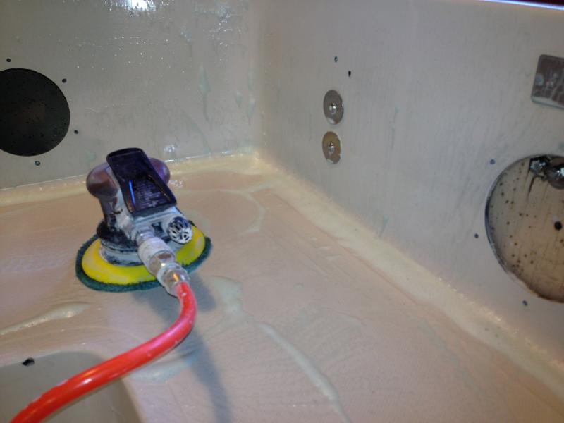

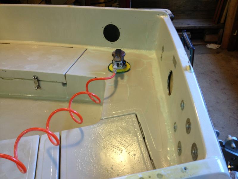

As the gel coat was chalky as well as stained, I used an air powered DA sander with a hook and loop pad. I cut green ScotchBright pads into circles and stuck them on. I scrubbed the entire topsides with that and a strong solution of Simple Green.
The green pads are close to about a 600 grit. I then followed up the same way with the grey pads which are about 1200 grit.
It cleaned all the stains, and removed the chalkiness.
PLEASE, Air Power ONLY with the above method, DO NOT USE an ELECTRIC SANDER with WATER!!

I find that a spritzer/spray bottle provides plenty of water and I only use electric random orbit power sanders, on an aluminum ladder to add to it.
I would not use a running hose, but a spray bottle is going to apply no more liquid to the work surface than this fat guy sweating.... I am that sweaty guy, at least until I get used to the humidity of the season :D
Without soaking things, know that wet sanding with a hand pump spray bottle is going to be for all practical purposes safe.

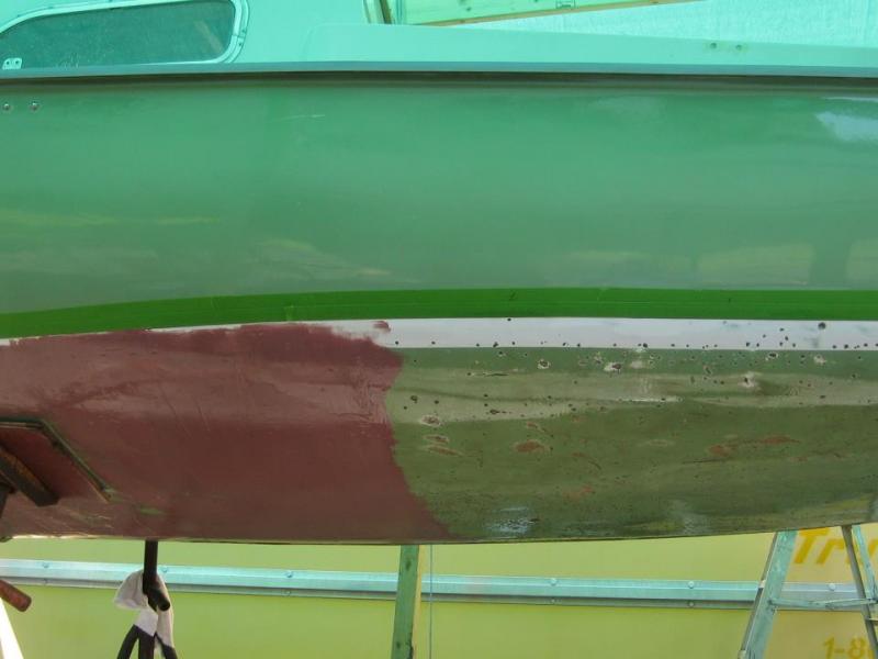

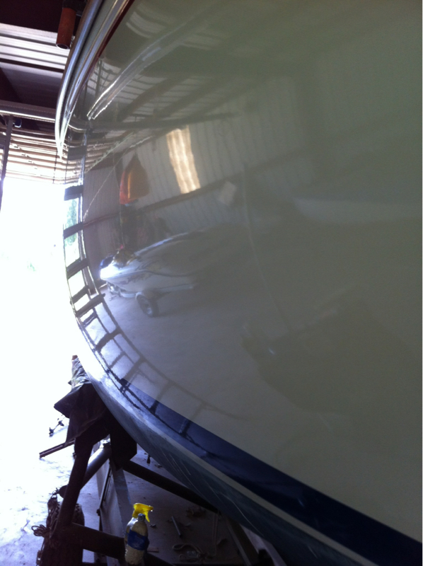

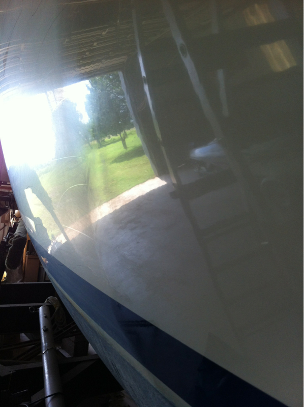

The pictures above show the results of 5" 1200 grit 3M random orbit paper on an electric RO sander, wet-sanded followed by a quick compound, followed by Meguiars Diamond Cut and finished with Perfect-it 3000 trizact finishing material.
The second pic shows the line between wet-sanding and the 3-stage compound and polish.
I decided 6 months ago to park the white wool 3M pads. Too aggressive. I am now just using the yellow 3M buffing pads.

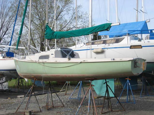

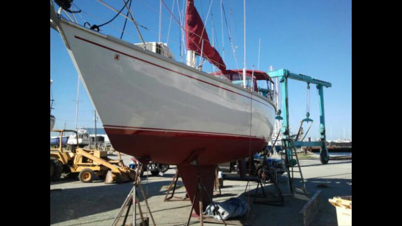

I was looking back to find an original photo of "Nunyet" but found only a few. Not a real good closeup, but...
It's a 1970 O'Day Mariner that had sat in a boatyard on the Chesapeake for estimates that vary from 6 to 8 to 10 years. No one knew for sure and the general consensus was it had been there "forever".
In addition to the obvious poor condition of the exterior, the bottom was full of blisters, so soda blast, and West System repair, 8 coats worth.
That's the problem with love at first sight.

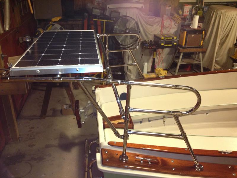

I had to post one in it's current state as my "Mini-Crusier". Just finished building new stern rail for 95 watt panel.
Lunacy is in the eye of the beholder I guess.

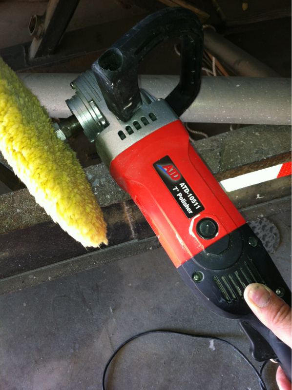

I think anything called "orbital" or "random orbital" is not what you want. With these the pad does spin but also occilates.
What you want is a variable speed rotory sander/polisher. This is the one I bought from Harbor Frieght and it worked well.
http://www.harborfreight.com/7-electronic-polishersander-with-digital-rpm-display-69696.html
They have 39.00 models that I've heard also work well.
Normally I buy "name brand" but I don't see this getting a ton of use so I went cheaper.

For the initial "sanding" I used a 6" d/a air sander with green scotch bright and a heavy concentration of Simple Green and water. It cleans everything really well, [ground-in smudges] eliminate dust, and I think it just sands easier with the soapy water to lubricate. I think it also reduces the tendency of the pad to "catch" on things.
