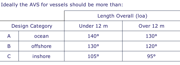

Your Ericsson 26 is an excellent coastal cruiser, and a really good starter boat for single handing or for a crew of 2.
But it was not designed for a blue water cruise to Hawaii. I say this because the capsize screen is well over 2.00. What that means is that if you get caught in a big storm, and big, breaking waves capsize your boat, it is actually unlikely to recover to an upright position. You can plan a trip to Hawaii when such storms are less likely, but the risk remains. The book "Choosing a Cruising Sailboat" by Roger Marshall is a good reference for this discussion. Our '77 Hunter 27 with a capsize screen of 1.93 is a capable design and others have cruised it across oceans.
The other issue is preparing the skipper and the boat for a blue water cruise. The best reference for preparing your boat is "The Pacific Cup Handbook" by Jim and Sue Corenman. "Storm Tactics Handbook" by the Pardeys will help you get your head into preparing contingency plans and equipment for the worst case. You could develop your skipper skills for the trip in two years, but the real question is how many days you spend sailing. I would say it took me 70 to 100 days to know our boat, and understand/practice a good set of contingency plans to consider skippering a bliue water cruise. (I haven't done this - our Great Lakes cruising ground has big storms, but a port of refuge is always close enough to get off the lake as a storm builds up.)
Certainly, others have taken the risk of not recovering from a capsize far from land, and made such trips in a coastal cruising design. But I recommend you spend some time and study understanding the risk before taking such a decision.

FastOlson, I'm going to respond on your comment and the sailnet thread with comments against the capsize screen.
First, hull design has almost nothing to do with the probability of capsizing. Extensive tank tests of a broad range of designs show that if a boat is hit by a breaking wave higher than its beam it will capsize. (Its beam or the dimension it is presenting to the wave up to and including its length.)
The issue addressed by the capsize screen is whether the boat is likely to right itself from an inverted, capsized position when rolled by another wave. It was developed after extensive tests that showed it is quite accurate in predicting this recovery for most hull designs. The Angle of Vanishing Stability may be more technically appealing, because it includes all weight distribution of the design (center of gravity, etc.) But it is not much better than the capsize screen in predicting recovery from a capsize.
Then, there is the issue of the designer's intent. When designing a boat for off-shore cruising a designer will surely consider the capsize screen of his design. Conversely, when designing a coastal cruiser (like the Ericsson 26-2), initial stability, interior room, or other factors may be more important than capsize recovery.
Finally, the high quality of Ericsson yacht construction is a real positive, but also has no impact on recovery from a capsize.

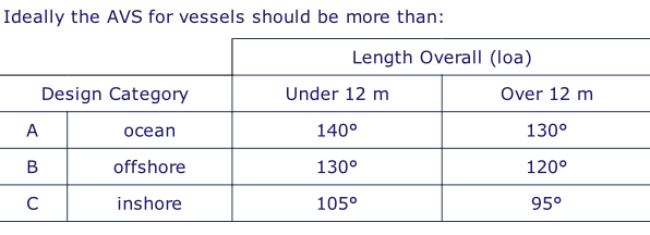

I've always been concerned with the ability for my ship to return to upright in the unhappy event that it does get turned over. Doing a quick search, here is what AI told me about the OP's boat. FWIW...
A precise GZ (righting lever) curve for the Ericson 26-2 is not publicly available in standard boat specification databases, as it typically comes from the yacht's designer or original manufacturer. However, the boat's known stability characteristics suggest a high initial stiffness for coastal sailing but a low ultimate righting ability if fully capsized.
What the GZ curve would show
Based on its design and available stability metrics, a hypothetical GZ curve for the Ericson 26-2 would feature the following characteristics:
  • High initial slope: The GZ curve would rise steeply at small angles of heel (0°–10°), indicating the boat is very "stiff" and resists heeling under normal sailing conditions. This is a common feature of boats like the 26-2, which were designed as day-sailors or coastal cruisers.
  • A "soft" or low curve at large angles: The GZ curve would peak and then fall away relatively quickly, with a limited range of positive stability. This indicates a lower righting capability once the boat is fully knocked down, meaning it would be less likely to right itself quickly in severe conditions.
  • Angle of vanishing stability (AVS): The AVS—the point where the GZ curve crosses the x-axis and the boat loses its righting ability—is likely to be relatively low compared to offshore voyaging boats. The Ericson 26-2 is best suited for day sailing and coastal cruising, not offshore work where a high AVS is critical.
Known stability data
Several specifications provide insight into the Ericson 26-2's stability profile without the full GZ curve:
  • Capsize Screening Formula (CSF): 2.13.
    • This widely used metric helps predict seaworthiness by comparing displacement and beam.
    • A ratio below 2.0 suggests a boat is more suited for offshore conditions.
    • The 2.13 ratio for the Ericson 26-2 indicates it is better suited for coastal and inland waters rather than serious offshore voyaging.
  • Ballast-to-Displacement Ratio: 42.86%.
    • A high ballast ratio typically contributes to stiffness and overall stability.
    • At over 40%, the Ericson 26-2's ratio confirms its initial stiffness under sail.

I agree with this, however, the coastal cruiser definition seems to be strange to me. It would seem that if you're within the costal area you would be almost as likely, to encounter large freak waves or swells, making any boat that's a costal cruiser kinda pointless, no? Yes, you're closer to rescue, but if every time you get slapped in the face with freak weather that wasn't forecasted or a large rogue wave you're going to lose the boat, what's the point of them? You just tuck tail and run back to mama as soon as you see clouds? :poop:
dLj
Mar 23, 2017
5,118
The design criteria for coastal cruising (offshore) are different than for ocean sailing - here's a graph showing the current design numbers.
The AVS is the angle of vanishing stability (I'm sure you know this). However, I have to partially disagree with your statement that in coastal areas you are as likely to encounter wave heights that could turtle your boat. While you may find steep waves where the ocean swell is "humping up" from the decreasing bottom depth, the wave patterns that can occur in the middle of the ocean I've never seen near shore. And they can go on for many hours or days unlike near shore. Near shore those wave patterns are typically coming from one direction so it's easier to position your boat to handle them better. Mid-ocean I've seen huge wave patterns coming from multiple directions at the same time, hence much more difficult to position your boat to handle them... I feel it is the possibility for this greater random wave direction to be part of the driving force behind the design criteria above.
dj
Would that make my boat a class C or class B vessel by modern standards? This makes a lot of sense as far as wave patterns, etc. Thank you!
