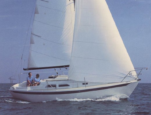

I'm sure this is going to unleash a flurry of comments about me being foolish, but nonetheless, I need some answers.
I recently purchased the only boat in my price range that had the features I was looking for and wasn't also a complete mess, only partially one.
A 1988 Ericson 26 mark IV, or 26-2 whatever you would like to call it.
Besides her good looks, I was attracted by her features for a smaller boat, and people bragging about the construction and capabilities. I was also limited by the ability to tow it with a midsize truck, so this is the biggest I could go, as I am not a rich person.
I know she's not an ocean crossing vessel by definition, but I was wondering how feasible it would be? If it's a pipe dream, I guess I'm back to square 1, but acquiring something larger would be difficult to say the least.
What changes should I make? Besides keel bolts and through holes, what else should I upgrade? Does anyone have information on her AVS? I plan to do the refit a bit at a time over two years while learning and studying as much as I can. Then I want to go to Hawaii.

Size is not a determining requirement. There are couples who have crossed oceans in boats 15ft to 20 ft.
Look at the risk of capsizing. A boat is better suited for ocean passages (vs coastal cruising) if the result of the calculation is 2.0 or less. The lower the better.
The Ericsson has a Capsize Screening Formula: 2.13
Comfort ratio talks about what it would be like onboard in a storm disturbed sea.
Comfort Ratio: 18.17
Numbers below 20 indicate a lightweight racing boat, small dinghy and such;
20 to 30 indicates a coastal cruiser;
30 to 40 indicates a moderate bluewater cruising boat;
40 to 50 indicates a heavy bluewater boat;
over 50 indicates an extremely heavy bluewater boat.
Comfort ratio = D ÷ (.65 x (.7 LWL + .3 LOA) x Beam^1.33),
