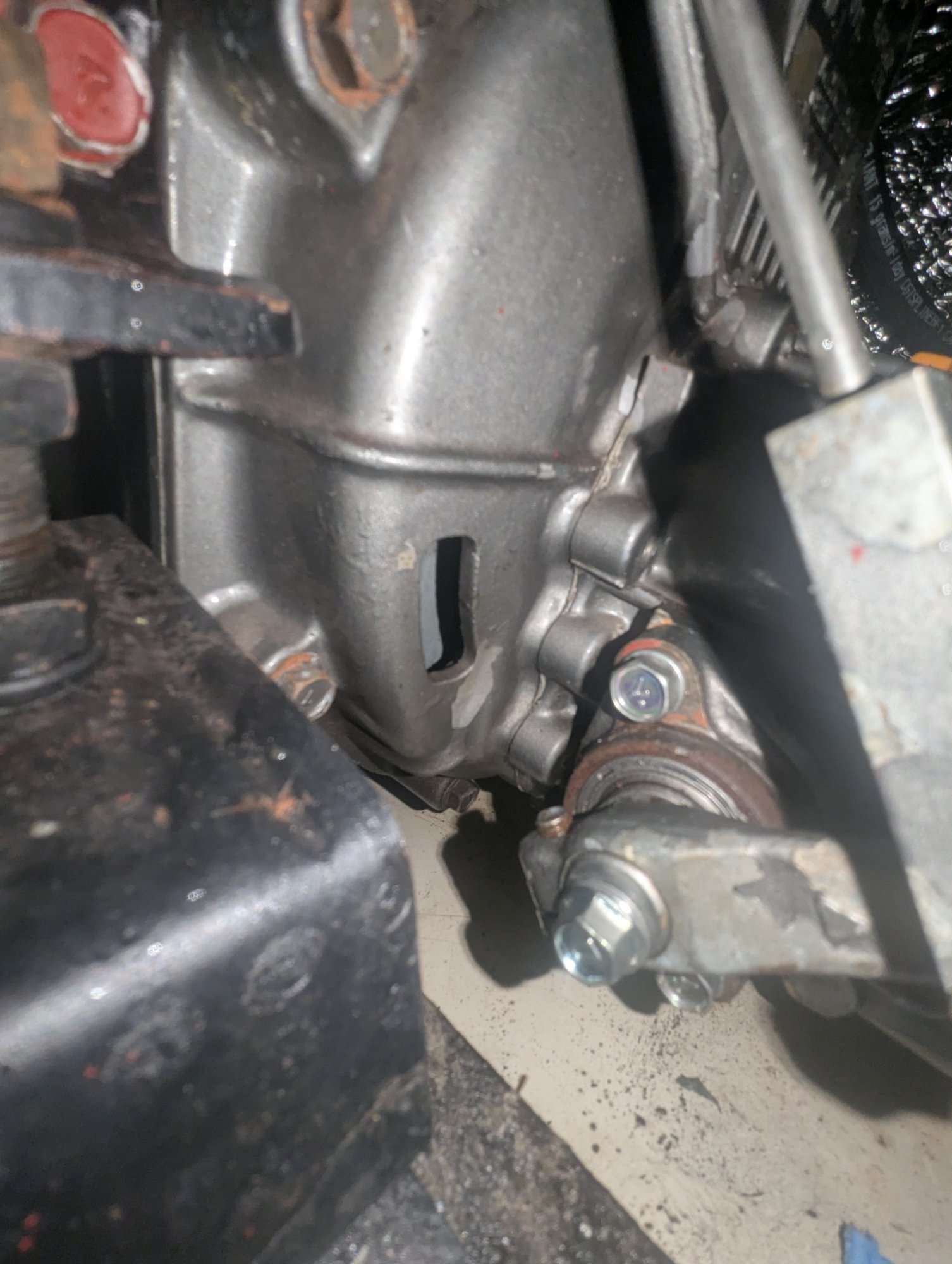

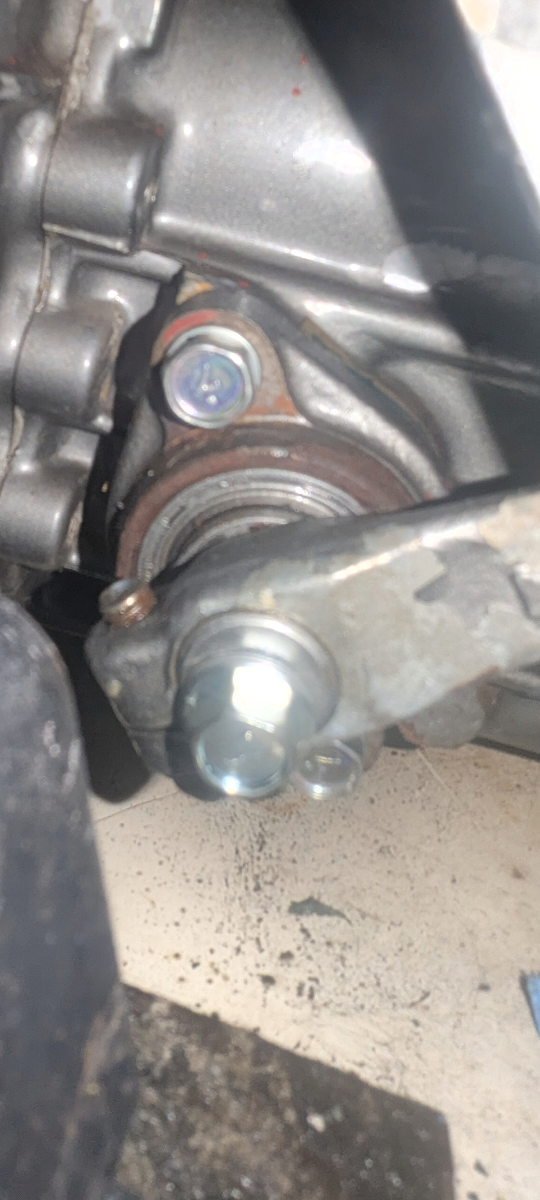

According to them I need to bump the transmission back into alignment, get the three bolts through Yanmar, and reinstall them. He mentioned it would be a five minute job once I have the parts from the Yanmar dealer.
Now I've got to locate a Yanmar dealer near me.

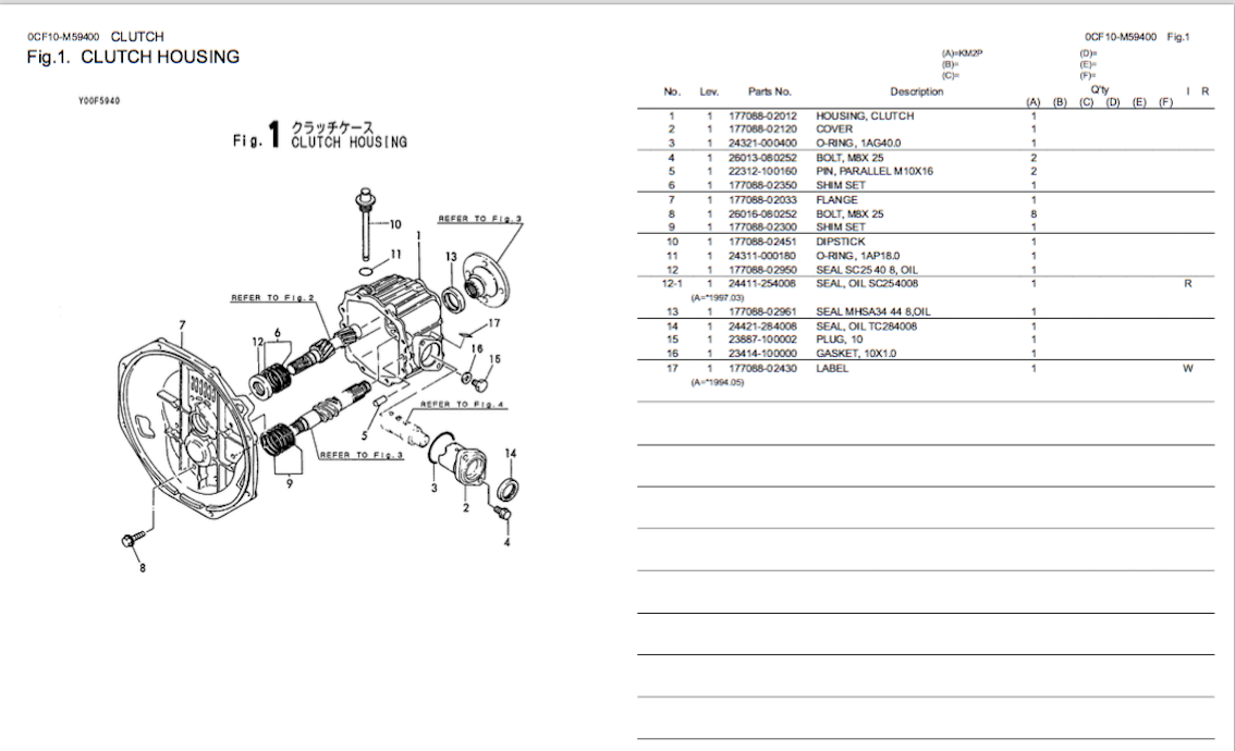

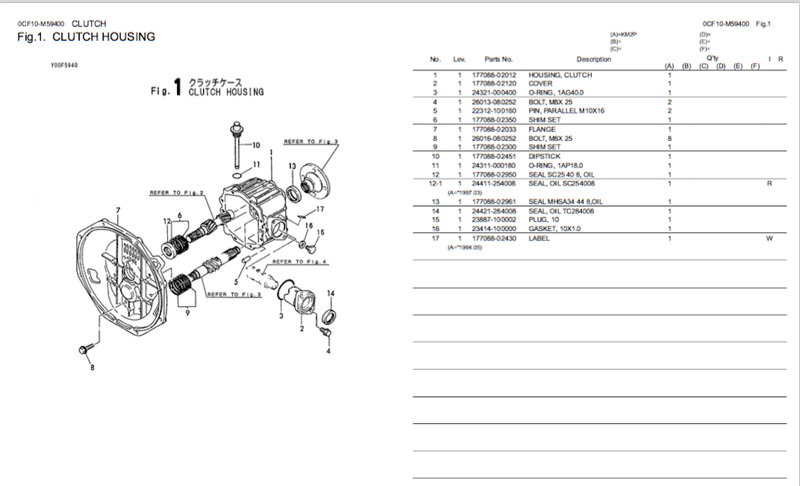

At the moment, I'm searching for the part numbers of the three bolts as well as the shims I need. I'm not sure where to get it. My transmission is the Kanzaki KM2P with a 2.62 gear ratio.
Edit: Got the part numbers from the catalog.
Shim Set:
177088-06380
Center Bolt:
177088-06360
Collar Bolts (Need 2):
26013-080252
I guess I'll just order them up and see how they fit. Praying the threads catch and everything works out!

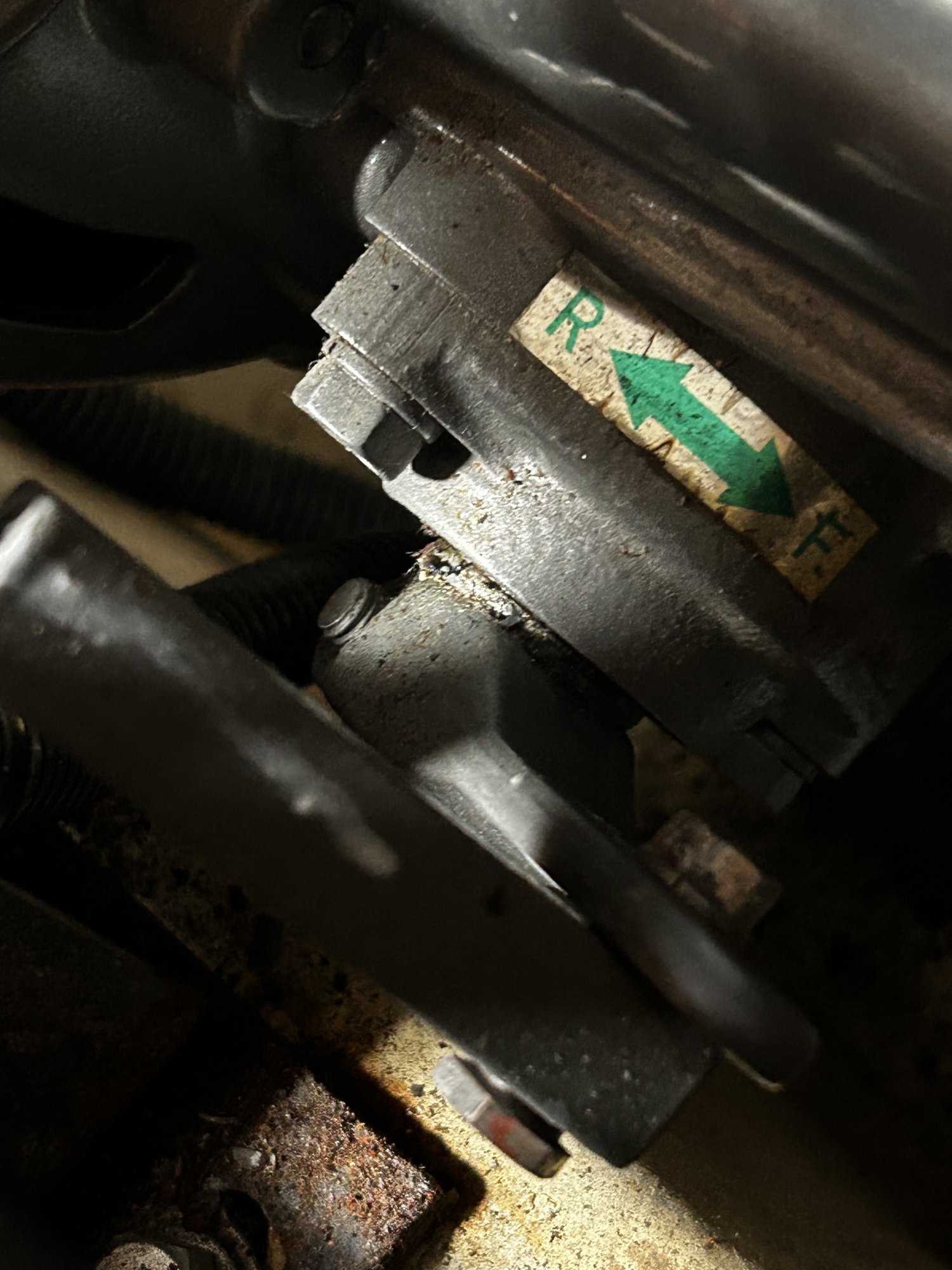

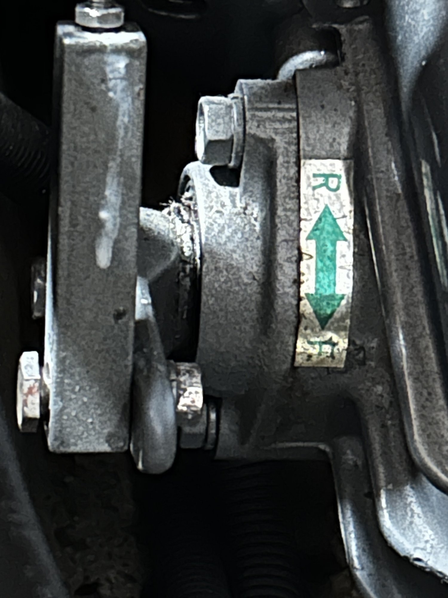

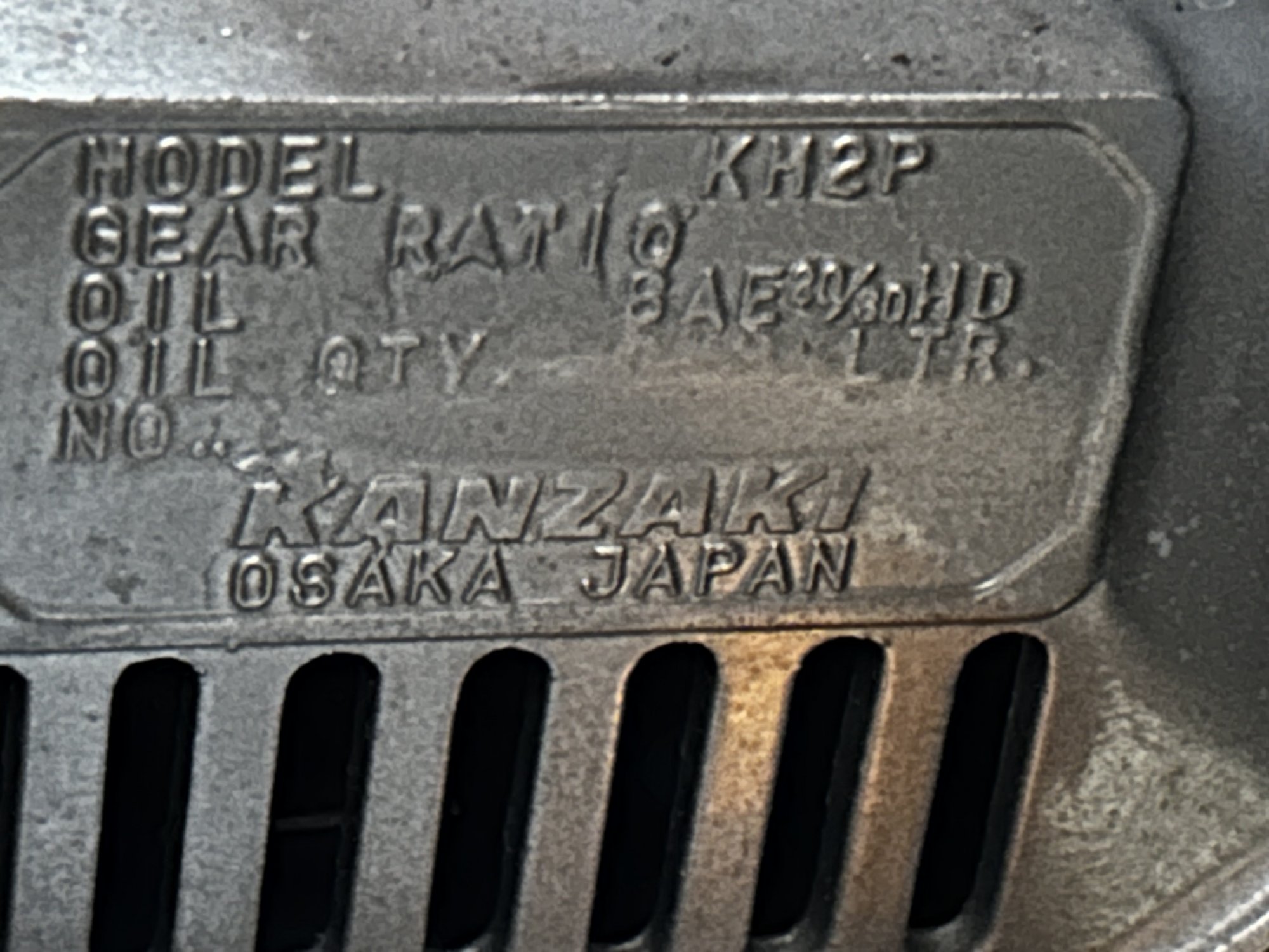

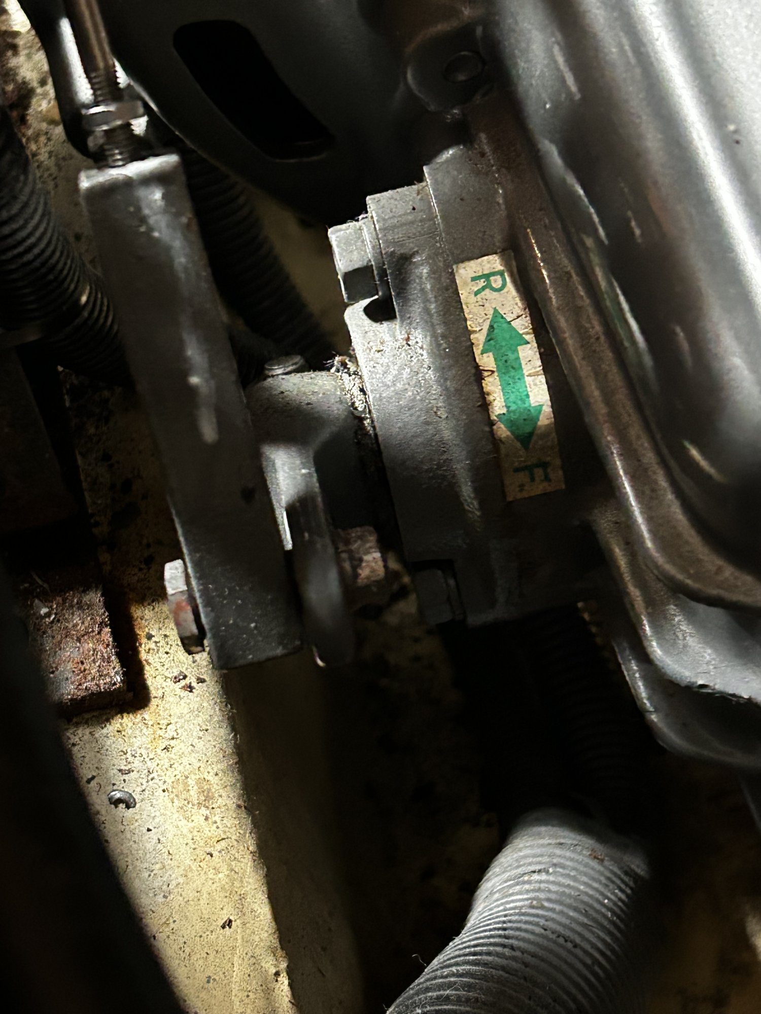

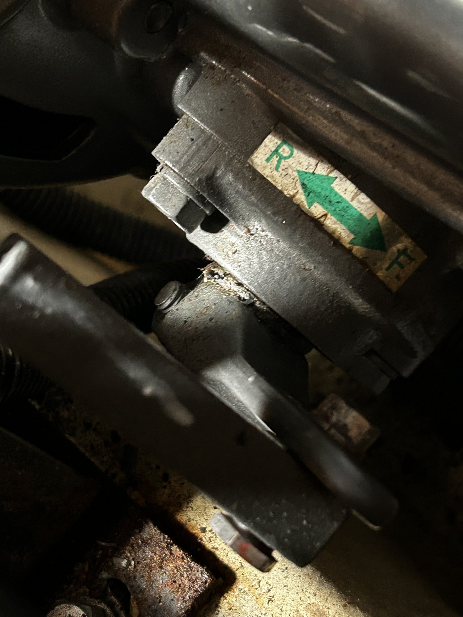

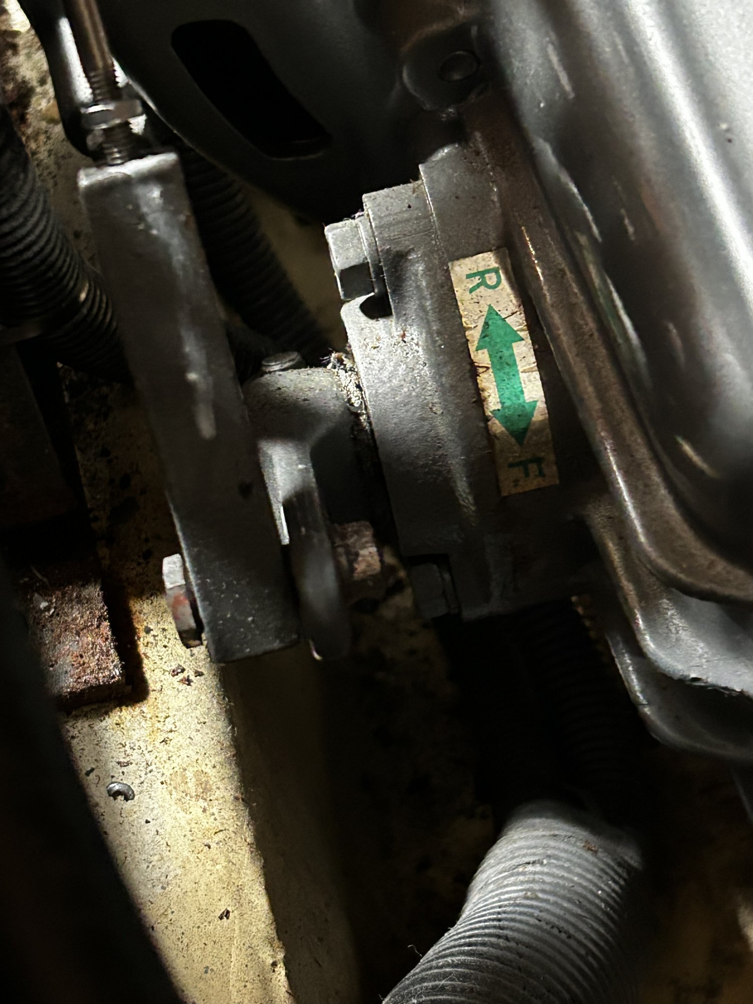

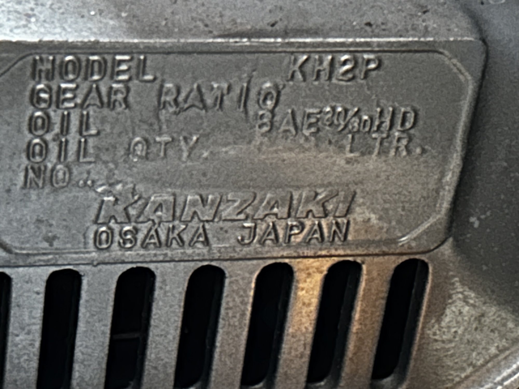

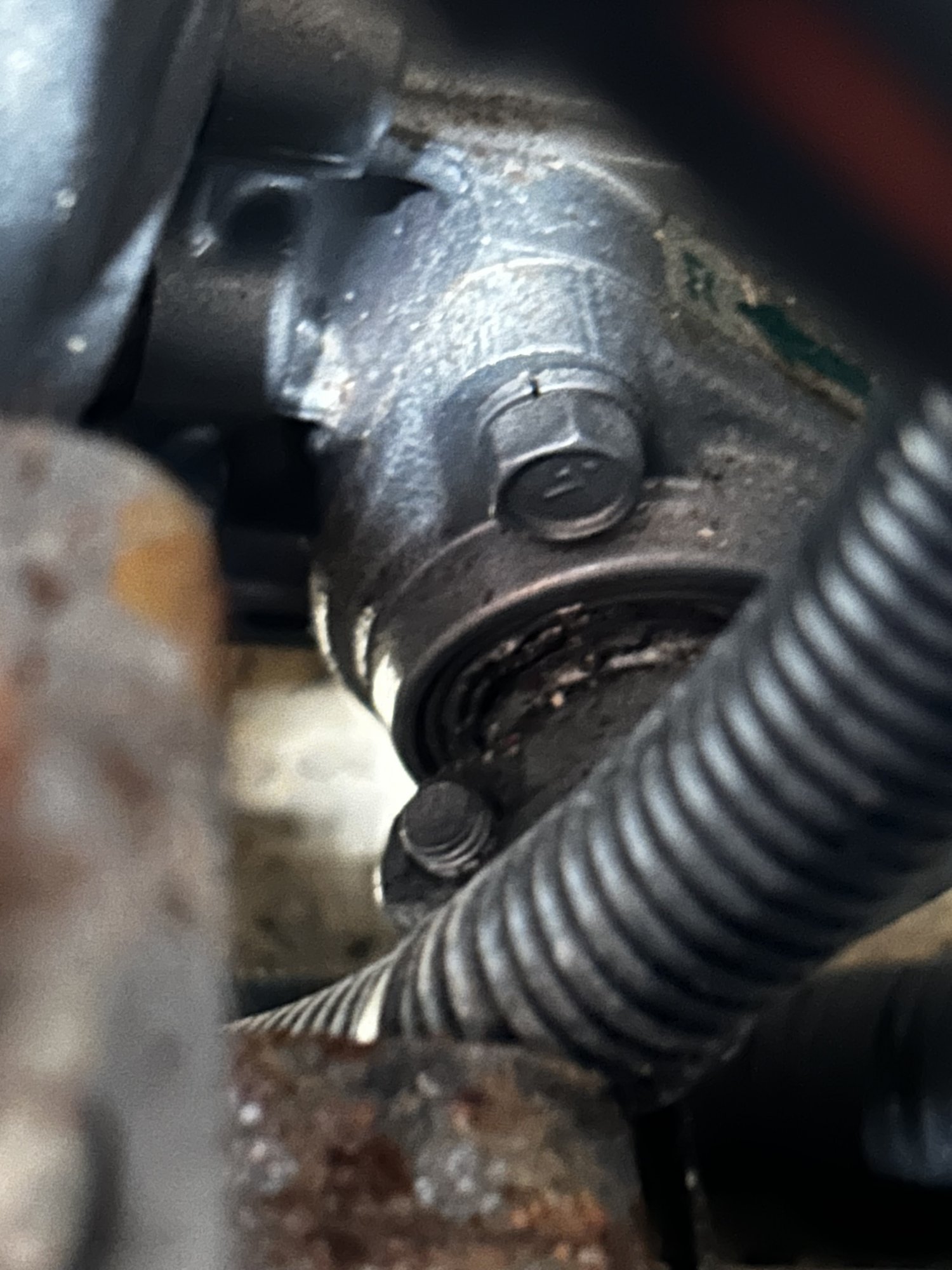

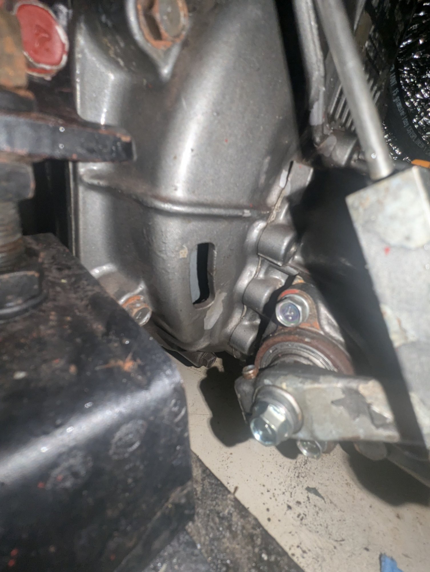

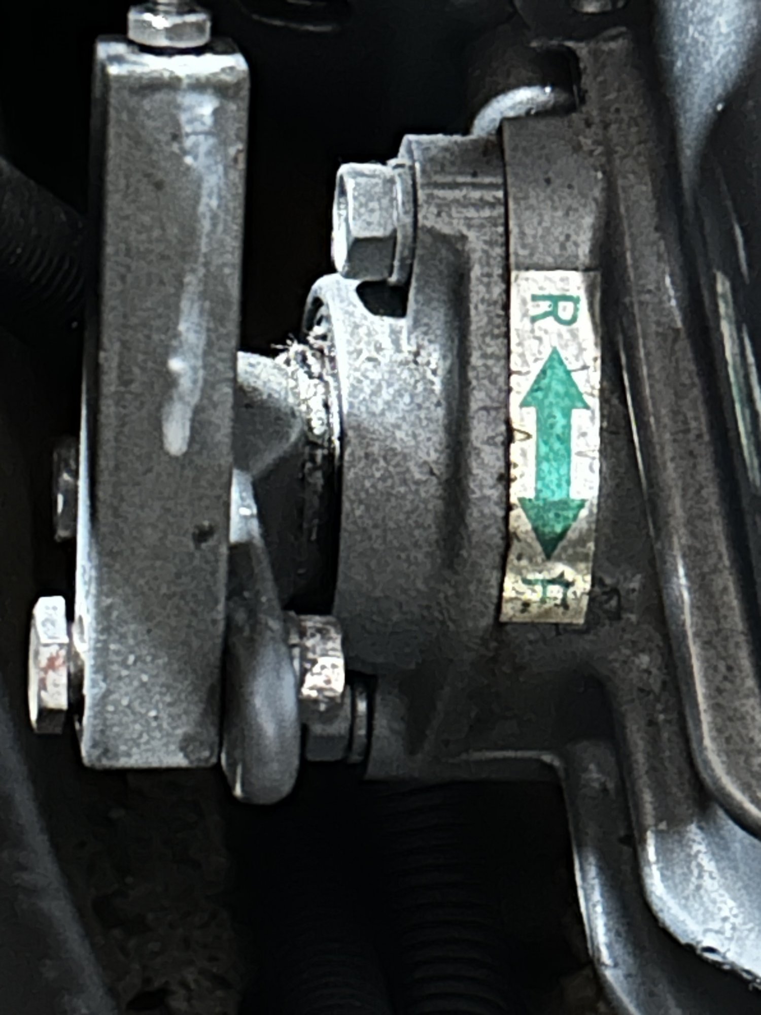

I took some photos of my Kanzaki KH2P Transmission shift assembly lever area you are asking about. I have no leaks of fluids in or around the area and see no signs of a weep hole you ask about as well. I know its not the same transmission as yours, mine is for a Yanmar 3GM30F but is shows how the assembly is attached. Sometimes it helps to see a picture as well as a reference point. Not the easiest of places to get a good photo, but you’ll see the matchup.IMG_1712.jpegIMG_1700.jpegIMG_1697.jpegIMG_1695.jpeg

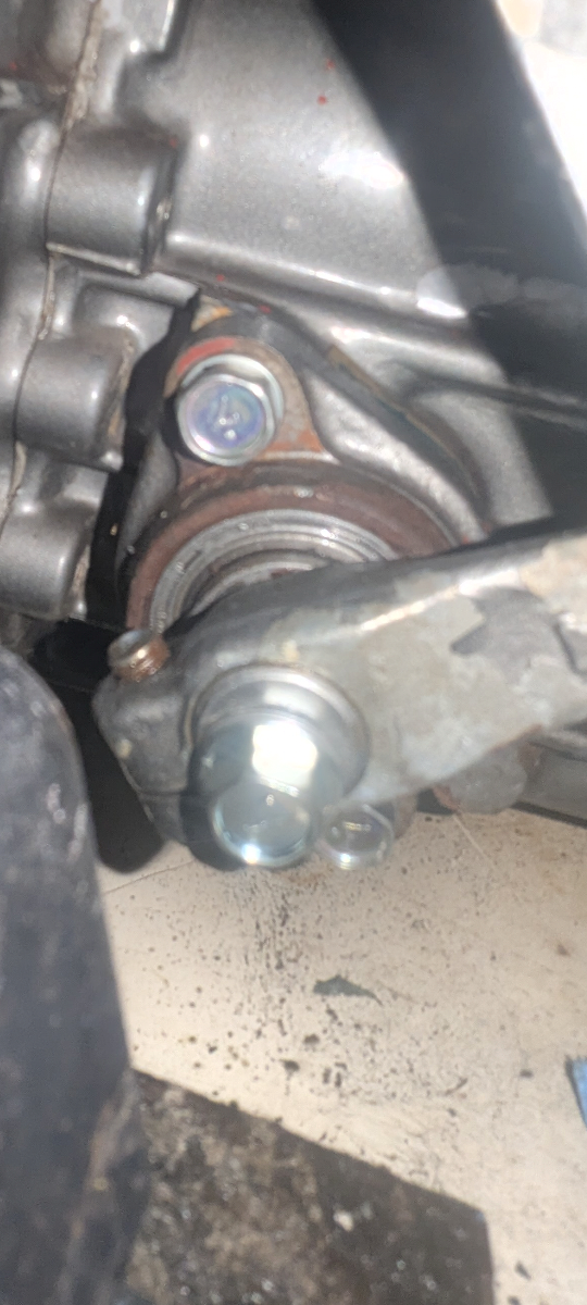

Hey everyone — it’s a great day out here, and I just wanted to share a small win. I’ve officially solved the transmission mystery!
I got in touch with a technician from East Coast Transmission, confirmed the missing parts with Yanmar, and ordered everything I needed through a Yanmar parts dealer. The whole order — just a couple of bolts and shims — ran me about $80 including freight, and I’ve gotta say: they fit like a glove.
Best part? No more transmission oil leak. That’s one big item off the checklist. Still plenty more to go, but this one feels really good to knock out.

I had a similar oil leak from the Kanzaki KM2P. The oil seal just inside the shift lever was leaking. While I had removed the shift lever, I replaced the oil seal and the "O" ring also shown in the illustration. The missing bolt you described is a "stop bolt" with shims. In a Yanmar service manual, there are details about measuring how many shims to use. It's not a difficult job depending on your access to the back of the engine. The seal and "O" ring weren't expensive either. Parts 14 and 3 are what you need.

Yes, the position of the shift lever on a KM2P is critical. I had created my own problem of the transmission not going into forward easily, seems the transmission didn't want to engage until I revved the engine. Then I learned that the forward and reverse positions of the shift lever should be 45° from neutral, but 45° is difficult to judge or measure when one is standing on one's head and the Yanmar is not level fore and aft to begin with. I resolved the issue by pushing the shift lever to reverse and then loosening the shift lever and pulling it back a few millimeters. Now the transmission engages in both directions correctly...
