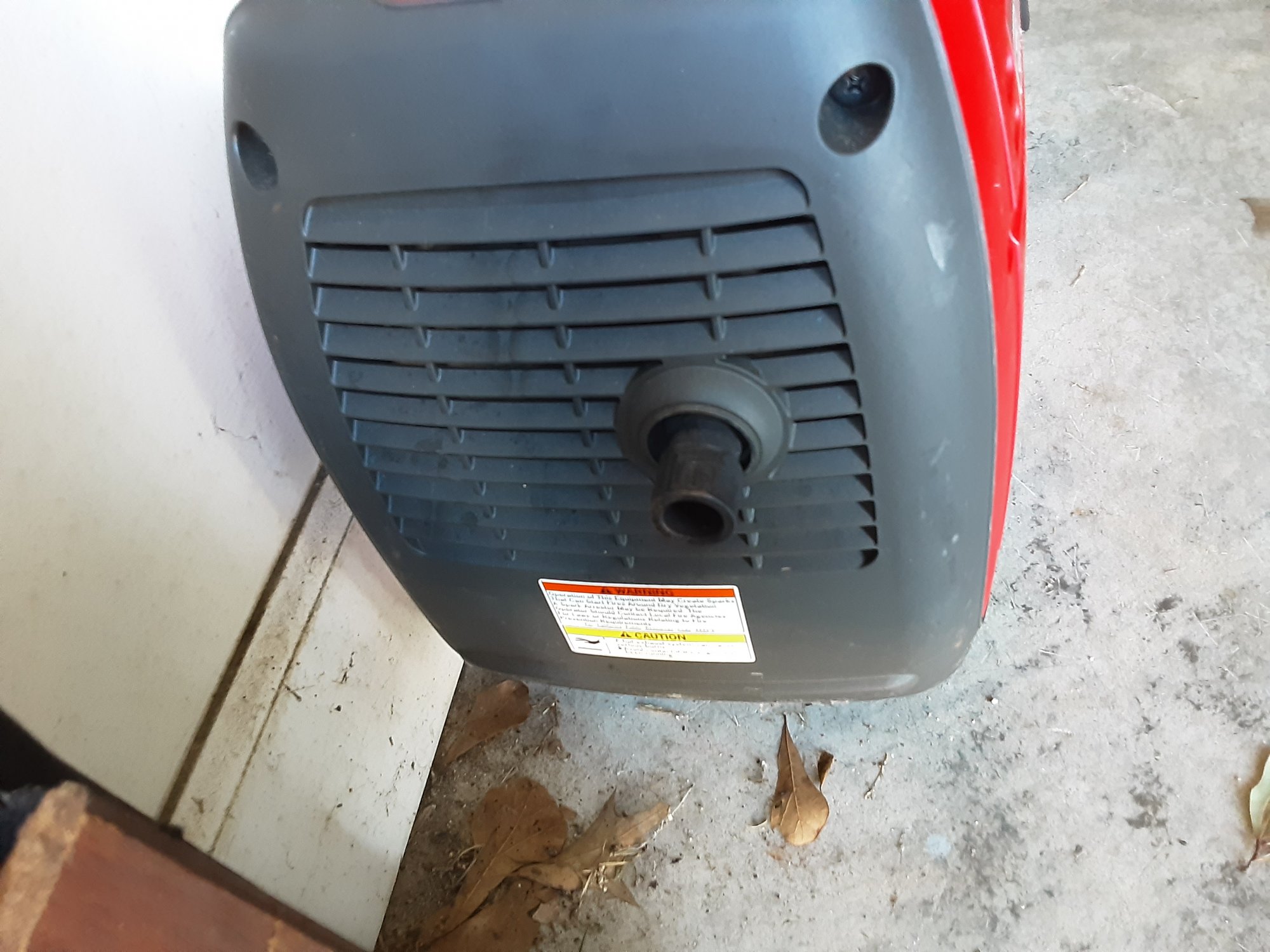

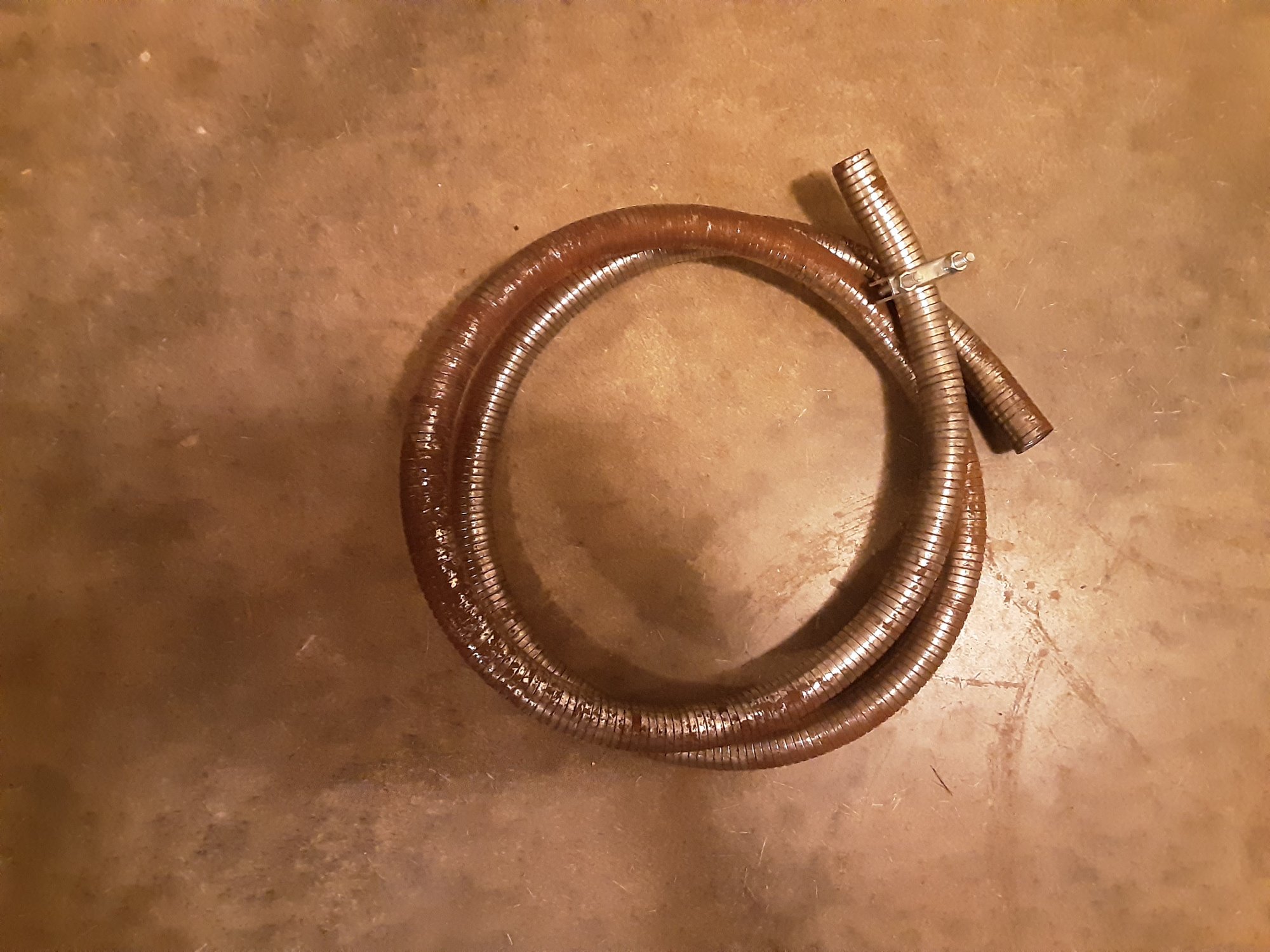

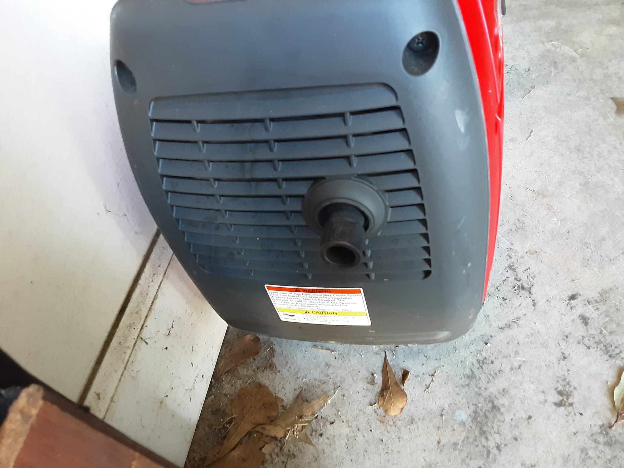

Regarding a Honda 2000 generator, you can buy an adapter and flexible steel hose "smokestack" for the generator. I had the fitting welded onto the exhaust outlet and can attach the long flexible smokestack to channel the exhaust wherever I want. Typically that is up in the air since CO is lighter than air. This combined with CO monitor in the cabin makes it less worrisome to run the genny either in the cockpit or up on deck. Of course only when we are on board and awake! Have a dometic smart start on the AC unit so the Honda will run my 16,000 BTU system. Snapped a couple quick pics of the generator adapter and attached.20200704_085931.jpg20200704_090549.jpg
