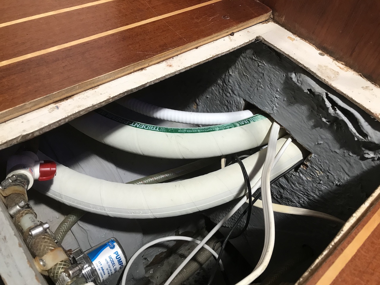

I just got my "new" boat back after a month of being in the yard -- during which time I stayed aboard my prior, now-for-sale boat which reminded me how fresh smelling a boat can be, particularly when it has exceedingly short sewage hose runs and no low spots.
Anyway, after all the fixes with the vent line, tank inspection port, and a (mostly) deep cleaning, the "new" boat stinks even worse than I remembered when I left it at the yard. Two nights ago I removed as many removable parts around the tank and hoses as I could, did a couple rounds of soaking, scrubbing, and spraying the bilges, hoses, tank and surrounding surfaces with diluted ammonia and baking soda, and then sprayed everything with a white vinegar solution (honestly not sure how I came up with this cleaning regimen).
Last night, after all that had dried out, the odor was still there. On my hands & knees sniffing around like a dog, all signs point to permeated hose(s). I'm going to get clean rags and do the rag test tonight. Mind you, this is 5 month old Trident 101 for the in/out, which was still wrapped in plastic when I walked it out of the chandlery, and it still had that new-hose rubber smell upon installation. Vent hose was also brand new Trident Vac XHD.
I know Peggie's book mentions hose as new as 3 months getting permeated, and with my luck, I won't be surprised if I got a bad batch of Trident. Still, really disheartening.

I personally would not use PVC. Peggie now recommends Raritan Saniflex hose which had been in use for over a decade with zero reported permeation issues. It’s also flexible so install is easy as opposed to the Trident. I would be looking at other sources of odor if the hose is new.
PVC is prone to vibration damage if mounted solidly to any part of the boat or allowed to contact anything hard. It can crack if something shifts on to it. It will most likely require several joints to conform to the shape you need, which introduces potential leak/failure points. In my opinion trying to measure, cut, glue and install a product designed to be straight is not any fun on a boat.
Hose, however, can be routed easily though bulkheads and along curved hulls with no need for support as vibration is not an issue. Hose will not be cracked by something shifting on to it.
Also in a pvc setup you will need hose anyhow at some tricky curve and/or at the ends (at minimum doubling the amount of hose to pipe connections) which begs the question why not just one length of hose?

Are you 100% certain you used Trident 101 Trident has several sanitation hoses...101 and 102 (identical except for color...101 is black, 102 has a white skin on it) have proven to be 100% resistant to odor permeation...but there's also 140 , which is better than 148 but not "bullet proof."
If you really did use 101/102, it's not the source of your odor. If you want some 0ne-on-one help to find the source, send me a PM and we'll find a mutually convenient day/approx time to actually TALK instead of type.

Okay, I admit I'm lazy and just call it 101 cuz everyone knows what that is! It's actually 102. The green stripe got smudged by the ammonia cleaning. I really don't want to believe it either, but it just failed the rag test, twice to be sure. I soaked some brand new microfiber cloths in warm water. Draped them over the bits of hose you see in the pic, which are the low spots in the system. One at a time. Was careful not to let the rags touch the hoses I wasn't testing.
The top hose is the 148 vent line, middle is the tank outflow, bottom is the inflow. I also rag tested the outflow hose higher up toward the deck fitting, well above the tank level, and it had no odor, just mild rubber smell like the inflow hose.
Peggie, sending a PM now.

If you didn't thoroughly clean and also treat with PureAyre according to directions, there's a good chance that the odor you picked up on the rag could be residual odor left from previous stinky hoses that's attached itself to the outside of the hose and every other surface in that area. And there's another possibility: the white "skin" on 102 can outgas a chemical odor when it's new. Really annoying but it does go away in a relatively short time.
All of which is the reason why I'll want a good description of the "character" of the odor you picked up on the rag....sharp/chemical, soft sewer-like or swampy...when we talk.
