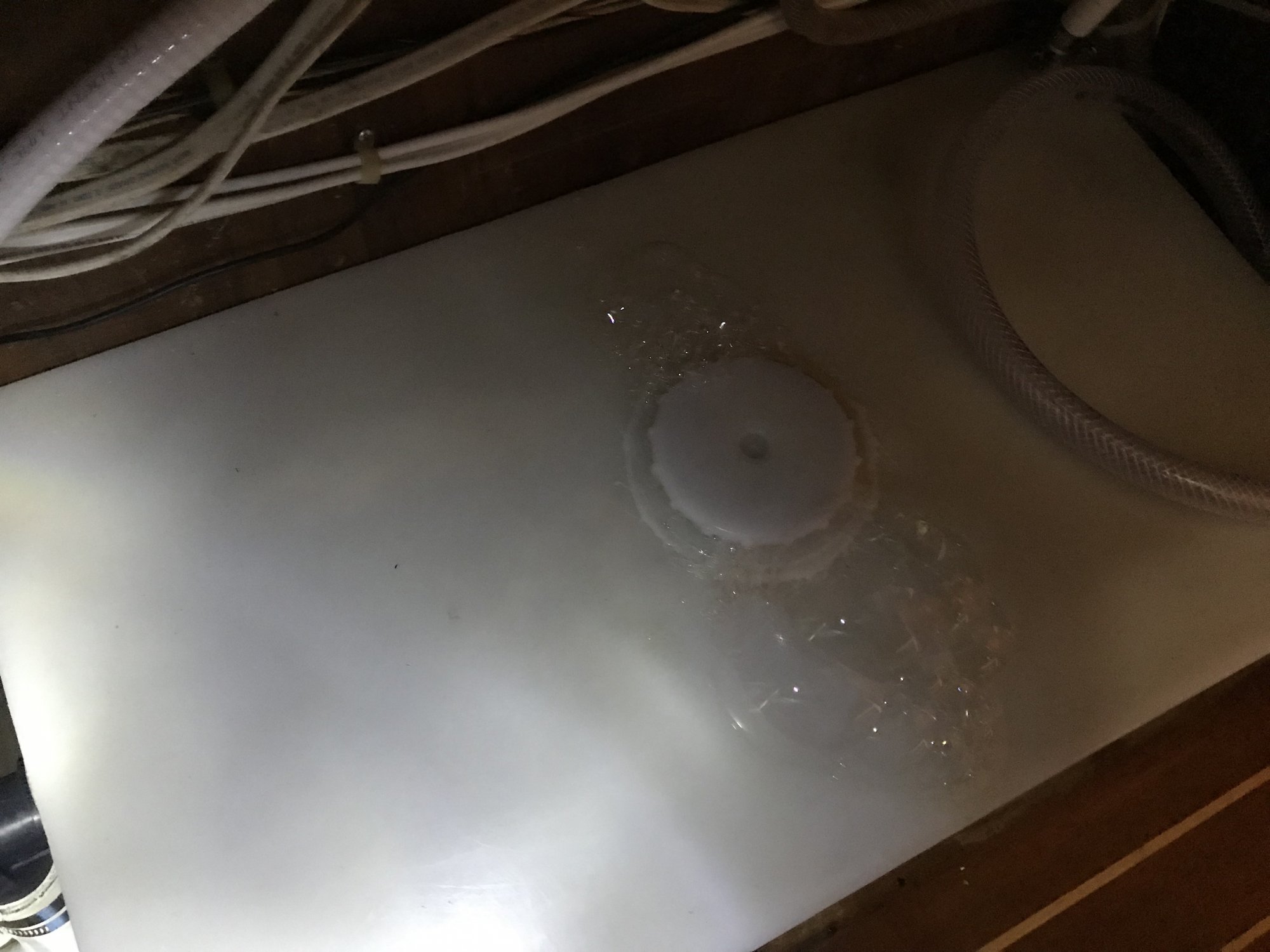

But here's an update: I went to pump out and do extra rinse cycles at the pumpout dock Saturday in hopes of starting a CP/KO regimen. While filling with water, I scrubbed the vent screen with a wire brush and doused it with soap to bubble-test it as continued water input led to air displacement. But instead, a quick burst of liquid released from the vent and then nothing more...no bubbles. Hmmm. Next I pumped out the water that was in there to try again, hoping maybe scrubbing the screen freed up some gunk that the suction will clear out.
I went below as the fresh water was filling it the second time. (I'm usually singlehanded so I admit I haven't gone below during pumouts before). I saw what you see in the photo. Bubbles courtesy of Dr. Bronner's, which was the closest thing I had to a detergent aboard at the time -- of course, Dr. B's is just vegetable oil, which I now know is exactly the wrong thing to use, thanks to the book. Hard to tell from the photo, but the tank was inflated more than I thought a "heavy duty" tank should be. That inspection port cover was as hand-tight as I could make it at the time of installation. Starting to regret that I was too impatient to wait on a custom tank when I did this project.
So my conclusions thus far:
1. Vent is blocked and gas is escaping through the inspection port.
2. Inspection port does not seal well, at least certainly not when the un-vented tank is distorted due to lack of venting.
3. Blockage could be at the tank end or in the hose, likely in the unavoidable (by design) hose sag due to overfilling or sailing with too much sewage in the tank in a sloppy sea state (common conditions here). I opened the inspection port (slowly!) to relieve pressure and, expecting to see fully liquified contents, saw a layer of nearly solid stuff, some of which may have found its way into the vent hose at some point and stayed there. I sprayed the hose inside the tank to break up some of this layer, but some remained after several rinse cycles, presumably since the outlet is at least 1/2" above the bottom of the tank. Not sure what to do about that...I intend to continue checking the tank contents as I vary tank management schemes to see what actually works for liquefaction. Odorlos was used in this last tank full, albeit without proper venting so I won't dismiss it yet.
4. Inlet, outlet, vent, and unused vent ports on the tank are well-sealed. I saw no leakage from those despite the tank appearing ready to explode. At least one positive came out of this.
If you knock the screen out of the vent thru-hull (screens created more problems than they prevent because they get clogged with dust , pollen and corrosion), you may not need to replace the thru-hull unless you want to upgrade to a larger diameter vent line (easy to do, thanks to a li'l gizmo called the Uniseal UNISEAL )
You can remove the vent line from the boat to flush it out if you want to, but I don't think that'll be necessary 'cuz 99% of vent line blockages are in two locations: the vent thru-hull and the other end of the vent line--both that end of the hose and the vent fitting on the tank, due to waste spilling into it when the boat is heeled.
Fabricate a wrench to close the inspection port with enough torque to ensure the gasket is really squeezed down. Add more thread tape.
Don' do dat! You'll damage the cap or the tank. Replace the gasket and o-ring instead. They're rubber...rubber dries out...so they need replacing every few years.

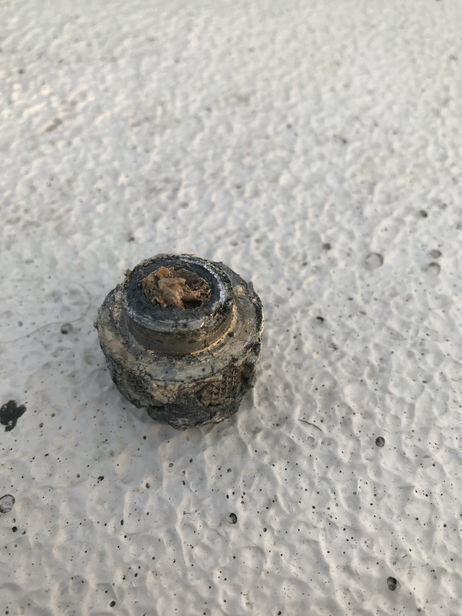

(1) The attached pic is what was left of the chrome vent fitting when I went to remove it. The part inside the hull decided to break easily when I went to back the nut off, but fortunately the exterior part was retrievable so we can all admire firsthand what a well-clogged cheap vent fitting looks like. It has since been replaced with a 5/8" mushroom fitting.
Interestingly, doing that still didn't allow the tank to vent properly. I had to remove the vent hose and empty it of the (clear) water that had collected in the sag. Kind of hard to believe that water was enough to make the tank continue to pressurize and bulge up, so maybe there was something else going on (stuff in the vent nipple on the tank, maybe, though I didn't notice it when I poked in there with a screwdriver to make sure).
Anyway, with a clear, albeit saggy, route for venting, the tank stopped inflating and the vent is now doing its job. So that's the venting update.
Unpleasant aromas persisted, though.
(2) 2nd remediation step: tighten things up. I wrenched down on the vent hose clamps, added more tape to the spare vent fitting plug, added more tape to the inspection port, and - I know, even though Peggie said not to - made a tool to help get the inspection port lid tight enough to ensure the o-ring is fully engaged (strap wrench didn't work on this lid shape).
After those steps, the aroma is way down, but not gone. I suspect the inspection lid and/or spare fitting were the odor escape points; both took a lot more thread tape to ensure a tight fit.
At this point I can live with things and I think we're on the road to recovery. I've only done one pump out, with many flushes and a heavy dose of Noflex, and am only 1/2 full at the moment, so it's too soon to tell for sure. Occasionally I get a brief whiff of something similar to what was most unpleasant before, but I frankly can't tell if it's just the Trident 101 which still has an industrial off-gassing odor after presumably months of sitting in its plastic wrapping on the chandlery shelf, or if the sinister smells remain. It may also be, despite much cleaning and PureAyre spray-downs, some lingering odor in a part of the bilge I can't easily treat thoroughly.
