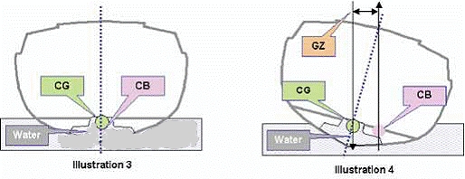

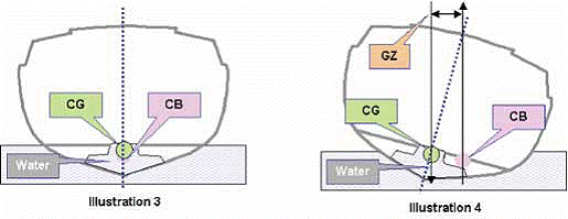

:banghead:For those who've made it this far in the thread and aren't beating their head against the wall, check this out: (ripped from http://kobernus.com/hunter260/water_ballast/water_ballast_paper2.html)
My argument is that the water "ballast" does nothing here to right the boat in illustration 4... it's only the hull of the boat (the air inside the hull), that's contributing to the righting force. CB shifts to the right, and represents the center of mass of the water displaced. Same thing happens in a centerboard dinghy; as she heels, more hull is pressed under water, displacing more water than when sitting upright. This newly displaced water is what's forcing the boat to right itself. You know, Archimedes principle, stability curves, all that jazz (http://marine.marsh-design.com/content/understanding-monohull-sailboat-stability-curves).
Illustration 4 shows a water ballasted hull with its tank below the water line. Now remove the water ballast and hull (tank) that surrounds it. She'd look like a catamaran, right? The righting moment would still be the same, with or without the water ballast. (We're neglecting the weight of the water tank walls here, so that the CG is the same in both examples.)
If water ballast beneath the surface added any righting force, we'd all have sailboats with hollow keels that get filled with water once launched. Make it a huge keel relative to the boat's displacement - 5,000 lbs of water? 10,000 lbs? It wouldn't matter. Except for the weight of the fiberglass (or whatever material) forming this keel (i.e. water tank), this water filled keel adds nothing to the force of keeping the boat upright. If it did, why do all these silly boat manufacturers keep insisting on making boats with lead keels? Water sure is a lot cheaper.....
Again, this is all valid until that huge keel is brought above the surface, like during a knockdown. Then you have a huge weight working in your favor. Once that water keel is submerged again, the boat of course will continue to right itself, but not any more so than if that keel wasn't there at all.

If you remove the water ballast, center of gravity moves up, righting moment (gz) decreases, so the water ballast does help right the boat. With a deeper, heavier lead keel, center of gravity moves down, righting moment increases even more. That's why a boat with a lower heavier keel would be less tender than the water ballasted boat.
Joe is saying, especially in the case of his illustration, that if you simply built your boat without the area of the water ballast tank on the inside, just open up the bottom so your cross sectional shape followed the outline of the tank without a bottom, you would get a shape reminiscent of a catamaran or a tunnel hull. In that case, joe is right, the righting moment wouldn't be any different.
However, ballast tanks don't run the length of a boat, normally, and to remove the boat bottom just where the ballast tank was, would cause issues like drag and cavitation (the capturing of cavities of air) from wave action and heeling. You could design the area with the bottom but to fill automatically with thru-hulls and an air escape at the top. It would be essentially the same as water ballast tanks, only you wouldn't be able to empty it for faster down wind sailing.

Now wait a minute, I'm not sure I'm buying that. He's then going on to say since the water ballast is under the water it isn't doing anything and proof is if you cut out the ballast tank and ballast the righting moment is the same? Not an apples to apples comparison, the way I see it.
Thinking of it another way, if you added ballast below the water line in the form of lead, wood, or gold bullion, for that matter, and it weighed the same as your ballast tank of water, are you then saying ballast of lead below the water line makes no difference in righting moment because it's under the water, and if you cut out the ballast and the hull form it sat in, it would make no difference? Weight is weight whether it's an equivalent amount of water or lead. Show me the light :)

You are right, of course, but I think your are not seeing his point. The heeling force pushes the boat forward and downward to the lee side. This increases displacement (volume of water) and that means more weight (downward force) is countered by the increased buoyant force of more hull volume. The real issue is where that buoyant force is centered. As you heel, the center of buoyancy moves leeward and counters the heeling force. To heel more, the heeling force needs to increase, which, for most designs, moves the center of buoyancy out even more and increases the buoyant force until the rail is actually underwater. The more round your bilge is (like a log) the less the CB will move to counter the heeling force. Flat bottoms are the best. High topsides are great too. The most stable form is actually a half log. A half round shape will always roll over until the flat face is down. This is in the case of evenly distributed density across the cross section. The CG is closest to the flat surface and the center of buoyancy moves the farthest out from center as it tips. Note how full designs have changed in the last couple of decades. Bottoms are being flatter and flatter. Like a surf board.

My point is that with ballast tanks filled with water, which equal the density of the surrounding medium, don't serve to keep the boat upright. Again, make a keel filled with 10,000 lbs of water, and attach it to a dinghy. Would it be instantly pulled to Davy Jones' locker? What if the keel was filled with 10,000 lbs of lead?
